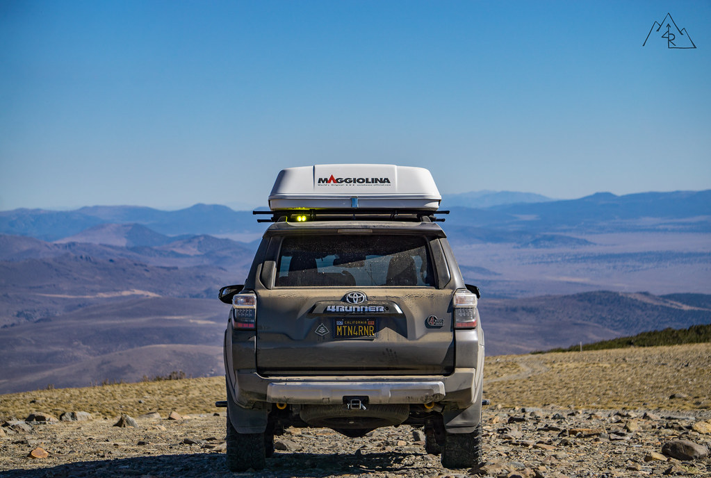

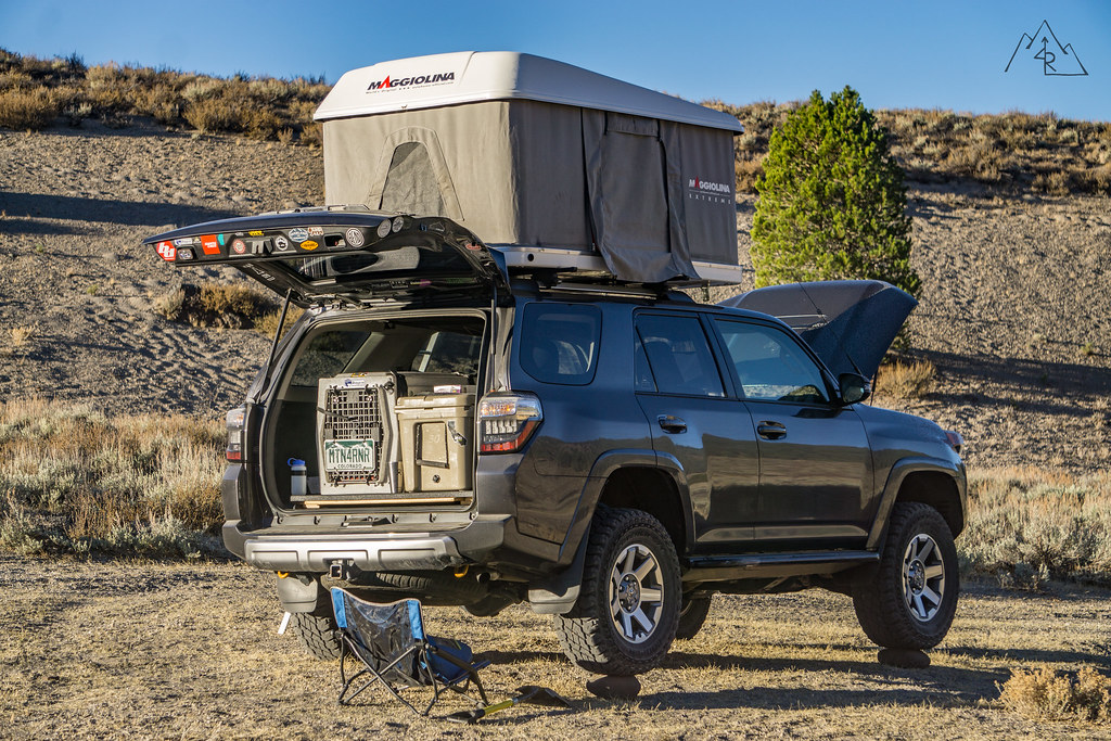

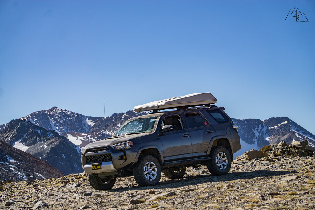

I have spent the last few years of exploring spending nights either in the 4Runner when I am solo, or in our REI Half Dome 2+ when I am with my lady. I knew that a roof top tent would be somewhere in the future plans, but I also knew that it would be a ways off on the build list. A few weeks ago, I had a great opportunity to pick up a used AutoHome Maggiolina Extreme that I couldn't pass up. It's a size small, so it fits well on the roof of the rig being attached to my existing Thule rack. I have plans to upgrade the rack to take advantage of what space I have left for my single Rotopax and if I can, my Stihl. But for now, I am sitting (laying) high and happy. The tent makes little to no noise up there and hasn't really affected my milage. The KDSS system really keeps the additional 150 pounds on the roof in check and I don't notice any more body roll than before on mountain roads. After a BONE CHILLING first night in the tent, a new bag is on order to take advantage of the space and the ability to leave it in place in the tent between campsites.
Looking forward to many nights in it! More to come!

Now, only thing left to make it perfect is a fridge. Such a great tent! no more pitching tents on the ground! :bravo:​

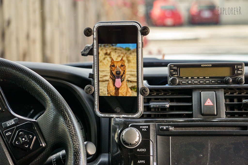

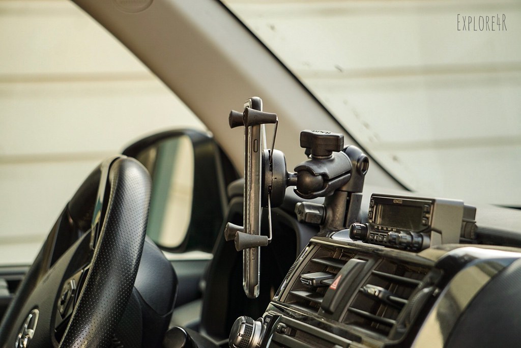

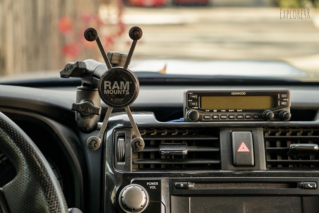

I added a more secure mount for the phone this weekend using the RAM X-Grip, a dual pivot arm and a female threaded ball mount. I removed the radio/trim center piece and secured the ball with a flange nut on the inside of the trim. So far the vibration has been minimal, and nothing more than I would expect considering typical road conditions. I have another idea for a sturdier mount that will happen in the future, but I am starting with this!

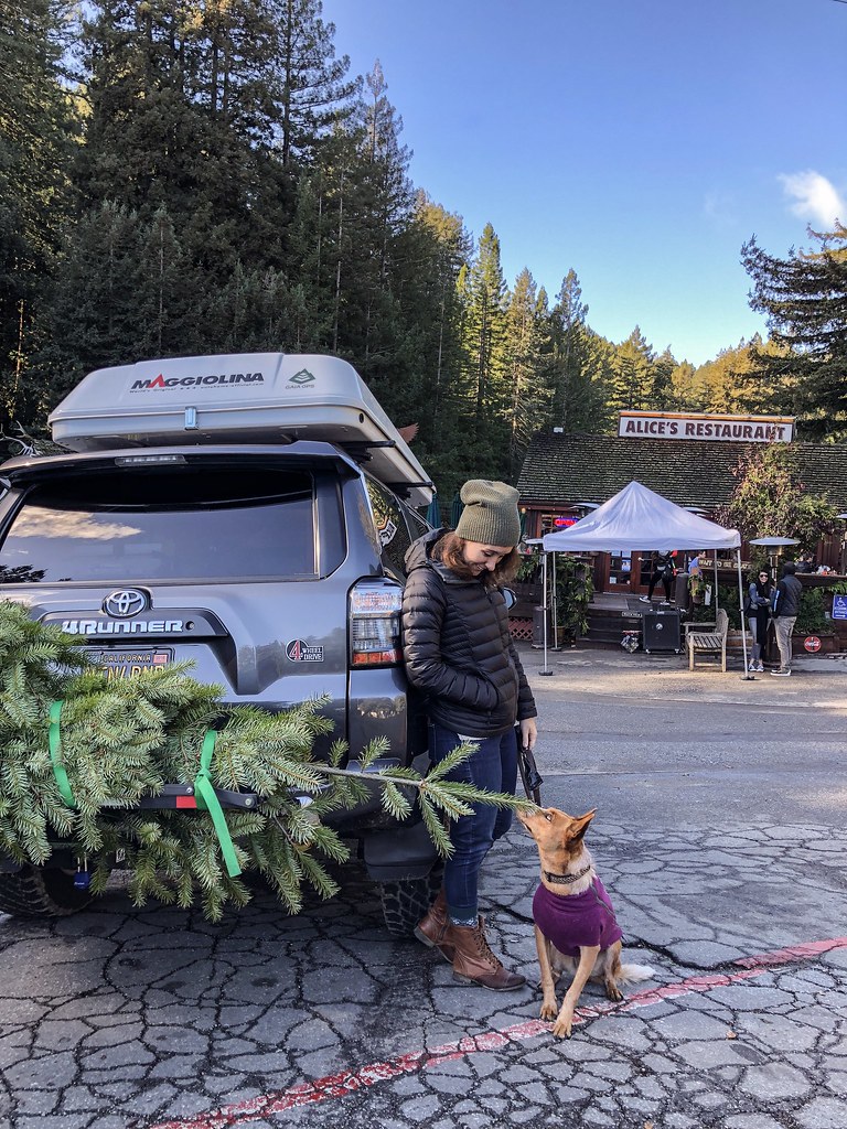

Also, Happy Holidays to you all! No Christmas Tree run to the National Forest this year, but I did make good use of the bike rack carrying the tree home :thumb3:

Nice use of the 1up Max! Do you have any installation photos of that what the female RAM ball threads onto?
RAM mount part number (RAM-B-273-M6U) attached to the trim piece with a flange bolt from the inside and thread locker to make sure it stays snug. I can tighten it from the outside without removing the trim because the flange bolt has notches on it. So far the vibration is acceptable. But time will tell off-road what it will be like. I already have a plan for RAM phone mount 2.0 that is much much sturdier that might happen at the beginning of the year.
Hope this helps! Ask away if you have other questions.
