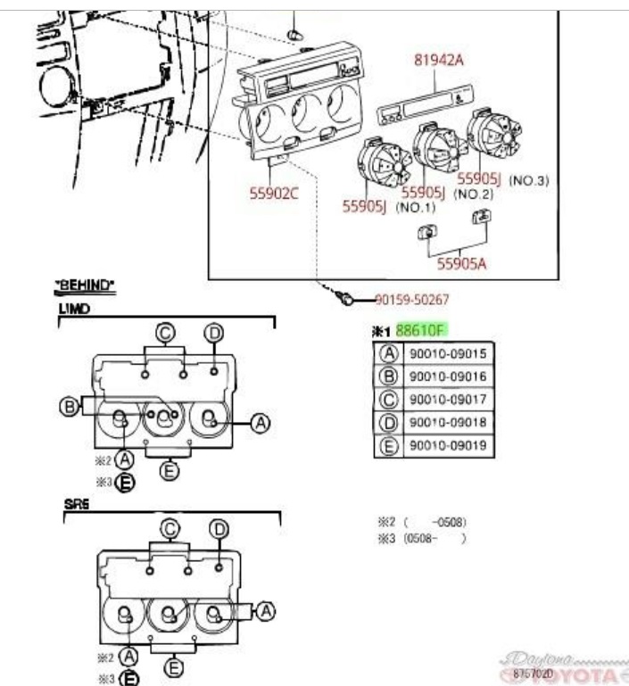

I just got a 4runner and the bulb was out. I did a search and found it. Didn't have to make a new thread. Even if it was stickied, people would still make new threads
Pic is from another member, don't remember who but thank you, bulb colors are sometimes a little rubber piece over bulb.
One schematic is for limited the lower is for SR5. Part number for bulb is in box to right.
$ 3.37 This is just one of 5 types, count the number you will need from your diagram (SR5 or Limited), diagram is looking at backside of A/C control panel. Bulb - Toyota (90010-09015) | OEM Parts

I did this recently, it's one screw to remove the button panel, and 10 minutes to change the bulbs. 20 minute job if you take your time. Used OEM bulbs ordered from the Toyota online parts catalog.
