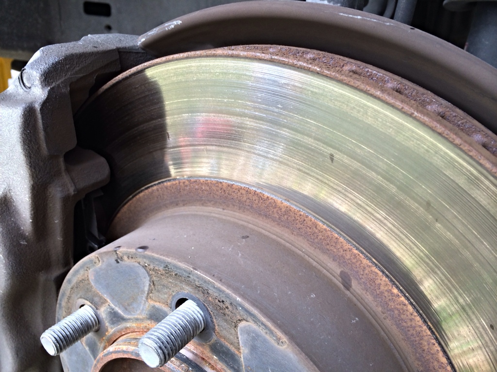

Everything seems to be working, so no major projects in the way before the fun begins. The front driver rotor is warped, so I'll swap that. Read somewhere else this might be common on 4Runners.

I need to tackle the issue of this rotor. Like I said, it's the driver front. The brake pads were replaced with right before I bought the car, so maybe this is just evidence of a nasty old brake pad scraping the rotor. I'm going to start with a little bit of research, and then probably one new rotor upfront here to see if that helps.
Passenger front for comparison:
