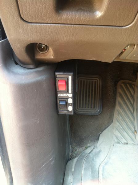

Here is the switch. Mounted conveniently just below the dash, left side. The awesome thing about this system is that you can switch back to gas ON THE FLY, and if anything happens to the electrical components, it automatically switches back to gas and you roll on...

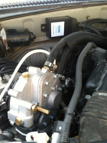

Here are the 'GUTS' of the system, the Emulator, the regulator, and if you can see a small silver thumb screw with a red mark on it (that adjusts the fuel flow, which essentially adjusts your fuel usage). One really cool thing is that you can make slight adjustments to the fuel usage to compensate for fuel mileage or power needs, that is done by the thumb screw.
A couple reasons I didn't want to do it myself, I don't really like to play with gas much (something goes wrong, and there is not much you can do about it...), the guy who installs this system, does them at least three times a week and it still takes him the better part of a day (he does get a lot of distractions from people who want his attention), I trust that. Finally, it gave us some time to do some things that are MUCH more enjoyable...
