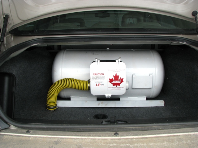

This was a very bad install. The gas lines and the valves need to be encased in tubing and vented to the outside.
Our LP here in the states has mercapins in it to make it smell like garlic if there was a leak while where your at, they might not and if a leak were to develop, you wouldn't know it until it exploded.
Notice how the valve and the lines are inside a tube and an access box. If a leak were to develop, instead filling the car up with vapor, it is routed outside.

So here's the tank...
Nice conversion option but I have to ask: is the fill port on the tank (right side, red) or external?
Have to agree with Singtoe. There is a reason why there are regulations on the method of installation, especially for an interior tank. Propane/butane is heavier than air and will sink to the low spot in a vehicle.
