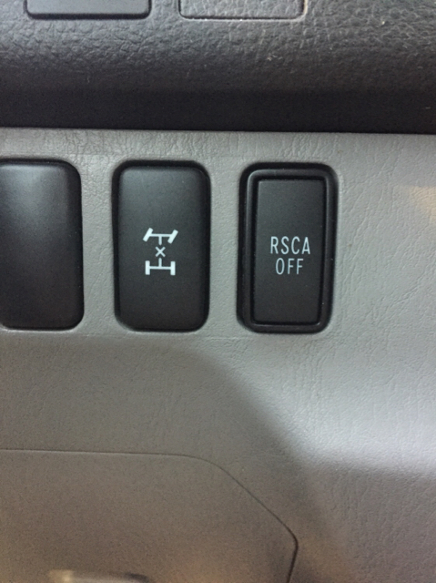

So my 4x4 buttons plus downhill assist button don't seem to light up when I turn headlights on. Everything else is fine. I don't actually remember if these buttons ever lite up or not.
Is there a particular fuse that just goes to these buttons or do the buttons need to be replaced?
