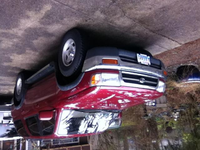

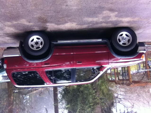

So i went up to see that red one, it's in immaculate condition, like jeez it's super clean. It was a one owner from 1997-2012, guy bought it for a temporary car and had it for 4 months. He was a really nice, honest guy. He sold his other car for $15k cash, bought this and then put the rest into a house loan, after he got the loan he got a new car and didn't need the 4runner anymore. So the inside is super clean and the body is straight as an arrow. There's a few minor scratches that will buff out.
IMPORTANTLY: I'm now a proud owner of a 1997 4Runner!!!
some specs:
5-speed
3.4L (obviously)
Factory e-locker
Sunroof :thumb:
and the other normal stuff
Also never really been off-roaded seriously, underside is rust free and the 4wd works well, including the locker.

Yeah, she's sitting infront of my apt right now at WSU. Talked him down to $5500 from the original $6400. I feel really happy with the purchase. A HUGE HUGE HUGE improvement over the 3.0 in my 2nd gen. This truck pulls uphill with no problem, even in 5th gear. The entire interior is immaculate, minus a few cargo area scruffs on the sides (the things over 10 years old, not going to be perfect) Even with 233k on the clock it seems to run really well. I'm happy with it, though i think one of the tires is a bit out of balance :/ and for some reason my cruise control decided to stop working halfway home (300 mile trip) light comes on, but won't set/resume or anything. thoughts?
