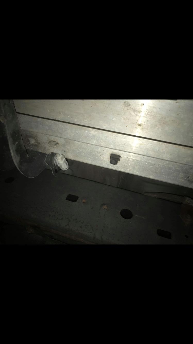

Any tips on 4th gen buyers guides? I have found a decent one about 2 hours away, two previous owners, 140k, has had some front end damage but no deployed air bags or frame damage clean title. The carfax records show normal oil and tire rotation with the below service done, as well as two recalls. It is northern Kentucky/IL do asked for pic undernearth to show any rust or not. Any tips or suggestions on points of interest would be great as I am checking it out Saturday.

From the very few photos of the chassis/frame the rust look to be a non issue, check all the frame for heavy rust, BUT the places to look very carefully for rust would be the radiator support, if it's rusted badly it can be replaced at a cost but also check the tubing attached behind the support for the same bad rust issues, another trouble area is the top of the frame in the front right/passenger wheel well back near the firewall, this is where the AC condensation drips onto the top of the frame.

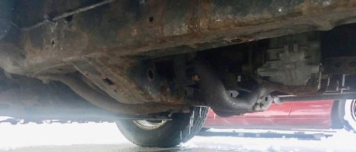

Found one 4 hours away and dealer promises no rust. 105k miles and already had a Toyota tech inspection. Going Saturday to purchase more than likely. Going to offer 12.5k. Thoughts?
Pics below of the under carriage, looks like just some surface rust. Only has 105k which I’m amazed. Thoughts from anyone would be greatly appreciated

Wow! 45k miles but that price tag!

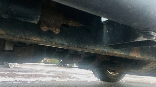

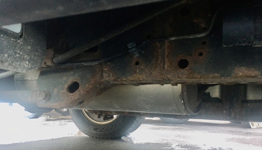

Looking for the collective wisdom of the group. Looking (remotely thus far) as an 08 V6 Sport just under 150k miles. Carfax/dealer records look mostly good (a gap the last 15k miles under a new owner, not surprising). Dealer took a few on-ground underbody photos for me - to me the rust looks superficial, but would like more experienced eyes to look at it. I will of course do a personal inspection and then a PPI at a nearby Toyota dealer.

Looks decent but hard to tell how serious the rust is. The best advice I can offer you is to be patient. I looked for about 6 months before I found what I was looking for. Once you find the right one be ready to move fast. The clean trucks tend to sell fast.
