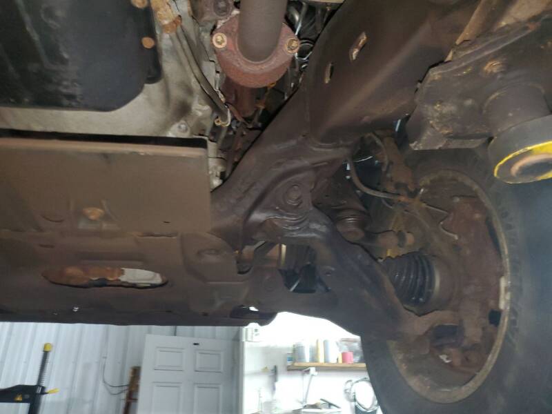

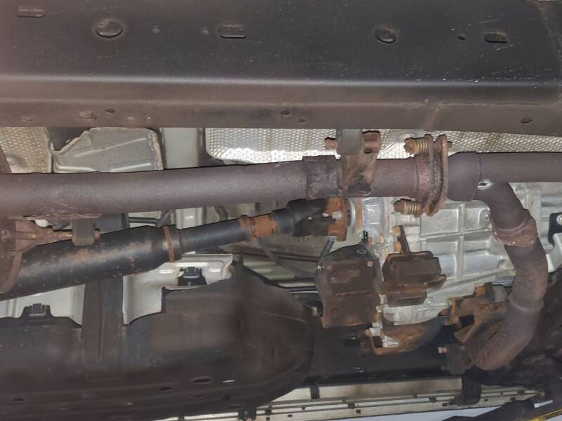

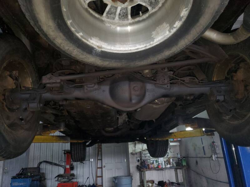

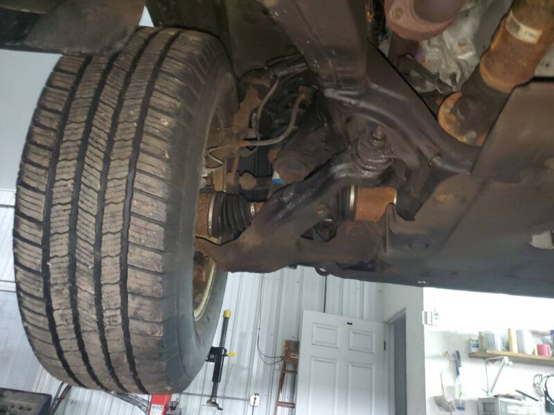

Here is a different one for comment: an 06 SR5 from a less rust-prone area of the NE US. V6, 129k miles. No XREAS to worry about. Dealer just added underbody photos. Looks like someone applied a quick rust-eater coat, but underlying that looks better than the 08 in my prior post. Dealer states that AC drain area is not impacted.

That looks much better, no crusty rust. Rust eater doesn't remove the crusty rust the other one had, that looks pretty nice. 129k miles that looks pretty good. V6 didn't need the SAIP bypass like the V8.

I'd grab it after I drove it and it's smooth. 129k miles with a clean frame you can't ask for more. Brakes I wouldn't worry about. Little known fact, you have to do this thing called "bedding in disc brakes". Bedding In Brake Rotors
You can slap in new rotors and pads over and over but if you don't bed them in properly you'll have the same problems over and over.
Looks pretty good rust wise to me, appears to have been oiled. Looks like there's some leakage where the 2 exhaust pipes are welded together and the flange near there isn't great but not easy to tell in the pics. As for the calipers, they are 4 piston and have a tendency to freeze up at times. Some swap in 5th gen calipers but those seem to have the same issue to less of a degree. Thank the crap they dump on the roads. It seems coated calipers may help, I put those on mine over a year and a half ago...time will tell but at least rebuilt units are not super costly.

Pronounced good by Toyota mechanic - very clean frame. A few things to address: rear shock leaking (will go with KYB Excel-G from Rock Auto), torn CV boot on RF (LF axle was changed 20k ago). Tires down to 3/32. And a few minor things. Now to go try it our ourselves. Impressed with comprehensiveness of inspection (AT, diff and transfer fluids checked, batt tested, even AC drain tube ...)

Test drive was great but the reality became clear that the 4runner was a bit too small (especially back seats vs. grown sons). So if anyone is interested in a 06 SR5 with a clean frame in Upstate NY, I can forward you the dealer info.
