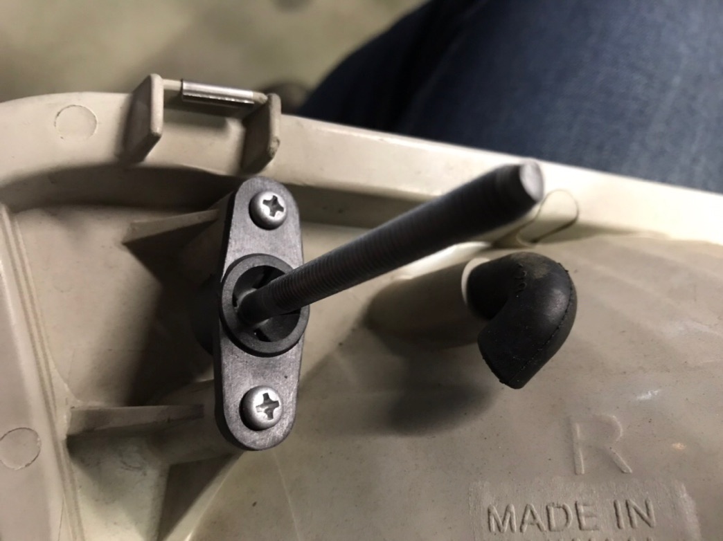

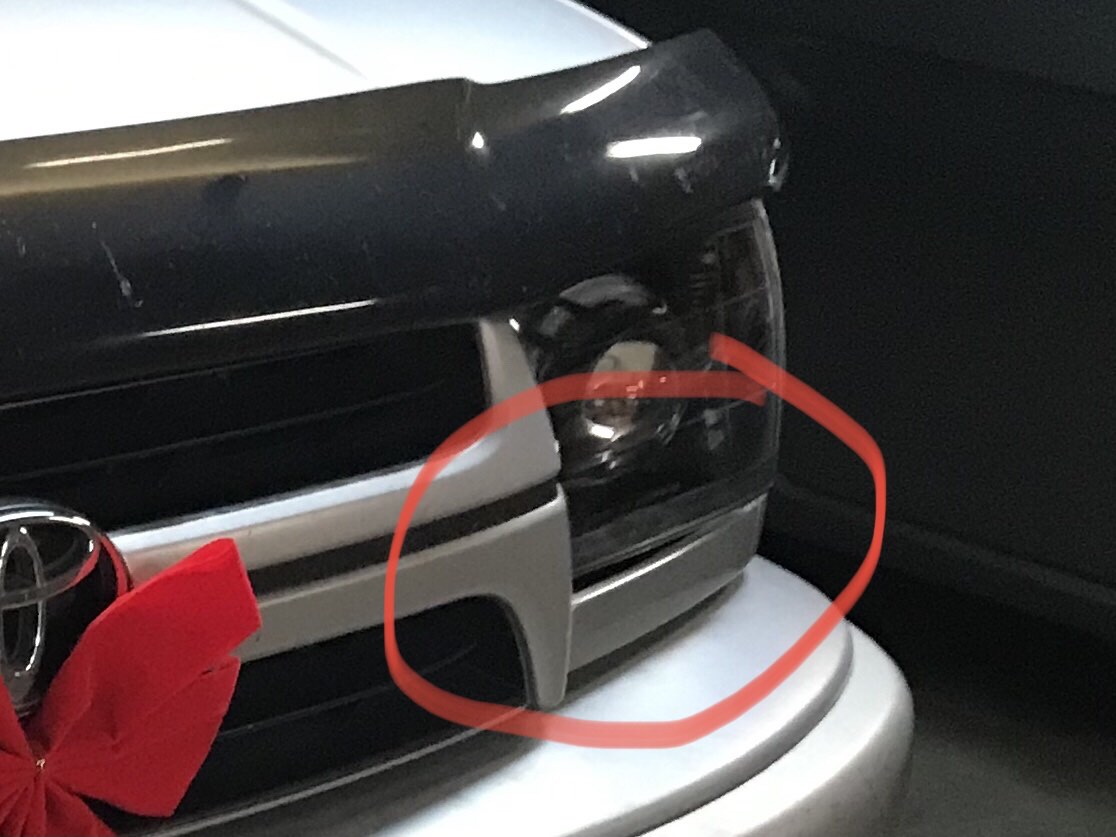

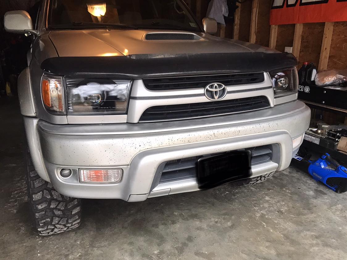

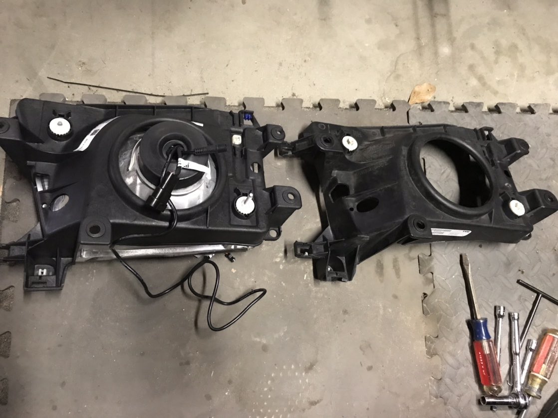

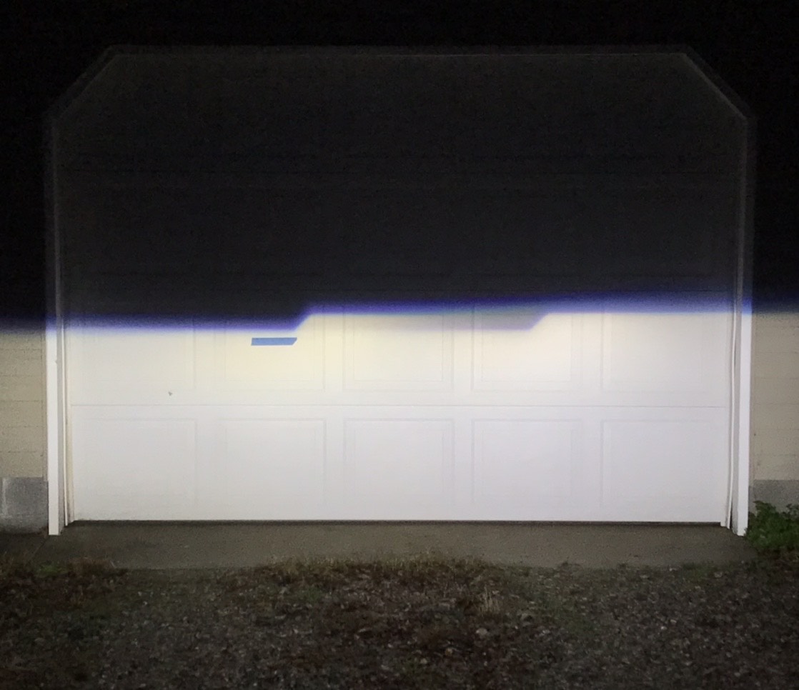

When I first got them in I couldn't get them adjusted right at all and they were literally loose within the backing frames. I changed out the hardware and frames from my old TYC lights and found them to be much better. Was this required? No, I don't think so, but I knew they would be solid and I had them, so I did it. Mainly, I think the spring in the frames they sent were too long. Once you horizontally align them to where they should be it should have tension on the springs so this may have been my issue but at first, they were floppy and loose.
I also think the adjuster style of the TYCs is far superior so that motivated me to swap everything.
I had to rotate both the projectors within the housing and the drivers side is still not perfect but it is hitting some stop of some sort and I can't get it to rotate any further. I'm happy with where it is.
Overall after a few days of tinkering and messing around, I'm extremely happy with them. I was pretty aggravated for awhile but I am happy now that everything is good.
Now I just wait for the halo controller and the corner lights. In the mean time I just ordered some black corners that were readily available off eBay...

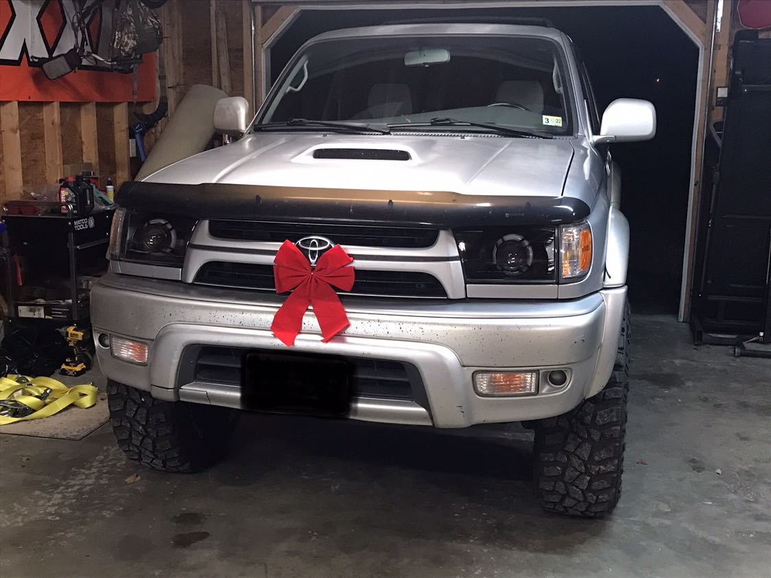

I didnt get anything crazy I don't really go for halos or RGB crap. I just wanted clean retrofits - and these do not disappoint.
The cutoff line is so crisp that I have not been able to get a completely seamless line between both sides, but its pretty damn close.
I found that I had to use vice grips and gently move the entire bulb assembly versus the adjustment screws to really level them out and then was able to use the adjustment screws for the height of the cutoff lines.
If you haven't already - cut the DRL wire so that they're not on all the time.
