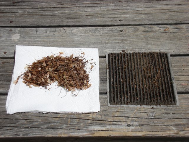

This was mine shortly after purchase last year. Apparently, no one had ever checked it before. :doh:
I'm sure glad there wasn't anything worse in there!

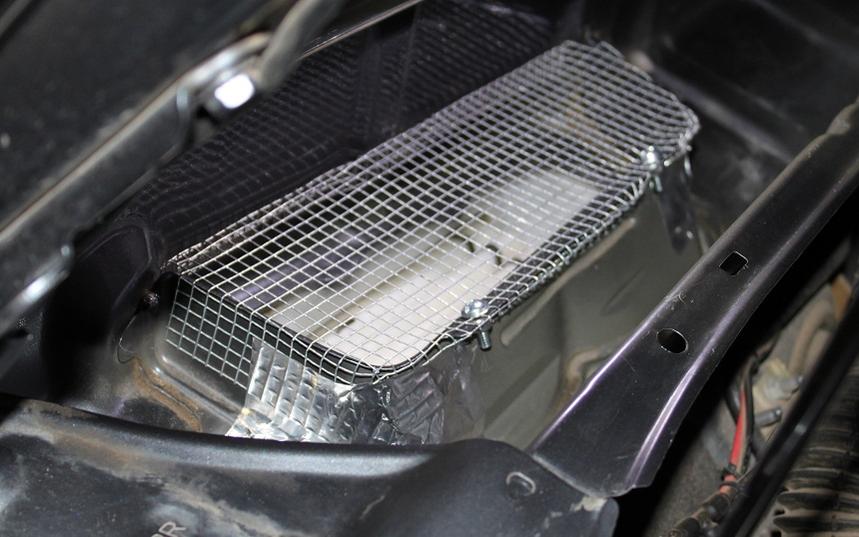

Late response, but I just pulled my cabin air filter out, and it had a big woolly nest above it and some fell into the fan. So I'm thinking that hardware cloth above the filter might not help much unless there's a way to attach it above the filter so you could vacuum it out after the filter is removed.
You need to install a cabin air intake screen. The critters are getting into the filter area via the air inlet on the passenger side. Remove your wipers and the black plastic cowl at the base of the windshield and you'll plainly see the air intake. Good Luck!

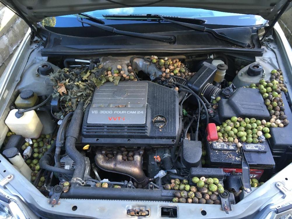

Timely thread. My 05 V8 SR5 wouldn't start and I had it flatbedded to my local mechanic. To make a long story short he got a serious infection and was hospitalized for almost a month. The truck sat outside at his shop and I finally had it flatbedded to the dealer who replaced the ECM. It runs great now but when I got it back and turned on the fan I got hit with a shower of stench and fuzz. I pulled the glovebox and on top of the cabin filter was a wad of chewed hood insulation the size of a soccer ball. There were also about 20 acorns bouncing around the fan. All's good now until Minnie needs a new bungalow.

The little beggars get into the cabin through the fresh air intake, under the wiper cowl on the passenger side. It is fairly simple to remove the cowl, and fashion a screen cover out of mechanics cloth (1/4" square stainless screening). I made my first one over 30 years ago to solve this problem in Honda's. I call it my chipmunk mod. It works well. No more nests on top of the cabin air filter since.

Check inside the engine air filter as well. They get into it and make a nice home. Had them also nest inside the frame!
