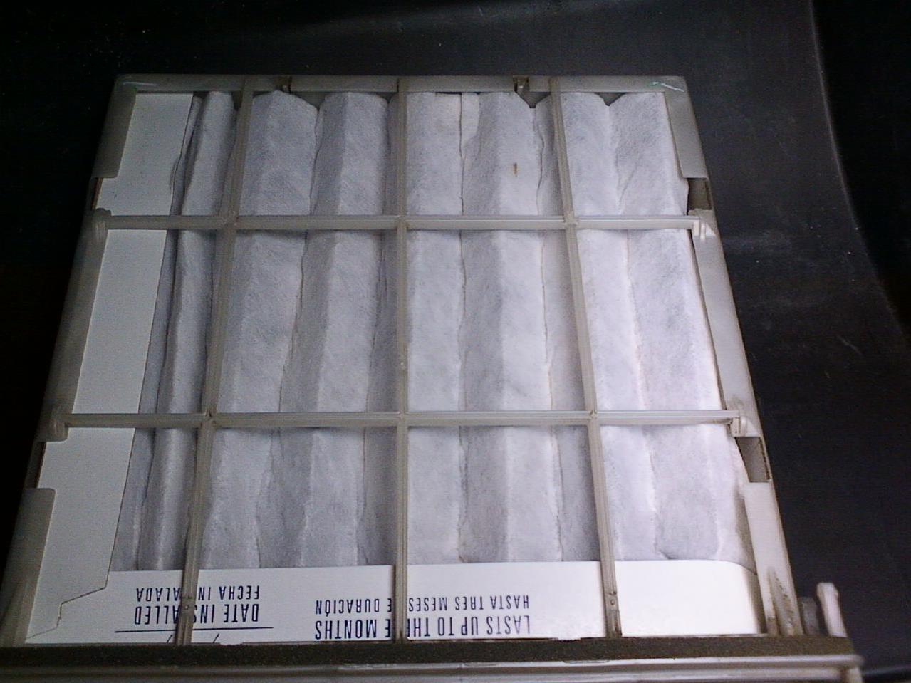

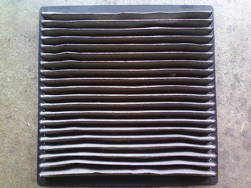

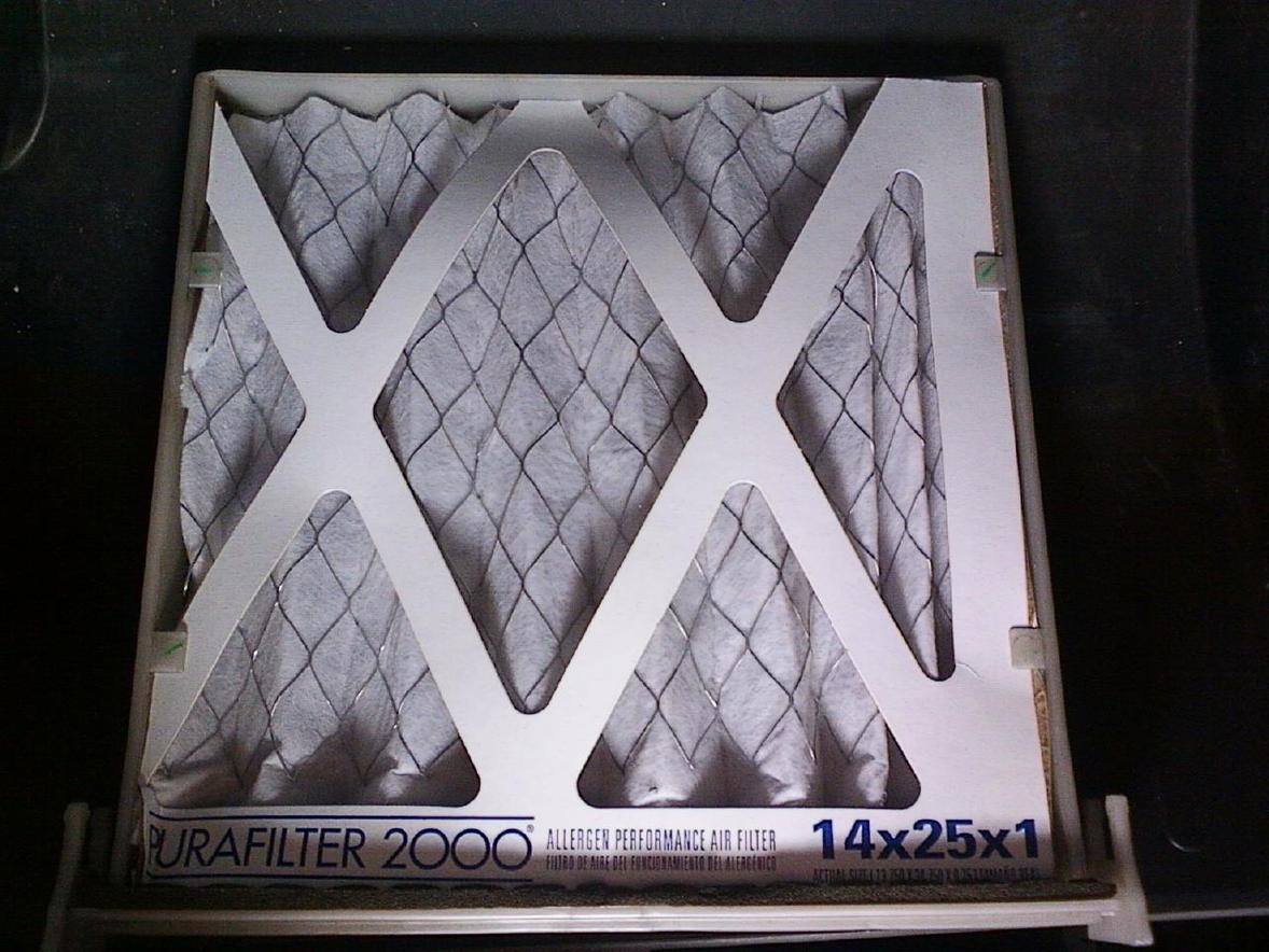

So again, I got bored today and figured I would change out the cabin filter. Instead of paying over 20 bucks for a new one, I took a new filter for my house heater and made me one. So for a low .50 I now have replaced my cabin filter. It's been about 6 months since it was done last. I am now at 91,000 miles on the 04.

I do the same thing. By the pics, it looks like the filter is in upside down, with respect to air flow.

Instead of $20 for an OEM Cabin Filter...you can get (4) for $20 from making it yourself w/ a 3M Furnace Filter.
