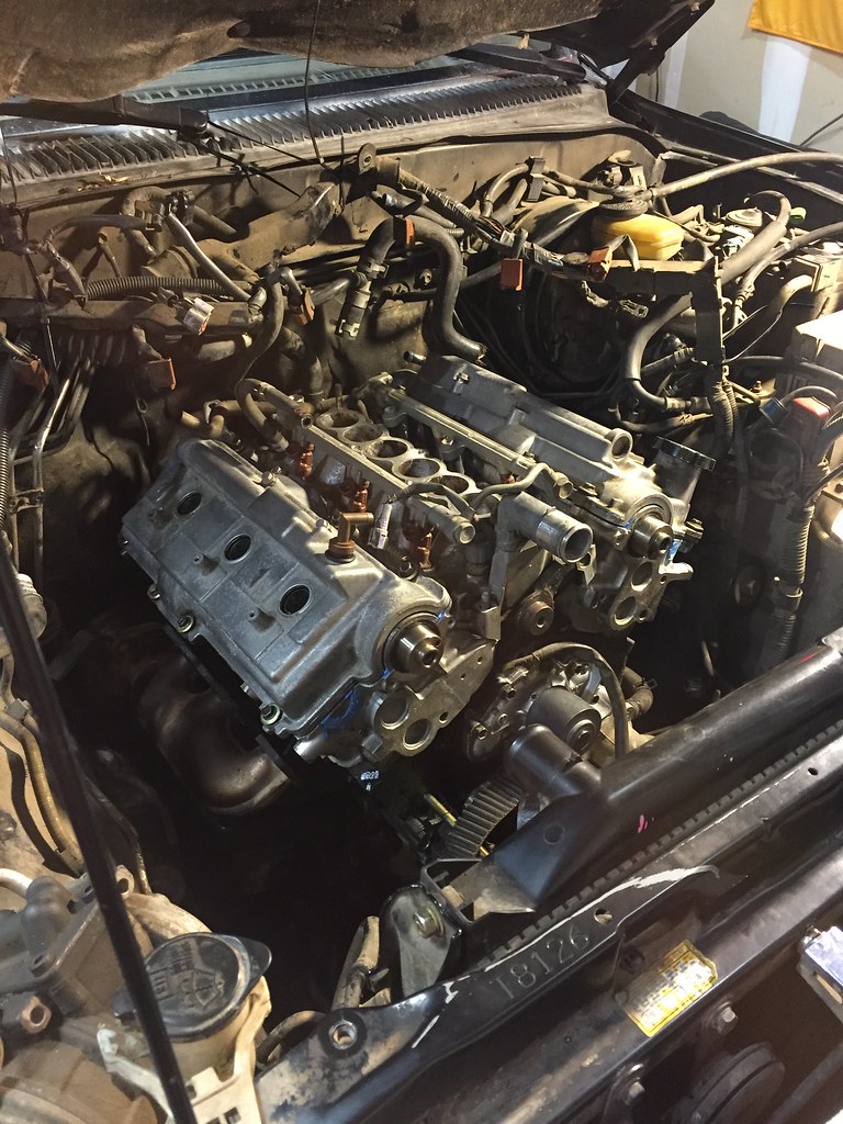

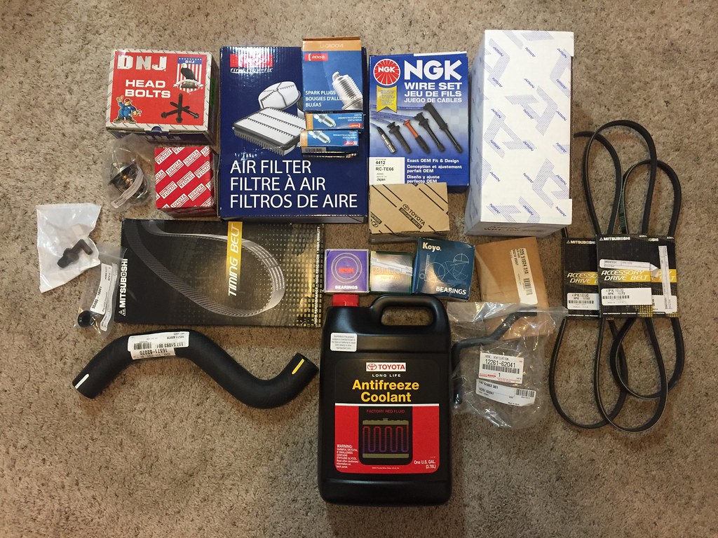

The first thing to do was get down and dirty and get that head gasket changed out. I am lucky in the fact that I work at an Import Parts Shop in town and get a substantial discount on parts. Because of this I went with all OEM or OES parts.
I just watched a DIY on youtube as I did the work. Worked out great.

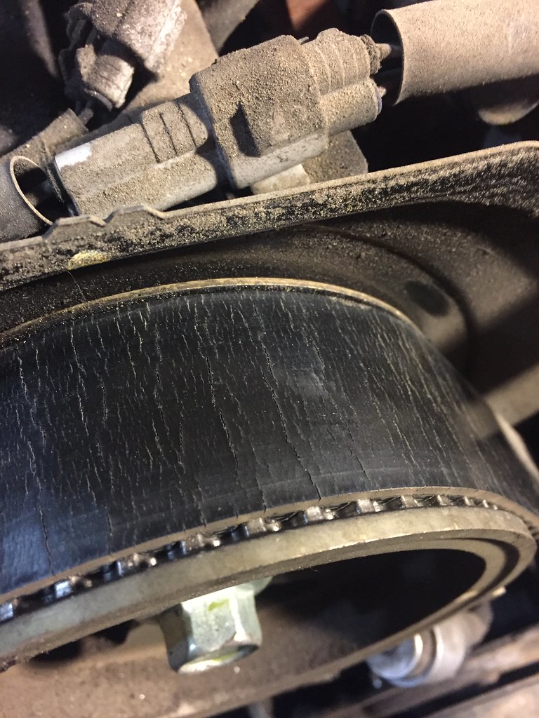

Timing Belt was ready to be done for sure.

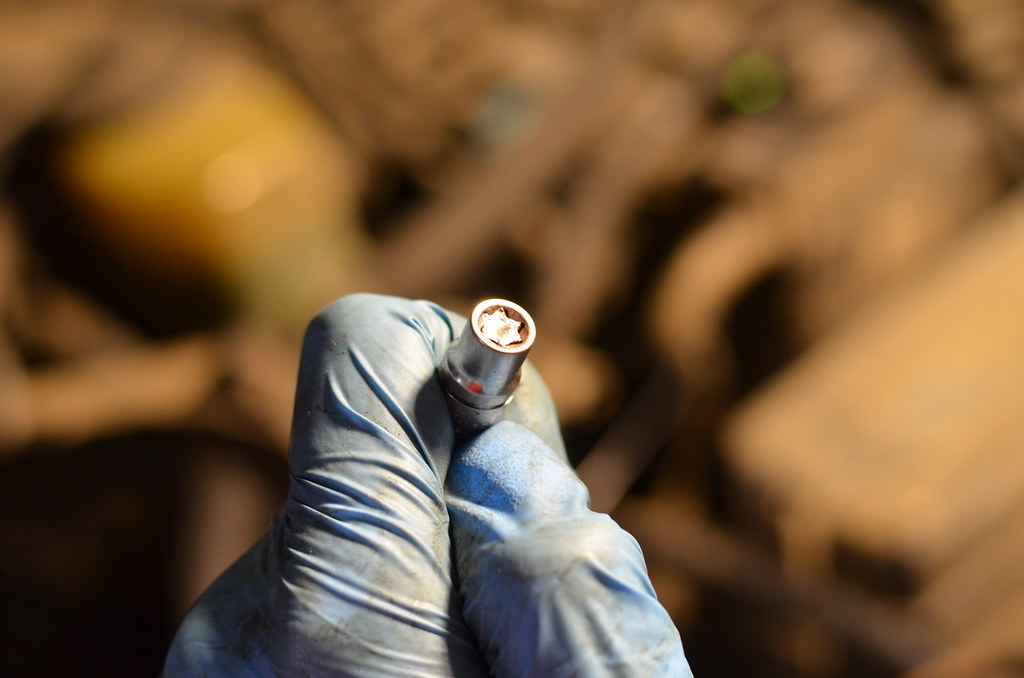

Only real problem I ran into was breaking off the torx head of an exhaust manifold stud.

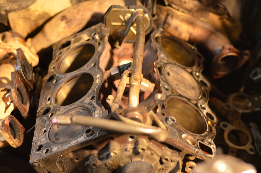

Left head

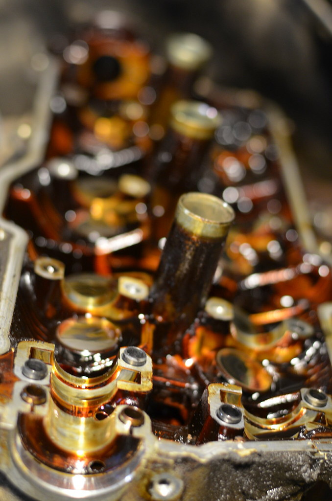

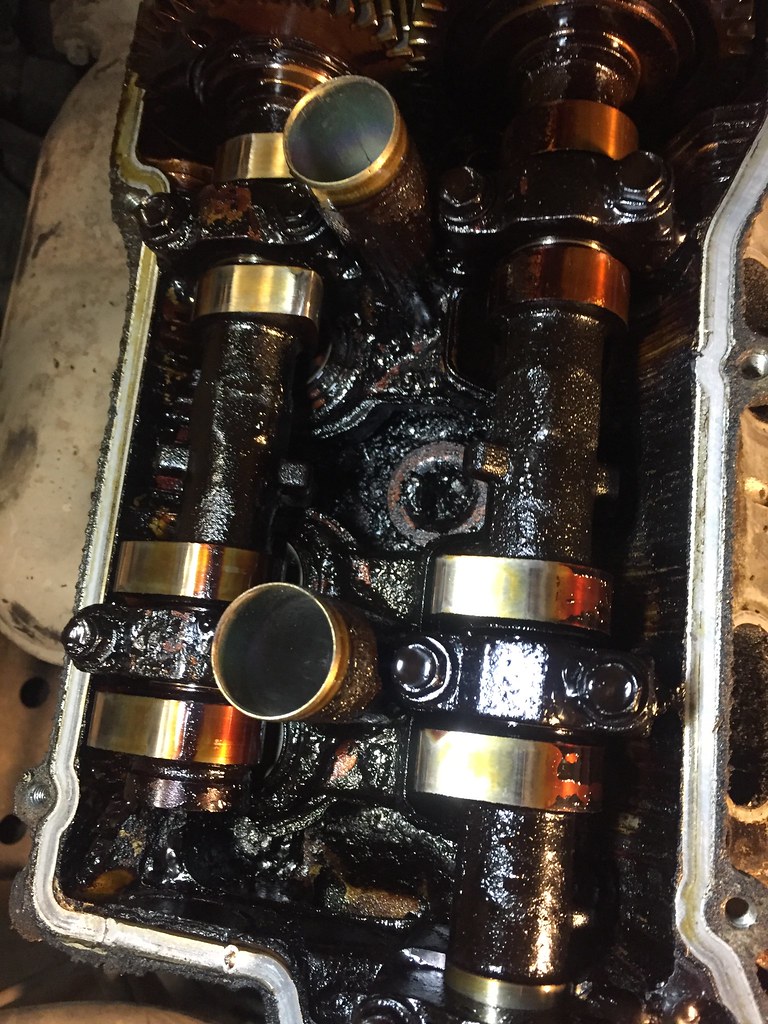

Right head has so much sludge build up.

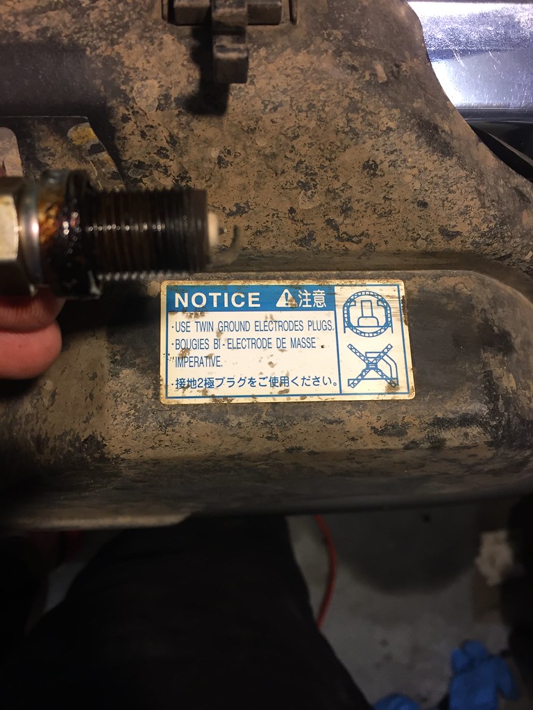

...and installing the correct spark plugs.

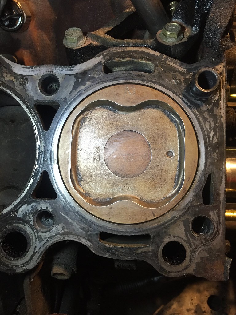

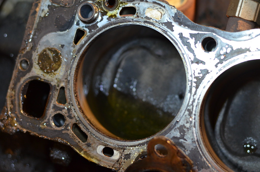

With both heads off I am pretty sure I've figured out where the gasket or head failed. Seems there is a swimming pool in cylinder 6. It's also quite wet and dirty on the manifold and block there.

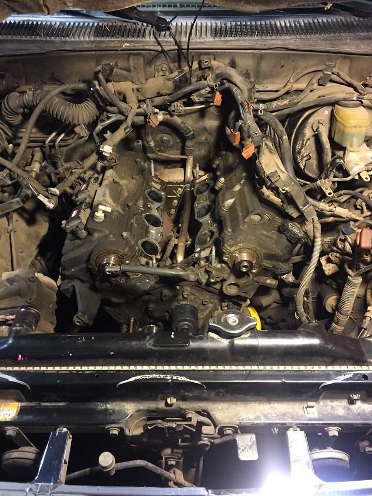

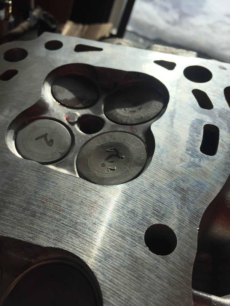

Got the heads refreshed, valve job, seals, and installed them. New timing belt went on yesterday. I think It should be driving by this weekend.
subbed, excited to see where this goes. Good luck!
Thanks you!

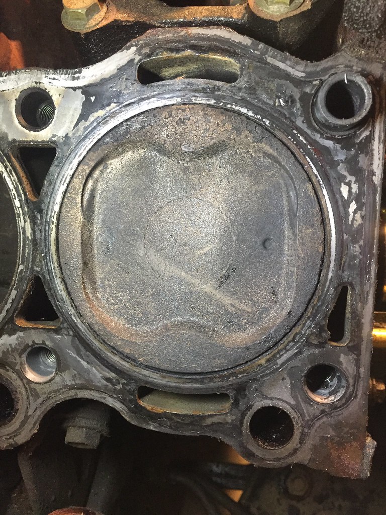

Got the pistons cleaned of carbon while I was in there.
Valve job looked great.
Heads reinstalled

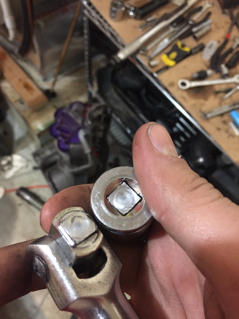

Only real drama is I snapped my breaker trying to get the crank bolt loose. China Freight tools aren't that great. I also ruined two craftsman ratchets trying to brake the cam bolts.
I've had that same problem with HF breaker bars. Workmen you're not in your shop it can be a real bad day.

Mine looked like yours when it came off, cracked on the surface but probably would have held on longer. Good thing to get in front of.

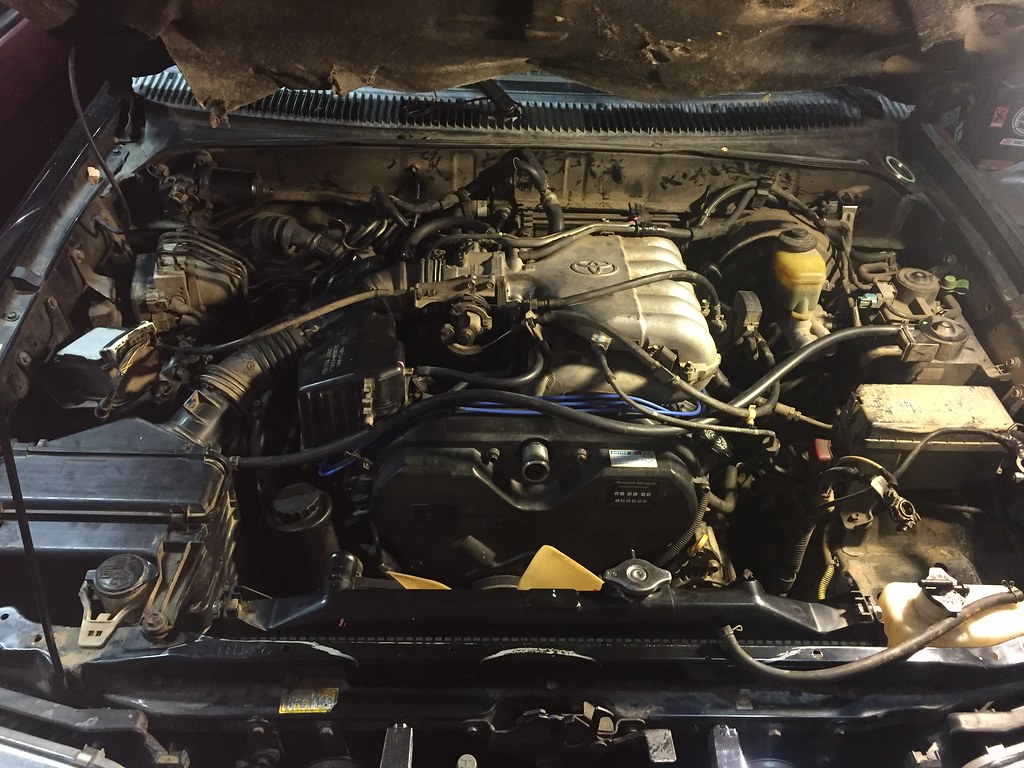

Getting there. I had to order a new heater valve and power steering bolt that I somehow lost. Should get her fired up today.
Looks good, did you take the heads to someone to get them cleaned? Or what did you use to get all the sludge out?
I took the heads to a machine shop. I had the heads decked, and a valve job done. The machinist said that there was lots of play in the valves and that it was quite dirty because of the valve seats. So I am glad I did. It was $400 for both heads for valve job, hot tank, and desk. I decided to just do this job right the first time :hat:

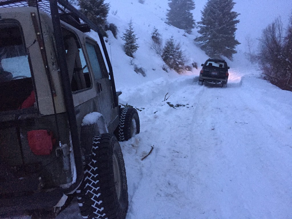

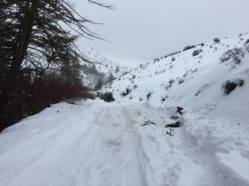

First day I drove it I took it on a little spin in the mountains and got her stuck. I was an idiot and didn't take my hi lift jack, shovel, or even gloves with me. I was only about 10 miles from downtown Boise, so it wasn't really a big deal. I called my mate with a wrangler and figured he would be able to pull me out....
Well, the wrangler got stuck too. Luckly my uncle has a pretty sweet 80 series land cruiser and came up and pulled me out... Well then he got stuck, and he neglected to bring his hi-lift jack and the winch wasn't working (turns out it was wired wrong). I got him pulled out with a tug though.
We couldn't get the wrangler, so we decided to just come back the next day and get it. We used two hi lift jacks to get it out. One as a come along to a tree, and the other to lift the jeep and put it on some motor cycle ramps for traction. Took a few hours but we got it out.
This is a photo of where the jeep got stuck, and how far we drug it with the land cruiser and come along before we got it unstuck.
