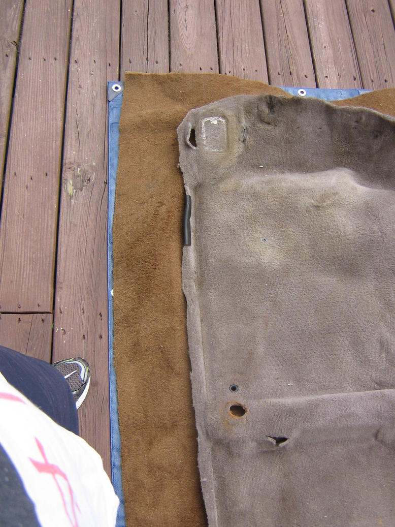

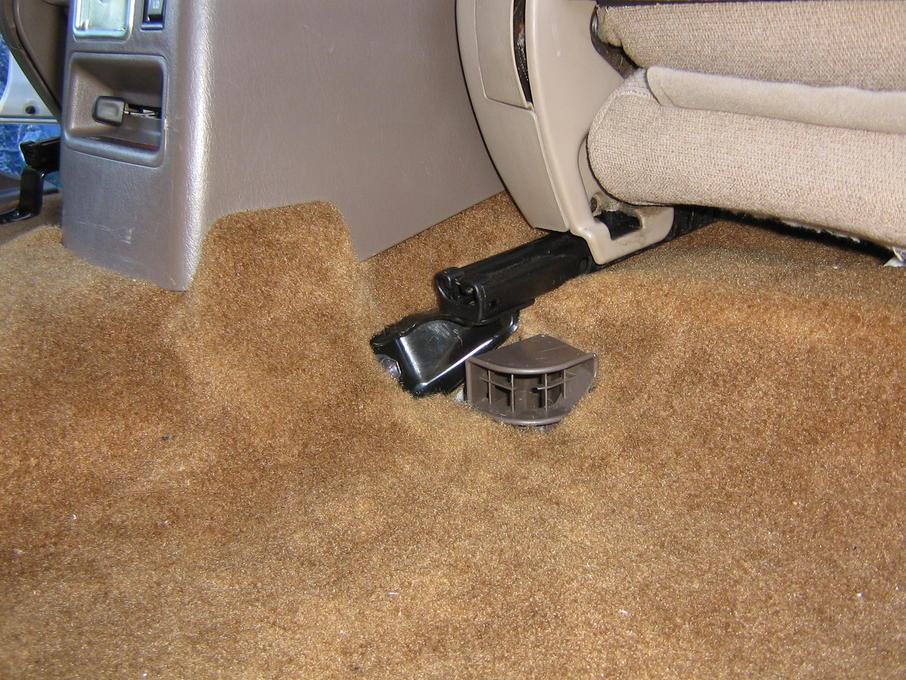

I wanted a darker color than the stock oak but not go brown. Something neutral that hides dirt better than a very light or very dark color would.
The stock oak faded to a grey as seen below. I love it & the quality of the pile is thicker than stock too.

Looks pretty good! Does it hide dirt/sand well?

Is that the stuff that's made to go right in and replace it, or is that just carpet you used?

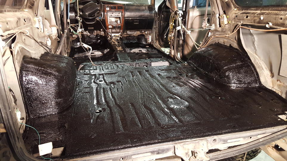

Not exactly carpet (and likely not for you) but definitely durable and good looking. Didn't really notice any increase in road noise either. I can clean my floors with a hose and sprayer, don't have water trapped in my carpet rusting my floor boards and don't really need floor mats anymore either.
It molded to fit but you have to trim the edges & cut out the holes.
You lay your old carpet over the new one & mark all of the cuts with chalk.
Check out their website.
That's way too easy then...I need to check that site out. Thanks.
Mine was the same. Don't underestimate the work involved, especially with the mass backing fighting you as you try to make pretty holes. I'd say it took the better part of a full day, and I was tuckered by the end.
