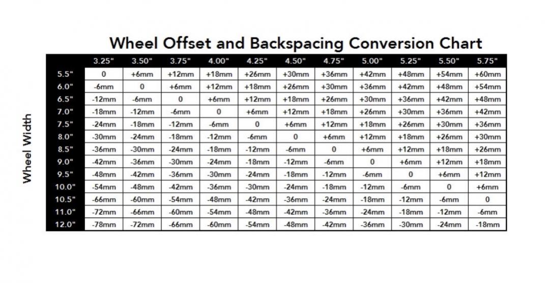

That wheel width and offset are very aggressive. They will poke out of the fender flares exactly 1” more than your wheels right now. See the following chart. An easy way to test the fitment without investing 1k is to buy 1” wheel spacers. I think there is a used set for sale right now in the 4th gen specific thread. Push your wheels out 1” and see for yourself exactly what you need to do to make it work. Or... abort ship and sell the spacers for a minimum to no loss.
I never understood this chart exactly, can anyone explain it?

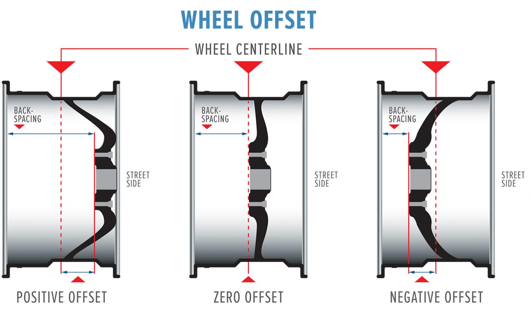

By my logic, with an offset of 0mm, the hub mating face should be exactly in the center of the wheel, no? Which should then mean a backspacing of exactly half the wheel width. This chart(among others I've seen), contradicts that. Anyone able to explain?

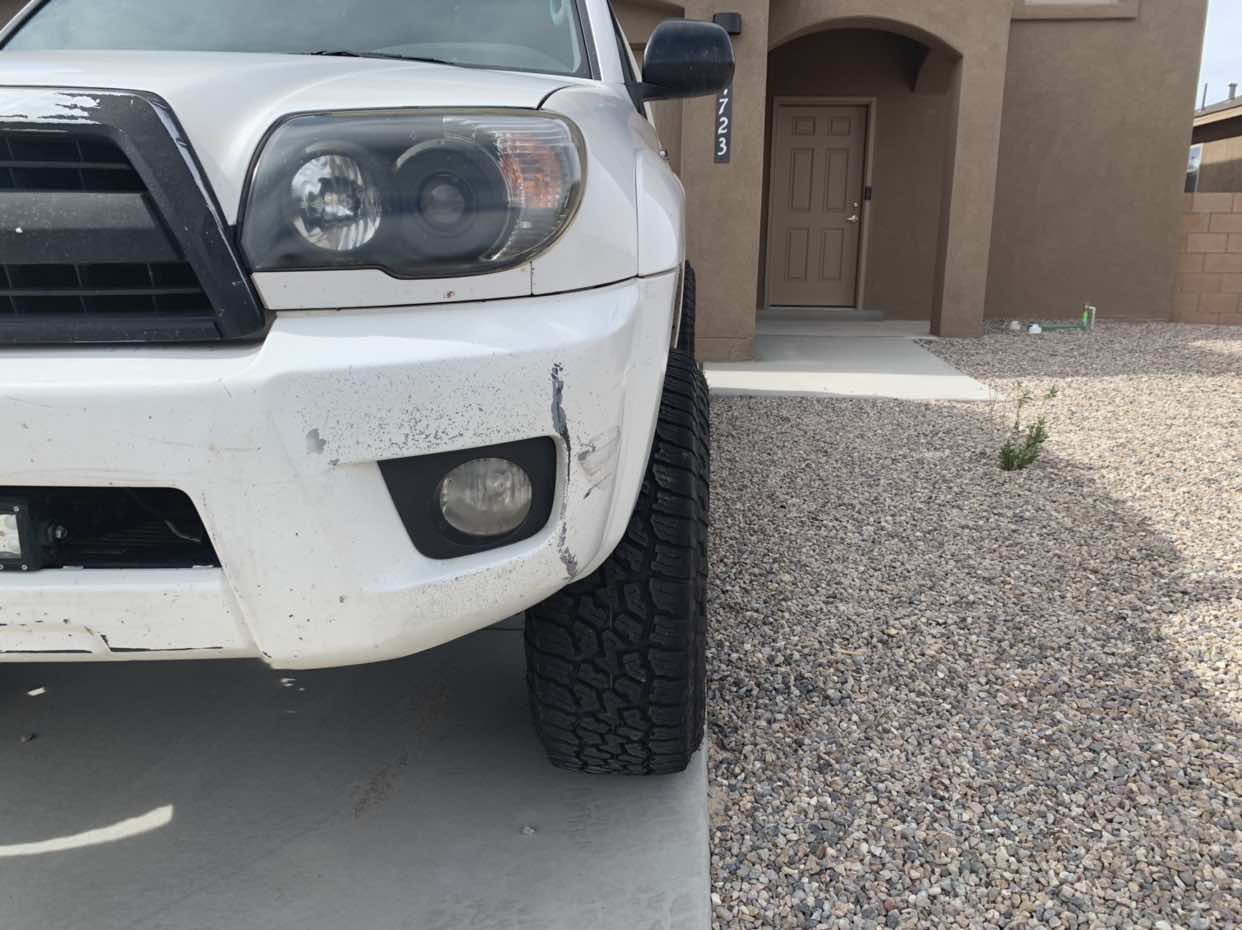

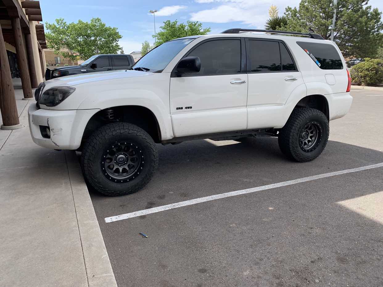

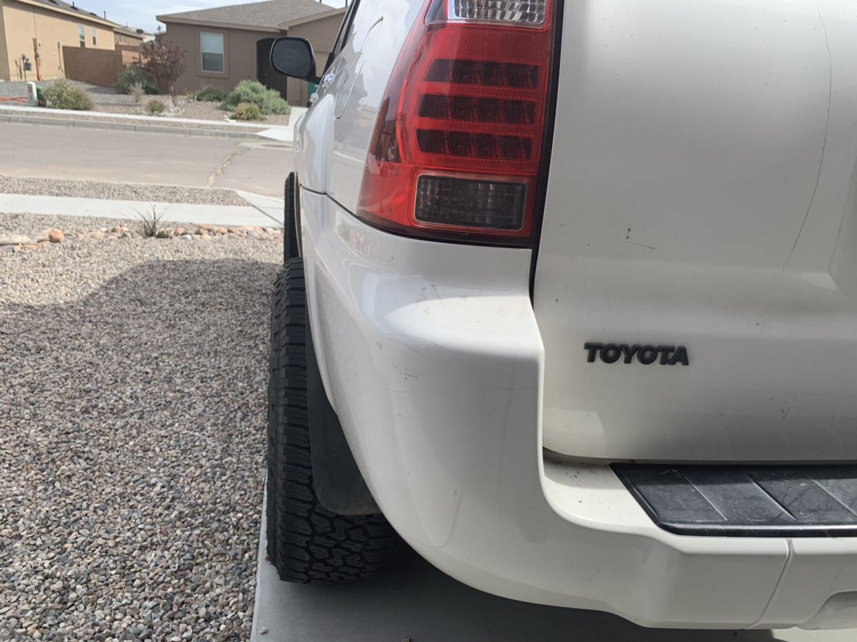

They are awesome. The finish and quality are great. I didn’t have a hard time getting them to fit, but I had a 3” toytec coilover lift, body mount chop and SPC UCA’s already. That being said, I did install a 1” body lift to help and also set my UCA’s to the farthest position forward to help clearing the body mount. I did have to trim the lower front bumper quite a bit as well. Well worth it.

The more negative the offset the more the mating surface is pushed towards the back of the wheel. Another way to think about it is the wheel will stick out further from the fender as compared with zero offset. More negative offset wheels also correspond to bigger lips in the front of the wheel depending on wheel design.
If you check 9” wheel on the chart I previously posted and look at -6 offset you will see that when you compare the backspacing with -38 offset you get approximately 1.25”
Just an FYI, there are a TON of videos and explanations online regarding offset and backspacing.

by the way they look awesome!
Definitely on the body mount. You’ll have to chop it for sure. It sounds more complicated than it is. Any local welder will do it for around $20-$30 including blocking the hole off with plate metal. Just spray paint it so it doesn’t rust. Also the front bumper on the lower inside edge will need trimming. A dremel is best but I literally used a sharp utility knife.

Seriously can’t recommend the wheels enough. They look super aggressive. I get compliments every time I drive it.

I agree and that is what the picture seems to show in opposition to what the chart says.
