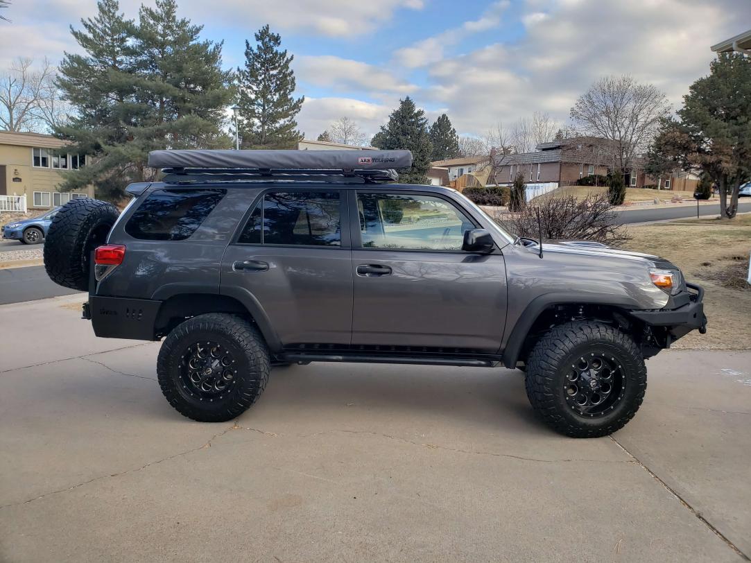

Not seeing too much of this tire on 5th gen. If anyones running this size, please post pic. Just completed BMC and gained about 1.5” of clearance on my 285 with spidertraxx spacers combined with scs gen5 17x8.5 -10 offset. Would want to see how close are people getting to the front and back of wheel when locked. Planning on swapping with f5 17x9 -38 offset and removing spacers, I know I’d easily clear 295/70 so I wanna see if I can push it to 305/70.

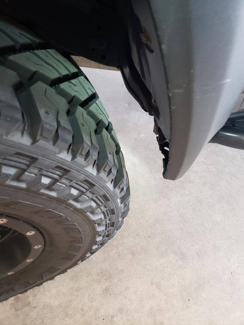

I can't for the life of me find any pics with the 305's so no help there. I did include a pic of what the fender liner looks like for my setup

This is what im looking for, thank you. Running the same setup as you, only difference is I have Gen5 on 285s instead of F5 305s and black spidertraxx instead of blue lol. Did you happen to already hammer the pinch welds? Whats with the blue tape?

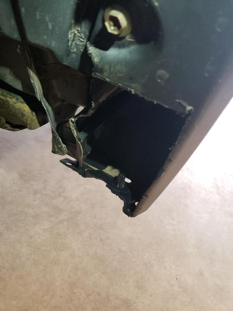

Sorry for lack of context I’m lazy. I cut all of that away to fit -10mm with 1.25” spacers. Deeeep BMC, pinch welds, fender liner mod etc..not the best lighting but this is what my wheel well looks like now. I wanted to keep the fender liner and remove as little fender as possible. At some point I may try to mold a custom fender liner but this works for now and looks stock unless you know what you are looking at. In hindsight I would have done things a bit different if/when I go 315 I will remove spacers
Dang, thats the first time I've seen cut/mod. Im guessing its to clear during articulation when wheels are turned? Are you able to show what it looks like behind the front wheel where the fender cap should be? Also do you recall what your caster is set at? Do you think you would've had better clearance with a body lift?

you didnt even have to cut your tabs you just bent them over? I see you left your pinch welds in tact (metal meeting above the rocker cap tab) <goes vertical> but had to cut your liner up some (maybe 4-6"?)
My cutting is pretty ugly. Considering I did it gradually as I went bigger in tires and when I started not many people were doing it. You can definitely make it look far better than I did.
Yes the body mount chop and trimming the rear fender liner are to clear the tires scrub radius.
The front of the fender isn't there at all anymore. I have a full replacement bumper so in front you can go as far as you need.

you didnt even have to cut your tabs you just bent them over? I see you left your pinch welds in tact (metal meeting above the rocker cap tab) <goes vertical=""> but had to cut your liner up some (maybe 4-6"?)

Yes that's correct I bent the pinch welds over. However, If I had it to do again I would have ground them. When hammering the piss out of the welds it's easy to bend the body panel behind the wheel well so it doesn't line up with the door. Ask me how I know. I was able to bend it back into place but it scared the crap out of me.

Edit: Yes the cuts in the fender liner come up 5 3/4" inch. Good eye
Correct. I haven’t put the fender cap back on yet, I am contemplating how to completely remove the portion of fender that the cap clips on too and make it look reasonable. I wish I would have sandwiched my liner when I hammered the pinch welds. Castor is 4.4 I think. Personally I wouldn’t bother with body lift, I am not a fan of the look and if you are fully articulating your suspension you will probably still rub with a large - off set. The vehicle doesn’t like these big heavy tires and I have a set of 4.88’s waiting to be installed.
what do you mean by "sandwich the liner" My goal is to keep my rocker caps...
