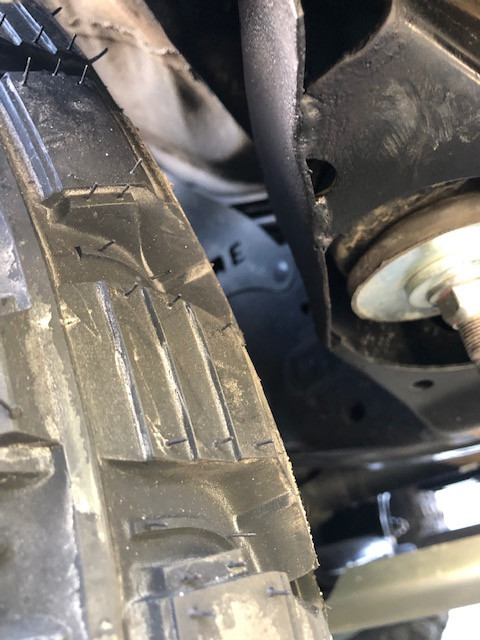

I recently went with 305's as I wanted 35's but not ready to cut fenders on a new vehicle lol. Still working to get them to fit fully with no rub but it's not to bad. A slight rub under compression while at full lock isn't a big concern to me.
This is my clearance at full lock after moving my castor as far forward as possible with a fairly aggressive bmc

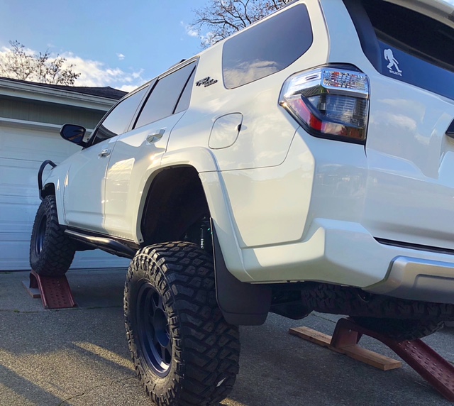

So i have officially made the change to 305s -38mm offsets.
its not that bad... honestly.
Wasnt as scary as some others make it out to be :car:
think with everything i did i could have gone 315 tbh...
