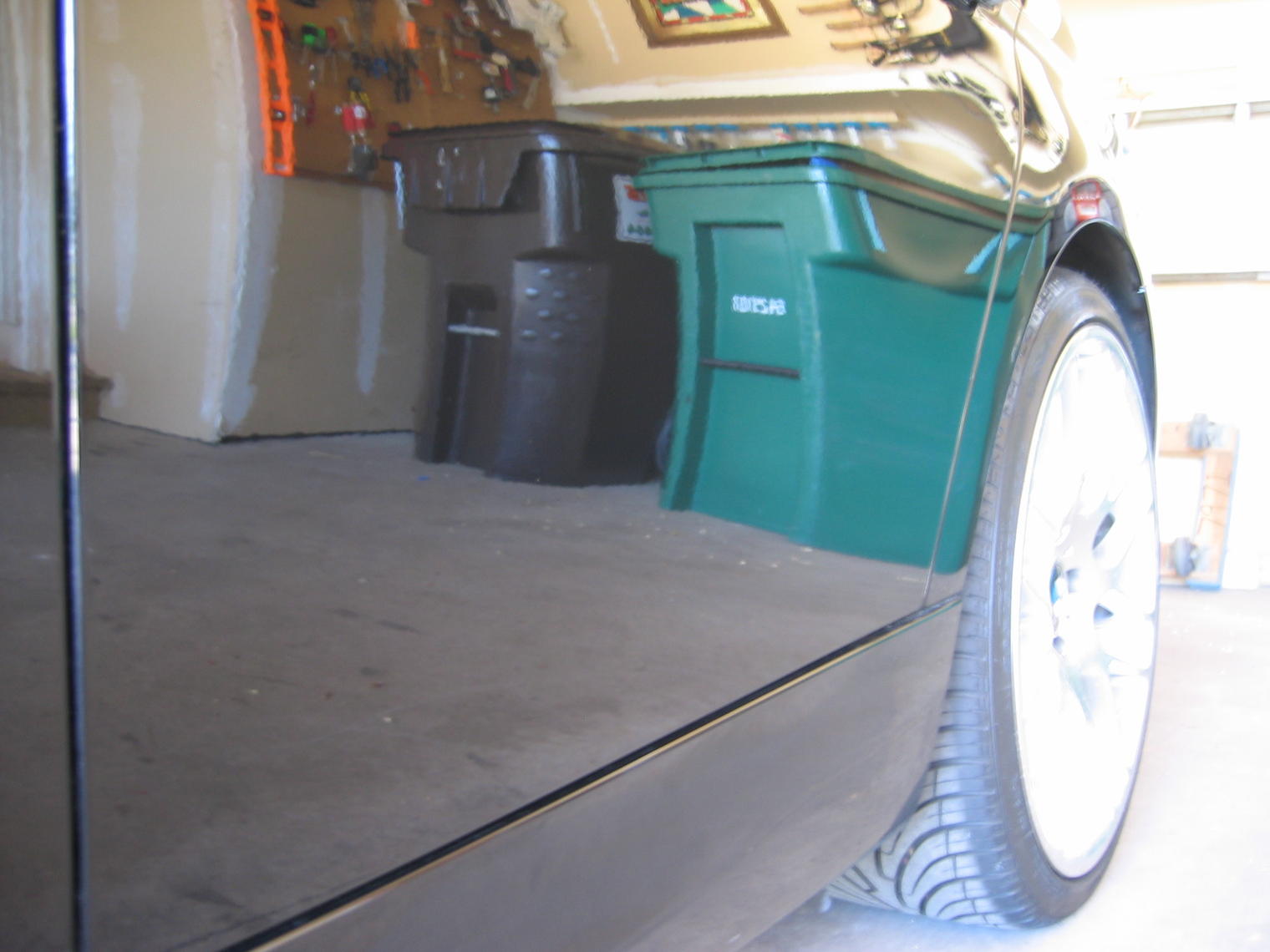

Toyota's historically have softer clear coats. I would recommend the 2 Bucket Method to avoid scratching during hand washes. The Klasse will act as a sacrificial layer between the elements and your clear coat. It will also fill in minor spiderwebs and swirls by rounding over the sharp edges of the scratch, which reduces how much light is refracted by them. The swirls will mostly disappear or be significantly reduced with a good synthetic coating.
Also, make sure you wash with a mit that has a deep fingers or areas where grit can sit and not be rubbed against the paint. Sheepskin or microfiber mits with fingers are good. Do not use a regular microfiber sponge, as you will continue to grind the dirt you are trying to wash off into the paint. The dirt needs somewhere to go...
Here's what the Klasse looks like when you're done. Sorry they're sideways... Something about this computer on T4R isn't straight... :typing:

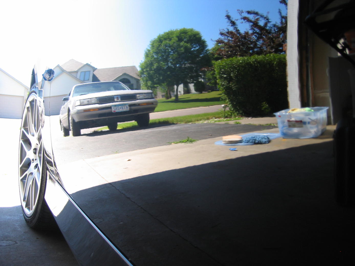

I've always been a big fan of Menzerna polishes and Optimum sealers. I always kept my black car spotless with them and the work easily lasted a year.
P5192776 by tmdevers, on Flickr
I really miss having a black car because of how good it looks but it's nice to be relaxed with the 4runner as it's silver but those products still do a great job.

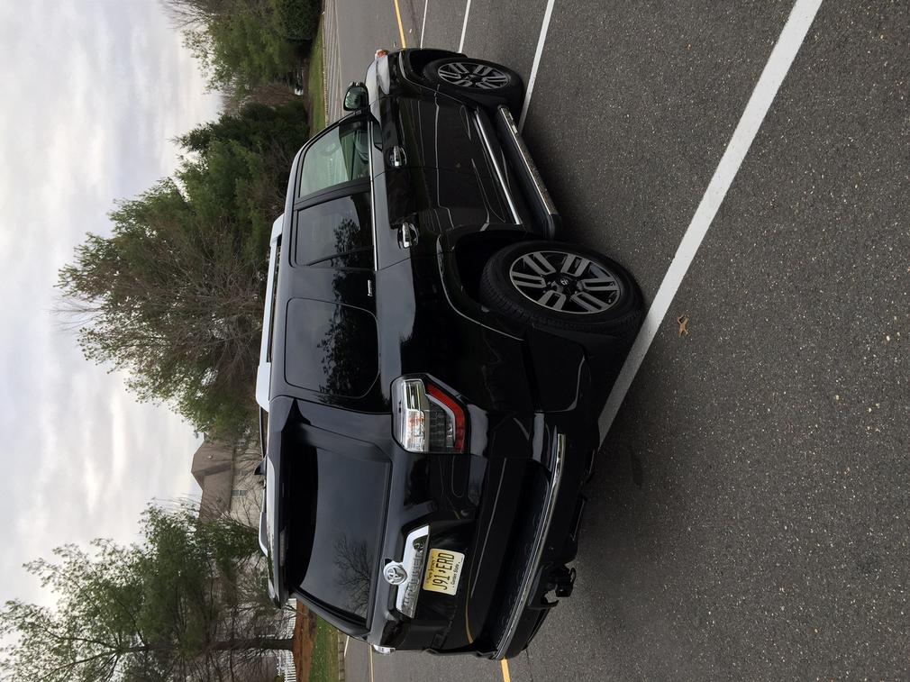

I just picked up a 2015 attitude black LE yesterday just in time to get covered in snow from last night. This is some great information and come spring time when I detail the truck I plan to use this advice.
