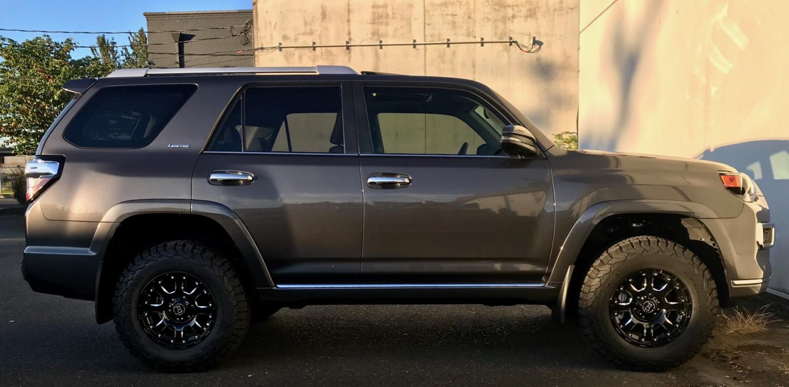

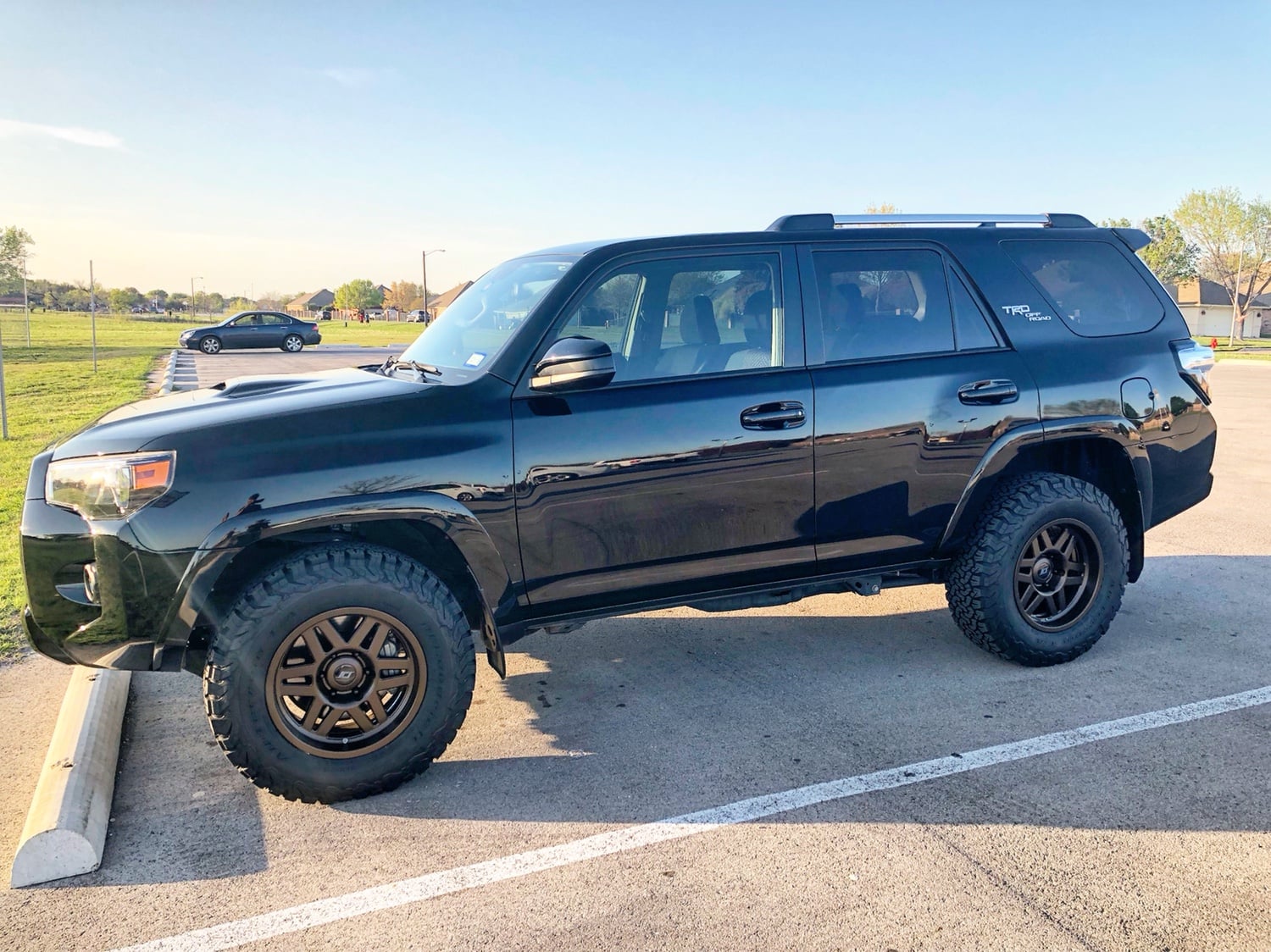

275/70-17s with 5100s at 1.75" front with 3/4" Cornfed rear spacers. FN Six Shooters, 17x8 +0mm.
625FB831-4C84-49FE-9B69-23A0E0A5177F_zpshmmxifs1.jpg~original
Any rubbing issues?
Very clean ☝
I’m about to close on a 2016 Trail with Trd Pro wheels and 275 KO2’s, and will report back. Everything I’ve read and researched suggests this won’t rub at all.
Very clean ☝
You never know, my 275’s rubbed in reverse full lock which surprised me when I got em.
You remove flaps or liner mod, or are you full stock?
Bilstein FJ Pro kit with a Daystar coil isolator so I’m lifted 2” up front. Left the mud flaps for now but I trimmed slightly and pushed the liner back. They would barely touch but you could really hear it.
275's on Pro wheels shouldn't rub if you have the liner mod done and if you don't they should only rub when in reverse and even then only very very lightly. I am running 275's on Pro wheels on the Pro (which has the liner mod done at port) along with a 1.5" front and 1" rear lift and there's no possible way to get them to rub under any circumstances.

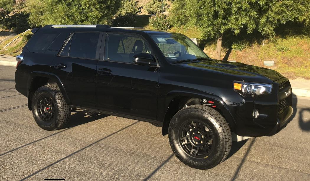

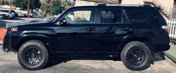

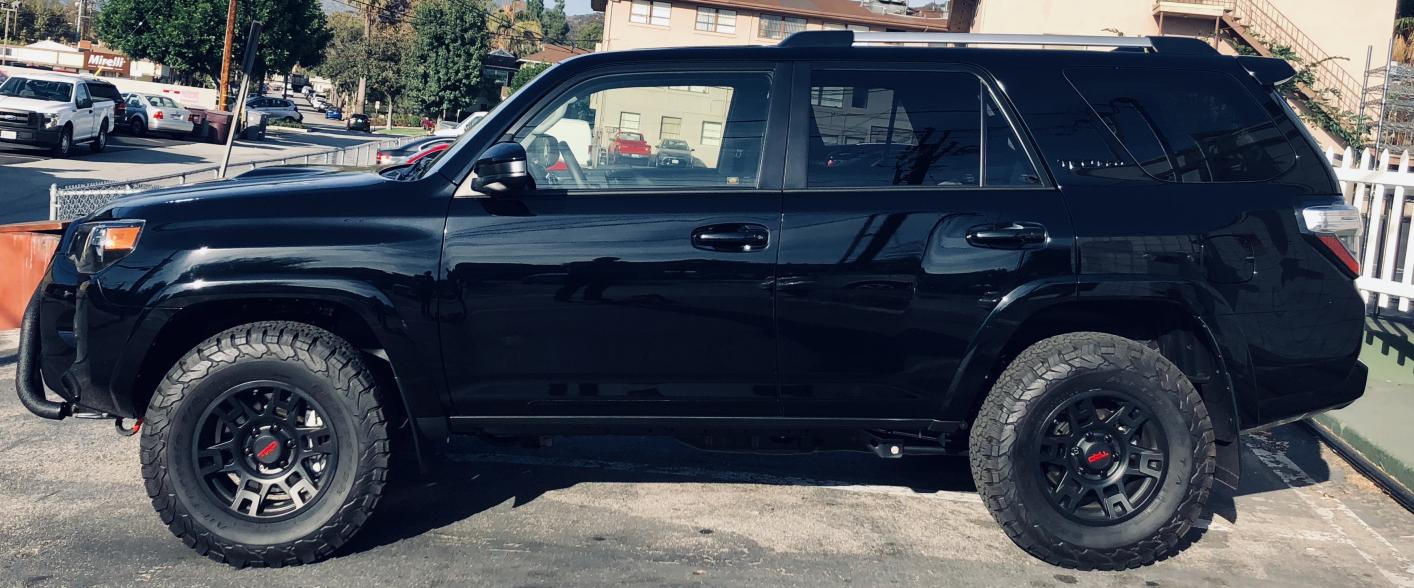

For comparison purposes. Attached are pictures of my Pro when new with 265’s, then 275’s without a lift, and currently with 275’s and Cornfed 1.5/1” spacers. The Pro sits 3/4-1” higher up front than the other 4Runner models and the front fenders are trimmed at the port on the Pros. No rubbing or mods to accommodate the 275’s even without the suspension mod. I would think that a 3/4-1” spacer up front with a possible fender trim would accept 275’s properly on OR’s and SR5’s without removing the mud flaps.

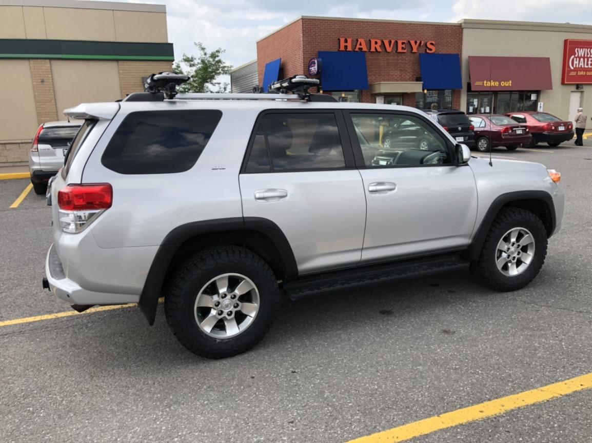

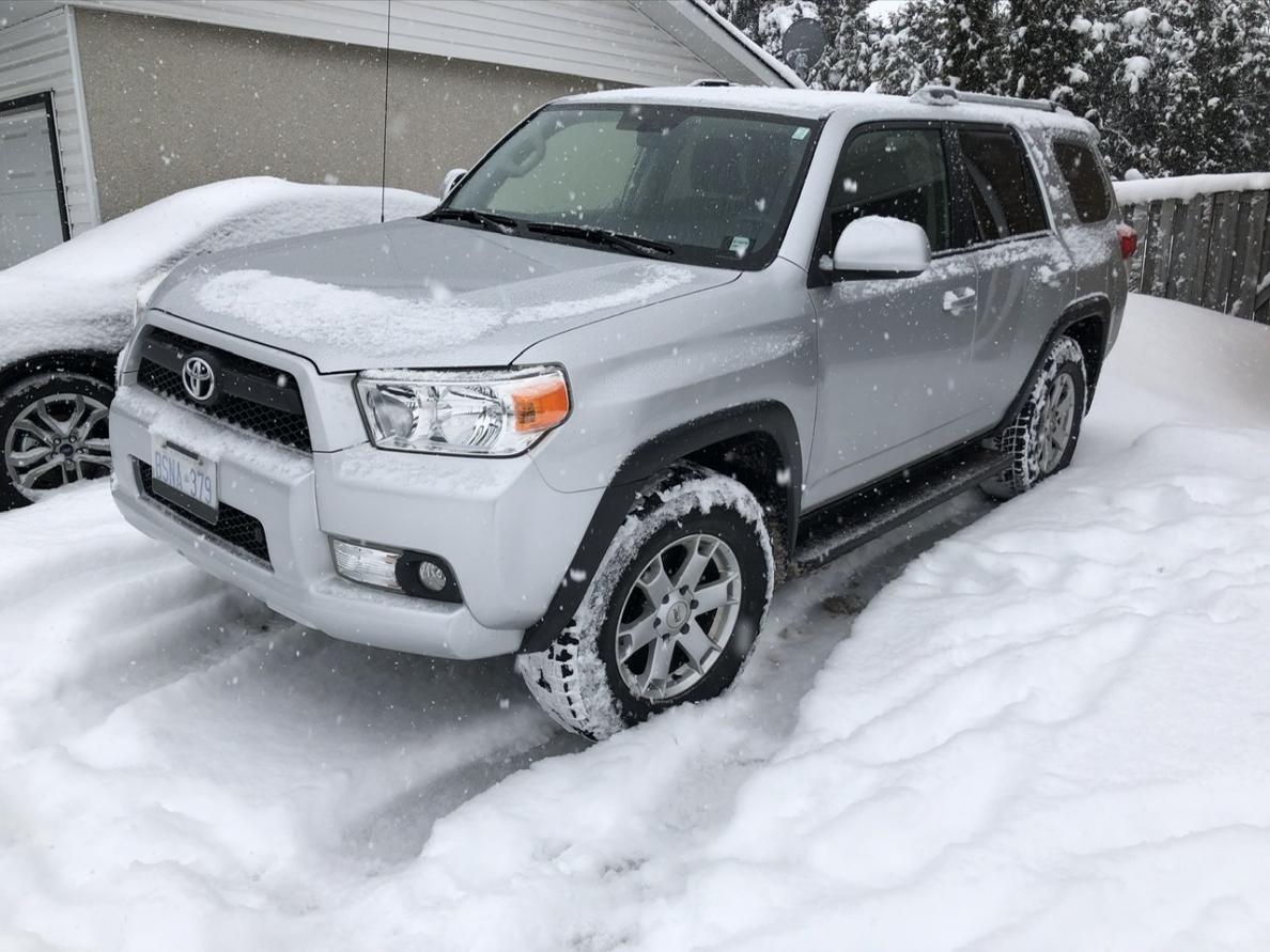

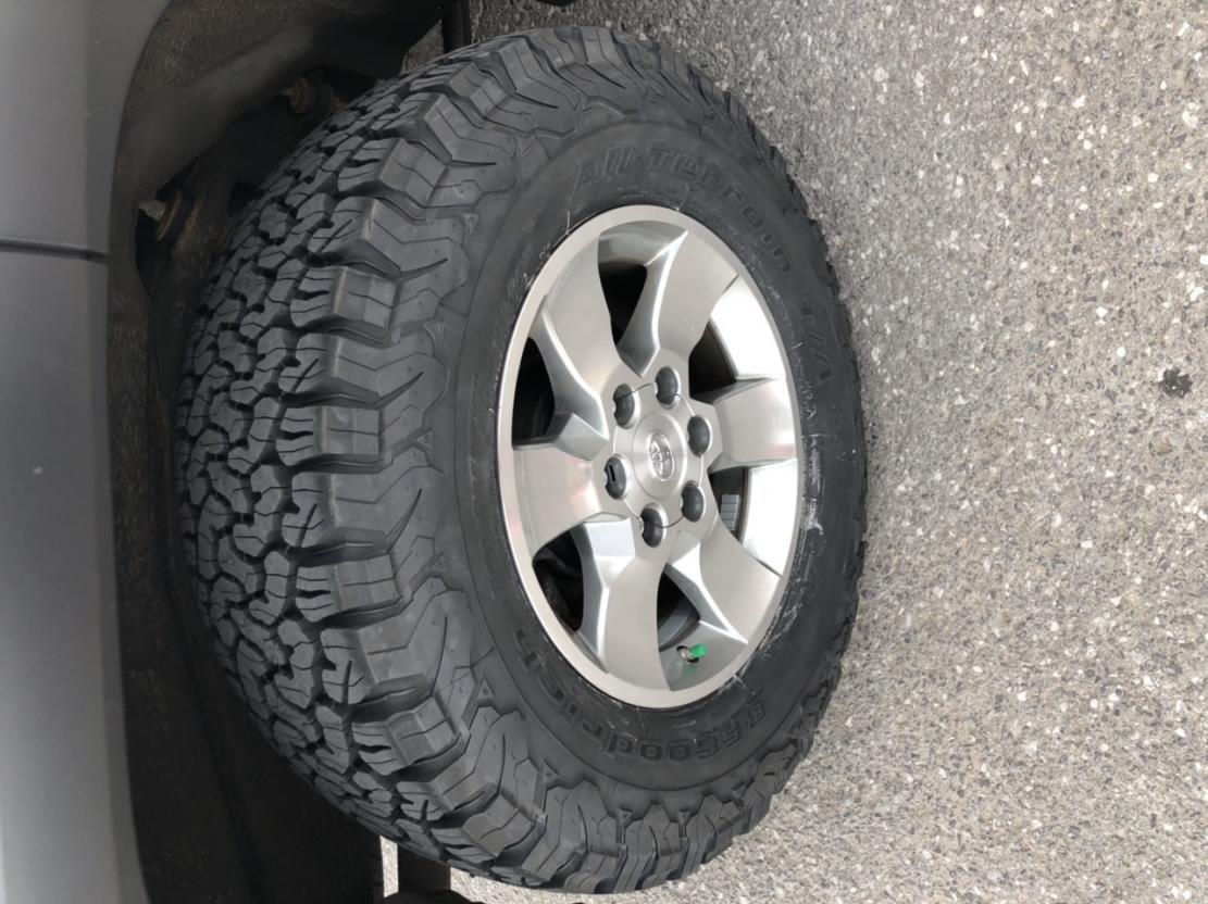

Can anyone offer advice on tire pressure for my new BFGoodrich All-Terrain T/A K02s on my 2013 SR5?
I went with the LT265/70R17 load C.
How low and high do you go for various conditions?
If you air down what do you use to pump tires back up?
I’m new here and would appreciate any feedback including links.
Thank you.
Thank you.
It depends what load you carry. I have the same tires as you and usually run them at around 38 PSI front and back. I've seen folks run them at around 40 PSI as well to get better mileage. I just moved from Texas to the Chicago area and did the trip at around 42 PSI towing a trailer. I've since aired them back down to around 36-38 which is the sweet spot for a comfortable ride for my truck (my suspension was done to carry more weight than I currently carry).
I use the ARB deflator and ARB inflation kit, an ARB air compressor (model # in my signature) and a small tire gauge to check tire pressures. Depending upon your use case you could get something cheaper and portable or something better and mounted (like having a compressor and a tank etc). I have done a couple of trails in California and Texas in the short bit of time since I've had this rig and the lowest I needed to go on them was around 18 PSI. You should be able to go down to the low teens or perhaps even lower if you are driving on some soft sand etc.
