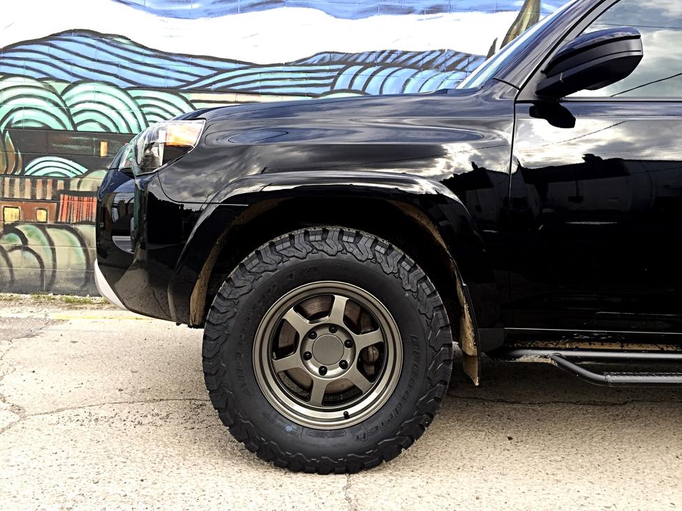

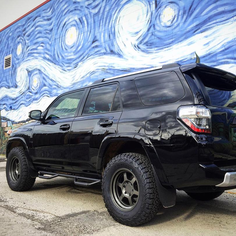

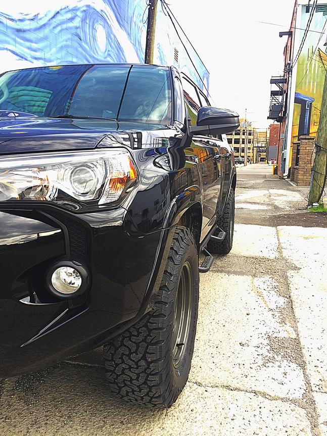

Exactly, this was the first thing I added to the new T4R.
265s stock suspension.

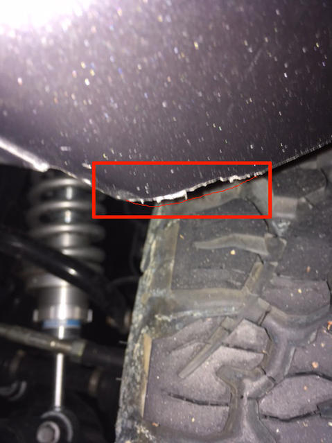

I did. I put KO2 265s on FN Fx Pro wheels and had some rubbing on the driver's side fender/bumper when in reverse and steering turned all the way to the right. Pushing the black fender liner plastic forward didn't fix my problem. I had to trim off a piece of the bumper/fender with a Dremel tool. Below is a picture taken from the front of the truck, driver's side, looking up at the bumper/fender. The red area marks the part I had to trim.

Thanks for the info! Can you notice this trimming when looking from the side ?

It would be difficult to notice something that is no longer there, trim it neatly and smoothly and all will be fine. I pushed the wheel well liner as far forward as possible and trimmed the fender to match.

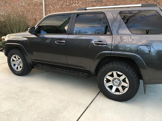

I'll add my review with about 25000 miles on my KO2s. I went with 275/70r17 on the stock SR5 wheels. Impressions after living with them for a while:
-Road noise is impressively quiet for a fairly aggressive AT tire.
-Wet traction is mediocre at best, it's my biggest complaint.
-They're heavy, not terribly noticeable most of the time, but they are definitely heavy.
-I can't average above 19.5mpg over a full tank of gas no matter how hard I try where I am in the southern Appalachian foothills.
-No rubbing with the exception of full lock reverse, and that's only sometimes.
-White letters out has become a hassle to keep looking clean.
-Tread wear has been even and long-lasting so far. I'll easily get 50,000 miles out of these.
-I love the way they look, and the attitude that they give an otherwise stock 5th gen.
Will I buy them again? If I do, I think I'll go down to the 265/70 size to save some weight and MPG. 99.9% of my driving is on the road, so it only makes sense. The weight is noticeable going over broken pavement, or quick downshifts during acceleration, and saving 5-10 lbs of unsprung weight per tire is a significant difference. I'm leaning toward trying out another brand in another 25000 miles when these are worn out just because of the poor wet pavement traction.
