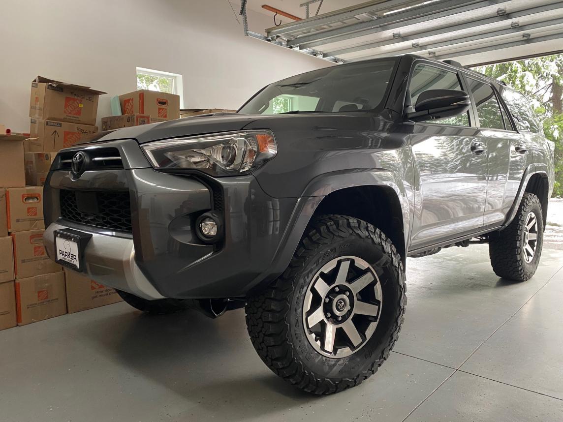

Well, I recently changed from the stock Dunlap tires to BFG K02s load range C in 285/70 with stock OPR wheels.
Rides slightly rougher, which was expected because of the tire change. But it continues to be very comfortable on road. I haven't been able to spend much time off road yet.
Hazzard Fab Worx, up here, did a nice install job. And put in a diff drop too.
No tire rubbing so far, but I've yet to fully test it so I'm pretty sure there will be some mods necessary.
As far as added weight; It will be interesting to see what happens as I add the low pro bumper and VR EVO w/synthetic cable winch, aluminum skid plates and RSG sliders.

Quick snap with new tires in the garage.
