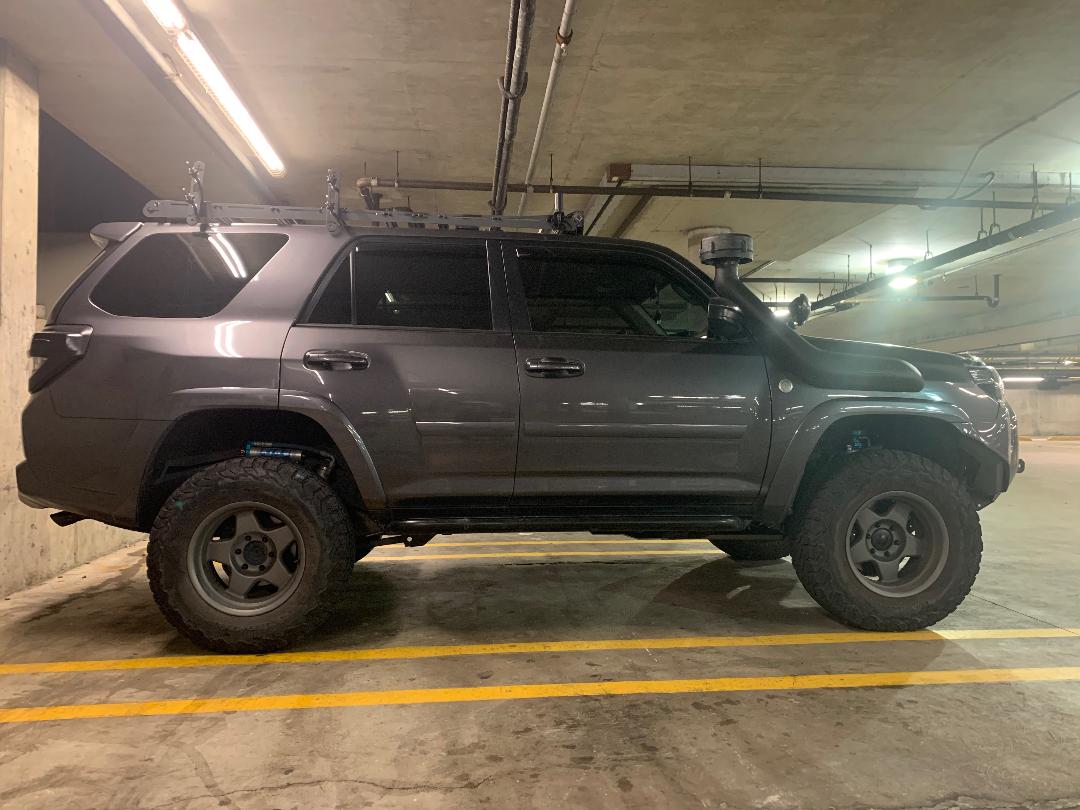

So basically this is the best pic i can get. 3 inch lift up front (with zero preload) and basically 4 inches in the rear. So i have a 1 inch rake, but currently the vehicle has full armor, and a drawer system in it. Fridge and 2nd battery is not in the vehicle currently, and it has no camping equipment. I'm happy with it right now, i figure once loaded up i will lose the rake. Only reason i noticed the rake is because i measured it, and my headlights are kind of pointed downwards.
On road, it is very firm, since the vehicle now is overstrung. However, I don't hit the bump stops ever, which is one of the goals of the suspension over haul. Basically, it feels like a sports car on stilts. Just know running it with 700lb springs in the front and 600-800 springs in the rear, unloaded will give you a stiff ride, but its not jarring. So what i am sacrificing is slow speed comfort.

slight rake with no camping load. no reverse rake when vehicle loaded out with camping gear or 4 passengers. No bottoming out when offroading. No messing with preload. i also didn't want to rely on my airbags (which have since been removed w/ the installation of the 329 rear coils)
I got tired of the cali lean when fully loaded out and bottoming out when offroading. Moab and Mojave road taught me i rather be a little overstrung vs undersprung, when the terrain can change very quickly, and at speed.
i went with the 329s because i have KDSS, so no variable rate springs for me.
i think you will be fine with 650's and 327s, and it will give you some room if you want to add more weight to either end of your 4runner.

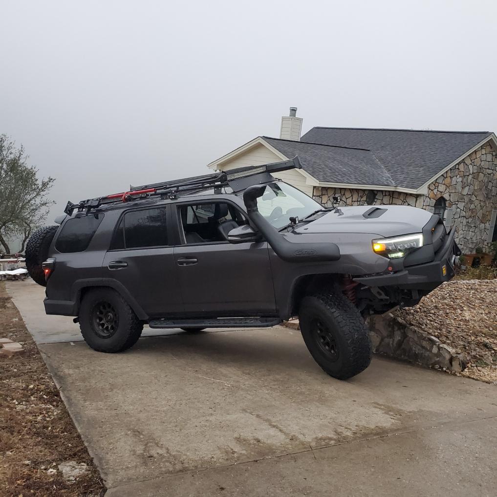

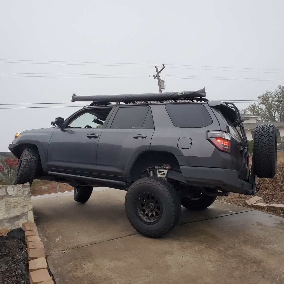

- 2015 Trail no KDSS
- 25001-278-EXT-A: front ext travel w adjusters and 550 lb x 14" coils (adjusters at 2 clicks from soft)
- 25001-279-EXT-A: rear ext travel w adjusters and Dobinson's C59-677V 3"+ coils (adjusters at 2 clicks from soft)
- Preload: D=12 & P=10
- Height increase: Front 23" D&P (3" increase over stock at 20") - Rear 25" D&P (3.5" increase over stock at 21.5")
- Major weight upgrades: Aluminum front bumper (60 lbs) w/ 10K winch (90 lbs), Aluminum rear bumper (80 lbs) Aluminum Full Skids (100 lbs), steel sliders (160 lbs), steel roof rack (80 lbs), misc (+/- 130 lbs) = +/- 700 lbs
- comments based on previous suspension iterations: stock > Bilstein 5100's > Toytec ultimate w/ superflex:
1) HWY (285 KO2 @ 40-42 psi) comfortable and controlled with front/rear sway bars intact at 60-80 mph. feels planted to the ground, best adjective i can think of is it "glides" over even rough/dippy hwy terrain with improved damping (less bounce/roll)
2) City & CR (285 KO2 @ 40-42 psi) a lot of time at 50-60 mpg on curvy/rutted 2 lane roads in central TX, confidence in handling greatly improved from prev setups. significantly less (still mildly noticeable) cabin shake & steering vibration in washboard areas even with tires at full pressure
3) Off-road: (285 KO2 @ 16-18 psi): will hold comments and update after future fun times, haven't gotten to play enough yet :( too much rain and not a big muddin' guy ha. i think i will remove at least the rear sway bar on my next outing
4) Towing: Airstream Bambi Sport (cute name right?): 16'/3K lb trailer 350 lb tongue weight without weight distribution system or rear airbags. it is a relatively light load to haul and is almost easy to forget is behind you. basically, i have to remind myself to drive easy so as not to abuse Bambi. minimal static sag in the rear (approx .75")
