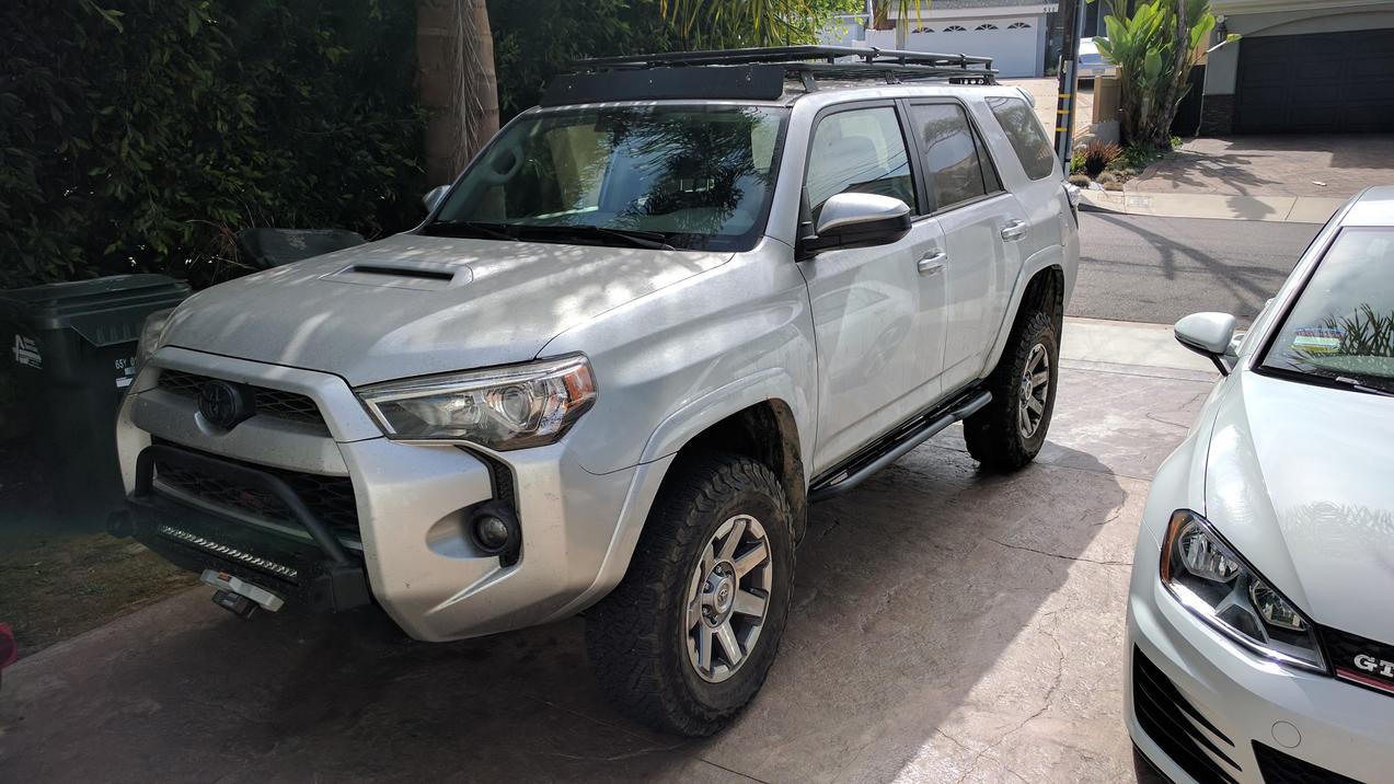

Here's my info...and fwiw I am able to adjust with the coilovers on the rig. I know this is not what they tell you do cause they don't want you to mess up the threads, but I jack up the corner and leave the tire on. This removes enough preload to get to where I am on my threads. I wouldn't try to add any more though cause it gets pretty stiff.
- 2015 TE
- KDSS yes, no adjustments for lean
- 600lbs
- 8 Driver, 8 Passenger side
- 3"
- Hefty Fab Aluminum front, Warn VR10000S Winch, Odyssey 34R battery, ARB Dual Compressor...and my hack job wiring.:wink2:
- Went from 6 to 8 threads showing to help clear the 305/70-17 Nittos.
- Ride is honestly a little firm on the little bumps. Very solid on turns, so much so that I am contemplating experimenting by disconnecting my sway bars from the KDSS pistons. Off road they still flex well...probably cause of the 600 lbs coils. I am, however, thinking of changing to 650 lbs coils when I need to have them serviced. I could reduce preload that way and maintain the height I feel i need.

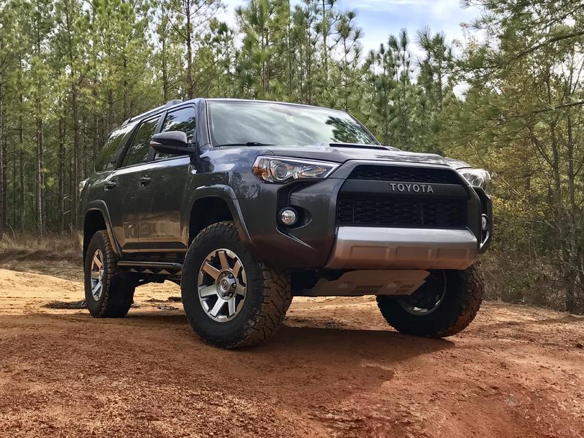

I'll play. This info was pretty hard to come by when I did my install, and I wish I had more info to inform my settings. Hopefully someone can benefit from this and not need to readjust like I do :)
- 2016 TE
- KDSS. No lean compensation needed.
- 650# springs in front, SAW ~1.5" coils rear.
- 3 turns preload on both front coils. 1.25" spacers all around (Increases the motion ratio, so more preload is needed to achieve the same lift)
- no adjusters, no regrets about not getting them.
- extended travel front shocks, total chaos ucas
- Currently 1.5"F/2.0"R.
- SSO front bumper, Warn ZEON 10-s, OPOR sliders, Gobi, RTT, and about 100lbs of tools/gear in back. Second battery is in the works.
- I will be adding 4-5 turns of preload to bring me to 2.5"/2" F/R lift to level everything out. Needs bigger tires too, but I'll wait until I wear out the 265's first.
- Overall very happy with the setup. Feels a bit stiffer unladen on the road over small bumps than stock (especially in the rear). Once you get the high-speed compression circuit to open up (large, fast hits like potholes and larger bumps), it is straight butter. Higher-speed travel in rough stuff is night a day difference from stock, even with the KDSS. Still corners like a race car on the road. Articulation is still great.

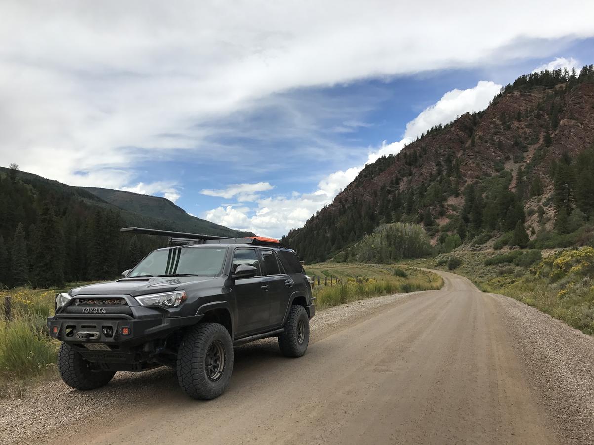

To add value to this post:
—tires are 285’s on factory wheels. No rub, stuffed, lock to lock.
