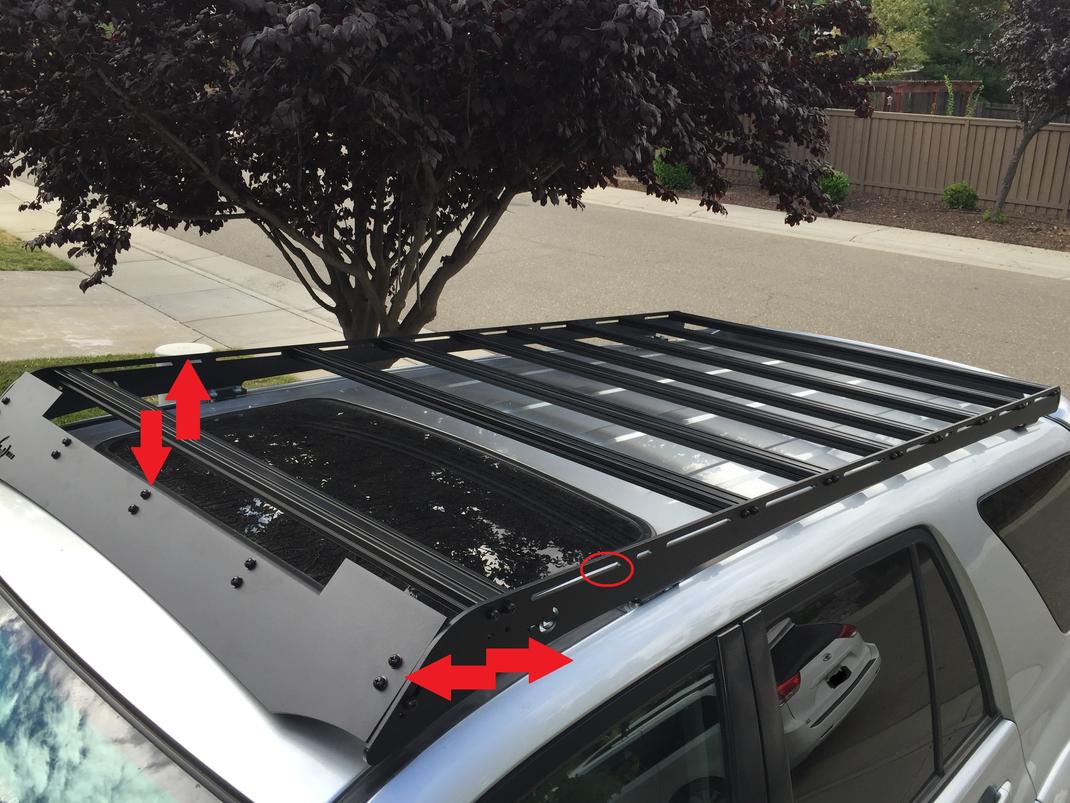

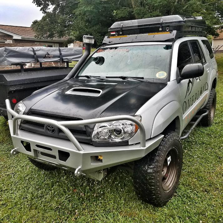

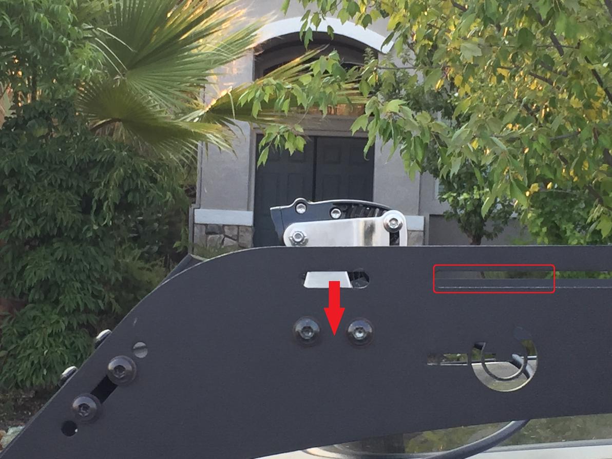

[MENTION=152901]pjku79[/MENTION] yeah, I have had a couple of different vibrations with my prinsu rack. At first, I had the cut-out, but no light bar too. That lead to the first cross member vibrating up and down when above about 45 mph... made a gawd-awful noise too. See the vertical red arrows in first attached picture. The solution was to lower that first cross member bar down to get it out of the wind (you can see the location in the second picture...moved as shown by red arrow).
All was good (or at least better) until I put the light bar on... then I got a new vibration... This time it was a left/right movement of the front of the rack... (see the left/right read arrows in the first picture for a rough idea where I thought it was moving). It didnt seem to happen all the time or at a determinable speed (that I could tell), so it took me some time to figure it out.
I double checked that everything was tightened down - no luck. So I figured it was just a new harmonic due to the different air flow caused by the light bar combining with the open space (between cross member bars) above my sunroof. :confused:
Well, Im still not really sure what caused it... but my "fix" seems to have significantly decreased occurrence and intensity (it still vibrates on occasion... but now its usually in cross winds or other less common scenarios). Anyway, to "fix" it... I added another cross member bar right behind the light bar holding cross member bar. I dont have a picture of it... but the red box in the second picture is where I put it. I'm, sure if I moved that new cross member bar back, closer to the front mounting point (see red oval in first picture) it'd further reduce/eliminate the vibration... but I havnt tried it yet and dont really want to block the sunroof opening and the vibration really isnt that bad... so IDK I might not ever move it.
Anyway, like [MENTION=117708]blackoutt[/MENTION] said... lots of tweaking... just keep playing with the configuration / spacing of the light bar and other cross bars and wind screens until you get it to a point you can live with it.
Hope that helps (at least some).

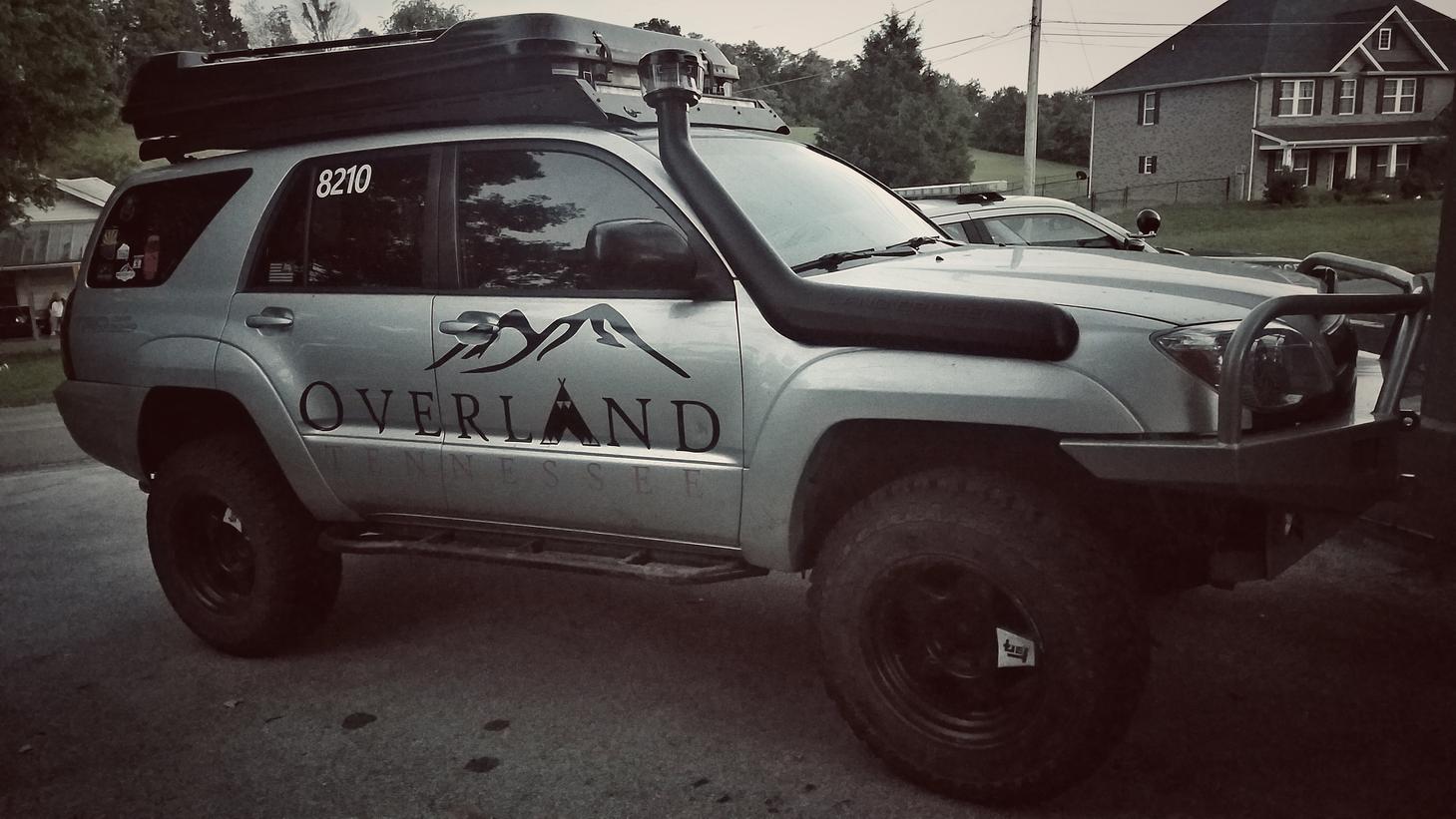

I don't have any vibration sound issues however I mounted a GoPro while hitting some Nevada desert at approximately 80mph, upon watching the footage, the unsupported area on the front of the rack jiggles back and forth violently side to side. I have had the light bar on since instslling the rack, and multiple tents throughout the years. No vibration noises at all..
