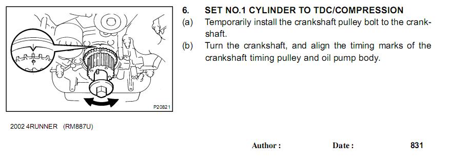

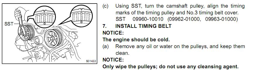

I assume you have seen this but if not it may help.
