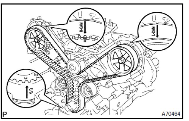

Please show me a pic of your timing marks lining up to the T mark, and also cite your reference to "lining up to the T marks". I think you might be using the wrong mark but wanted to see your references first. I attached a non VVTI timing mark for my '03, not sure what a VVTI looks like. It does sound like the VVTI cam gear thing is a complex animal.
Thanks.

download repair manual here
https://www.toyota-4runner.org/3895755-post7.html
Open HTML file and look for these entries.
R.M. 2007::2UZ-FE Engine Mechanical: Timing Belt: Components (4Runner)
R.M. 2007::2UZ-FE Engine Mechanical: Timing Belt: Removal (4Runner)
R.M. 2007::2UZ-FE Engine Mechanical: Timing Belt: Installation (4Runner)
