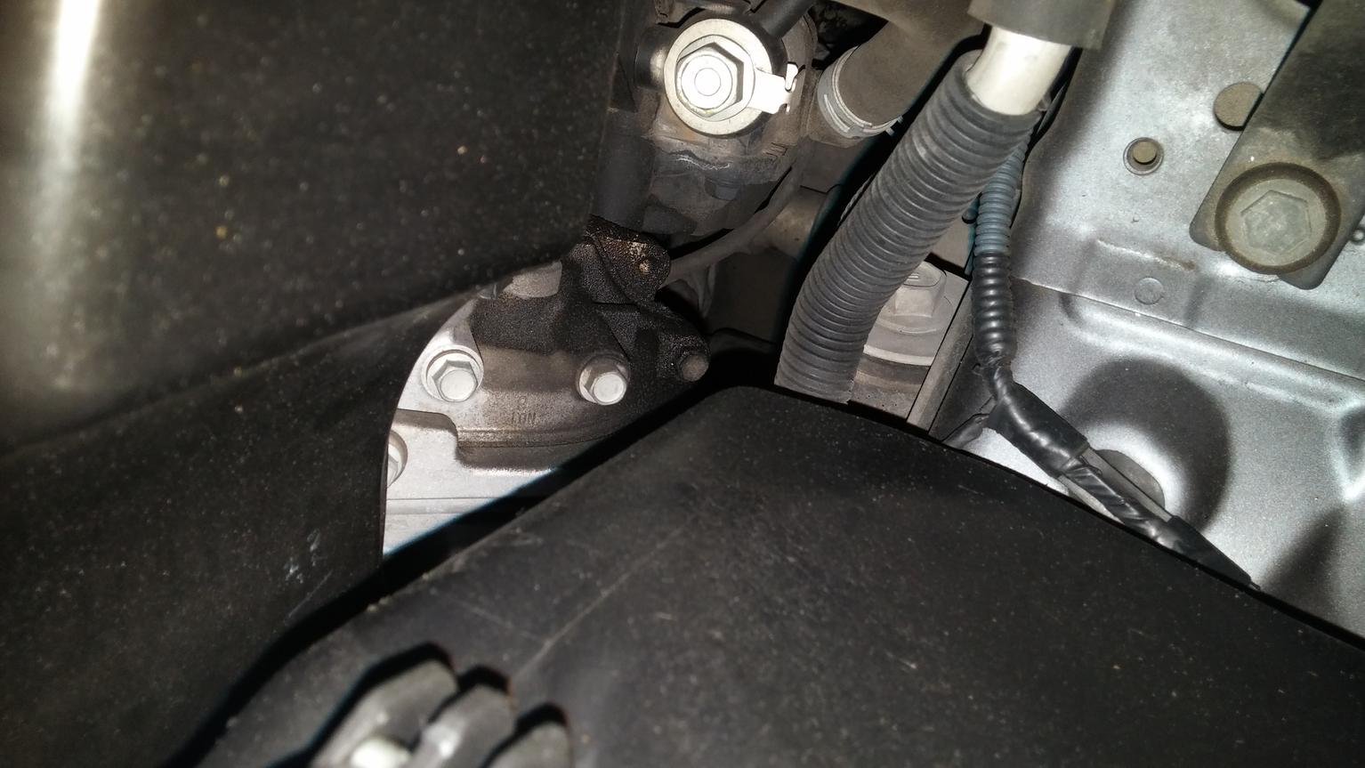

im curious, how can you tell they are leaking?
are they just dumping oil? being behind the cover the way they are, id expect it would be hard to tell, unless it was a very bad/fast leak. in which case, they should be change sooner rather than later.
Will post a better pic tomorrow. I took this picture a few days ago thinking it was the valve cover gasket, but had a shop tell me it's Cam/ crank seals.
I realize now that the picture above isn't the crank seal leak. The leak above is on the passenger side right above the alternator. I checked the timing cover area from the top engine bay and can't see any leaks. I will try to get a look from underneath this weekend as the shop who told me they were leaking didn't seem to want to take the time to show the leak to me.
