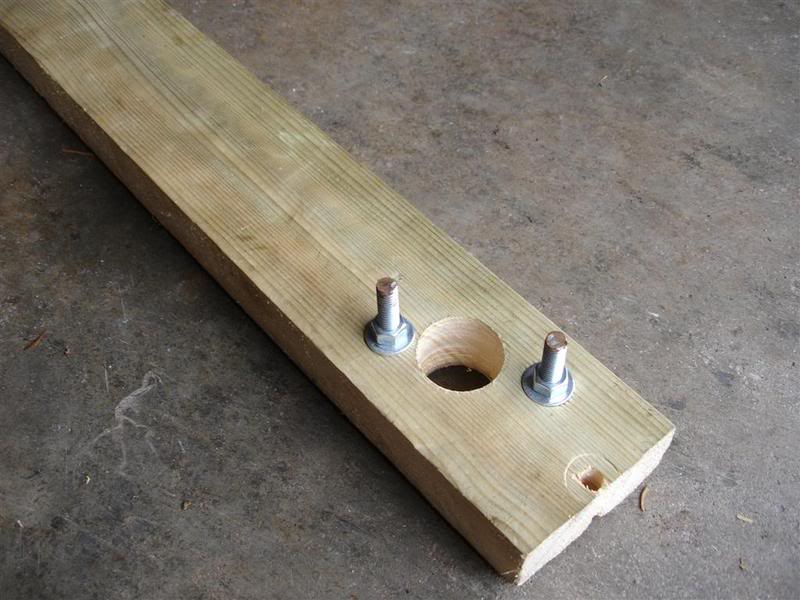

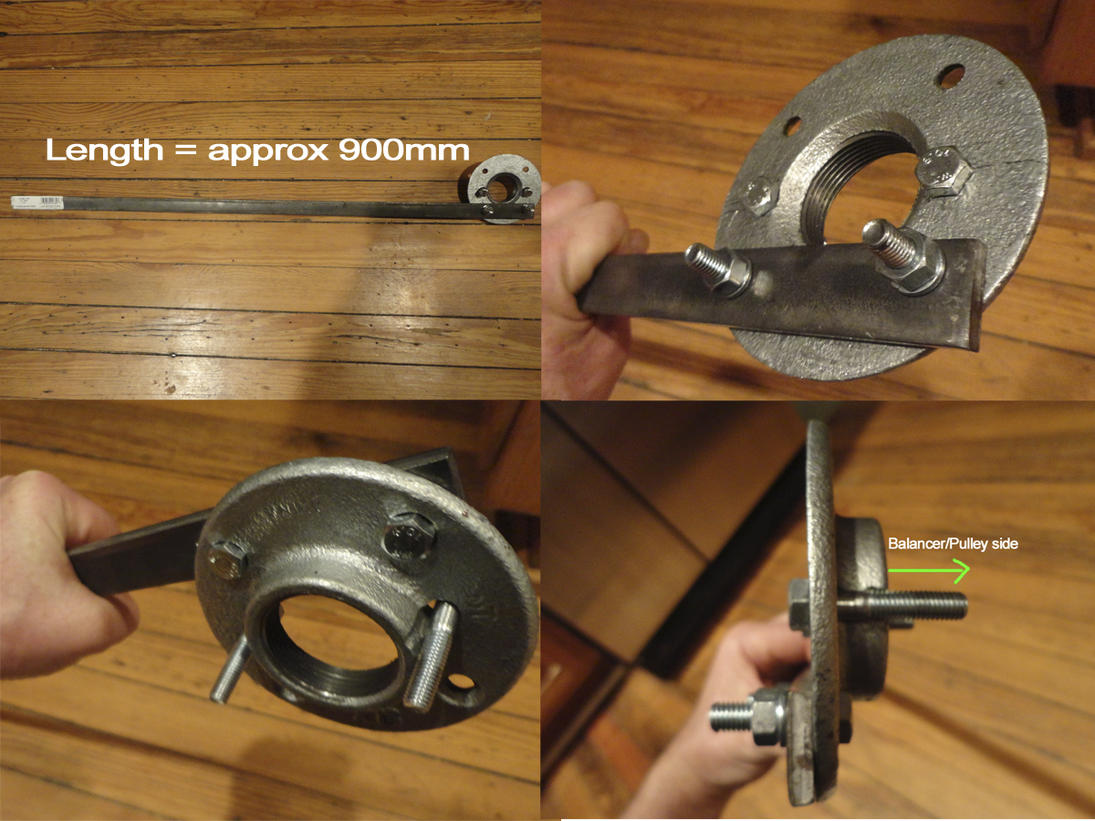

That bolt is on by factory w/ red loctite. I do advise a really good impact. If an impact is not available using a breaker bar and chain, or fab up your own SST as in the pictures I have attached. Good Luck.

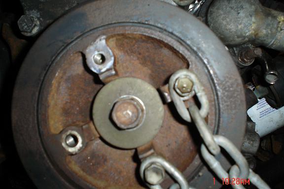

Here is an image I stole some time ago from another member that I thought was a good way to get the camshaft bolt out:
297_zpsk0ko0hqu.jpg~original
But seeing that you are pulling the heads, take off the valve covers, and there is a place on the cam that accepts a wrench (can't remember the size) so they won't turn as you break/loosen the cam gear pulley bolt.
