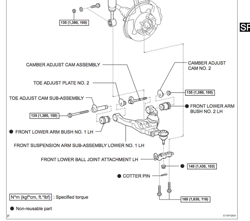

2005 4Runner Limited. Installing new strut assembly and need the torque value of the two bolts that bolt together the lower control arm to the lower ball joint. Is 116 foot pounds correct? They did take a 1/2 inch ratchet and a short cheater pipe to get them loose!

166 ft/lbs per the service manual

Weird, mine shows 118 ft-lb. This is from the 2006 service manual. The bolt feels like it can take 166 ft-lb based on how hard it was to remove, so it's probably OK to go with that.

Hmmm... A 48 ft lb difference between two service manuals. That's quite a difference when it comes to a front end part.

That's really odd..... When I had my alignment done, Firestone also had ~166 ft/lbs as the OEM spec for those bolts (2007 4Runner). My guess would be that Toyota simply downgraded the torque spec because 166 isn't necessary.
