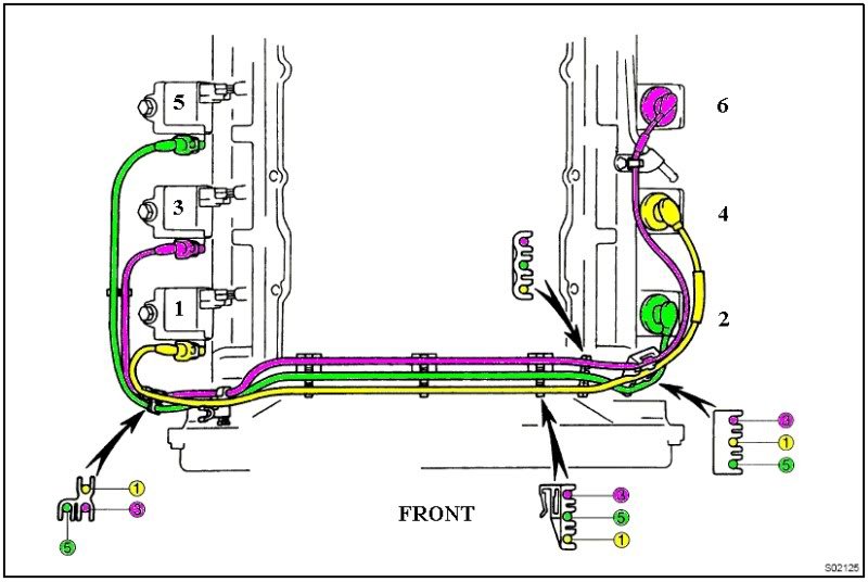

Here's the wiring diagram for the 5VZ-FE engine so you understand what coil pack on the passenger side corresponds to the cylinders on the driver side.

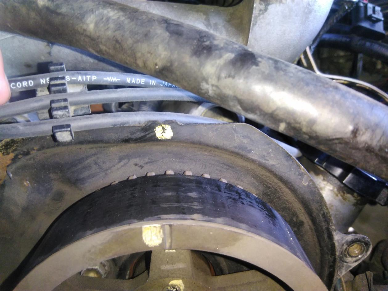

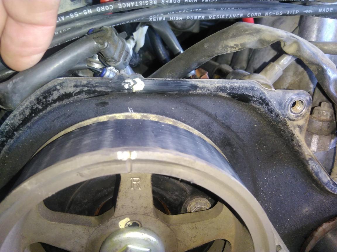

Tried to check timing marks today. I know that crank sprocket has its mark, but by the position of the crank pulley notch can I tell that the belt is off by a tooth or even three ? Shouldn't it be at 0 when cam gears are aligned?

If the crank is at 15° and the cams line up, there is a problem. The crank should be at zero and the cams lined up with their respective marks.
Time to tear deeper into it. Your crank is off at least 1 tooth compared to the cams - unless the crank pully has failed (slipped at the rubber ring) or the woodruff key fell out and the crank pully is not correctly aligned. Either way, start taking off those lower parts and get it fixed.

Corrected the timing marks. It was one tooth off at the krank. Car runs smoother and pulls better at low rpms. Cleared the fault codes and all is good within 20 miles range from mechanic to home. Will monitor if they come back again.
