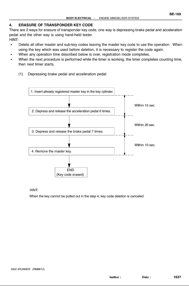

Page 1637 [Body Electrical section: BE-169] of the service manual may have what you need. (I have one that claims it is for a 2002 model...but I suspect it's the same.)
There is a procedure to erase transponder key codes.

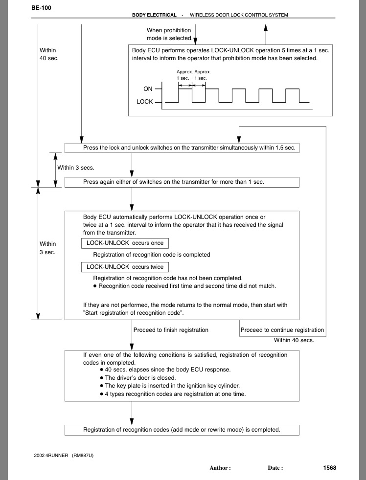

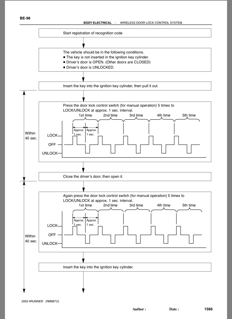

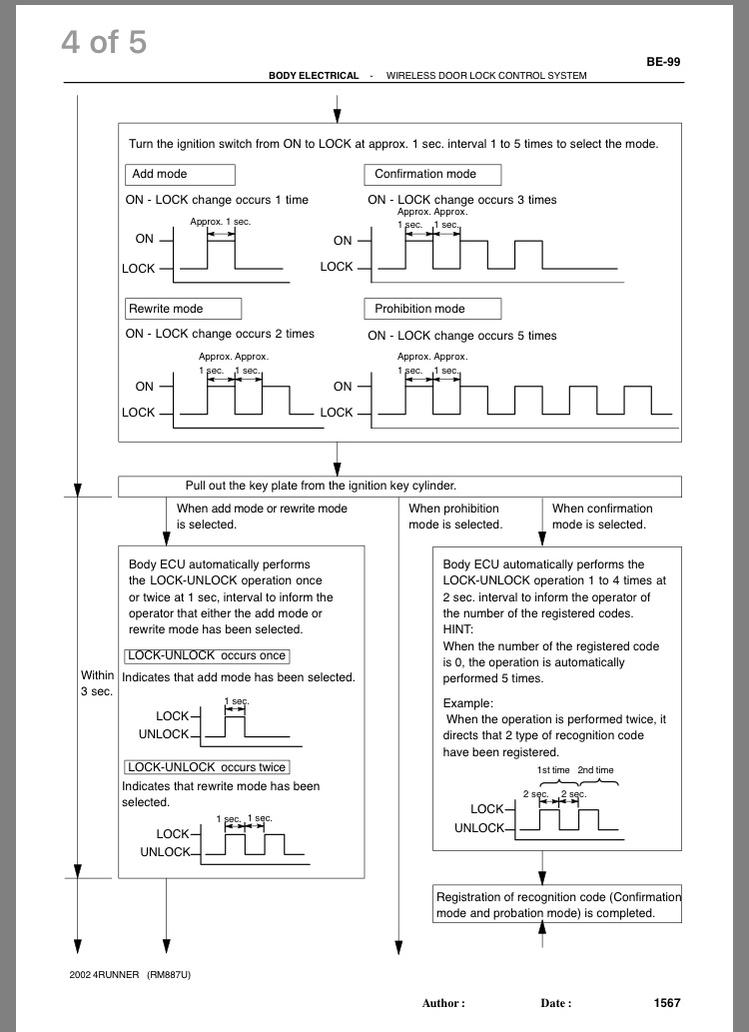

There is also a procedure to erase key fobs, it starts on page 1564 [BE-96]
Read those in detail, but if you maxed out your registered amount of keys and/or fobs, I think you can reset them all as long as you have one good master key.
[MENTION=151780]Airmapper[/MENTION]
Huh this definitely something I can try. I have attached pages of the manual you referenced so we are on the same page.
For page 1637: Erasure of Transponder Key Code
When you use a Master Key and perform these steps does it erase all previously programmed transponder keys? Or does it erase the key performing the steps?
Have you had success doing this?
I need to double check and make sure the key I have is a master key.
Yes that is what I was reading. Be careful though I'm not for sure it's what you need but thought it might be useful.
I've had success adding keys and fobs but I didn't have to try to remove any.
Above all else, if you have a master key I wouldn't try the erasure procedure with it. I guess you don't have any of the other keys to erase though?
The fobs shouldn't be as dangerous, if all else fails I think you can erase all and program them in again.
Ok so you are reading the manual as if this will delete all keys including the one used to complete the procedure?
Well it's a bit confusing. Reading it again, it sounds like it erases the code on the key used. If that is the case I don't know why it has to be a Master Key.
I also found info saying you can only have 3 "codes" but then it also says you can have up to 7 keys...?
It sounds like it's possible, but given you only have one good key it sounds a bit risky. You don't want to de-program your one good key.
My 4runner only had one master key and I was able to add 2 more without a hitch, and I know it must have had more at some time.
[MENTION=145585]Ikanaiak[/MENTION]
Bottom of the first page say:
"Notes: For factory remote keyless entry system programming information, refer to the vehicle’s repair manual."
I am currently all factory when it comes to keyless entry.
