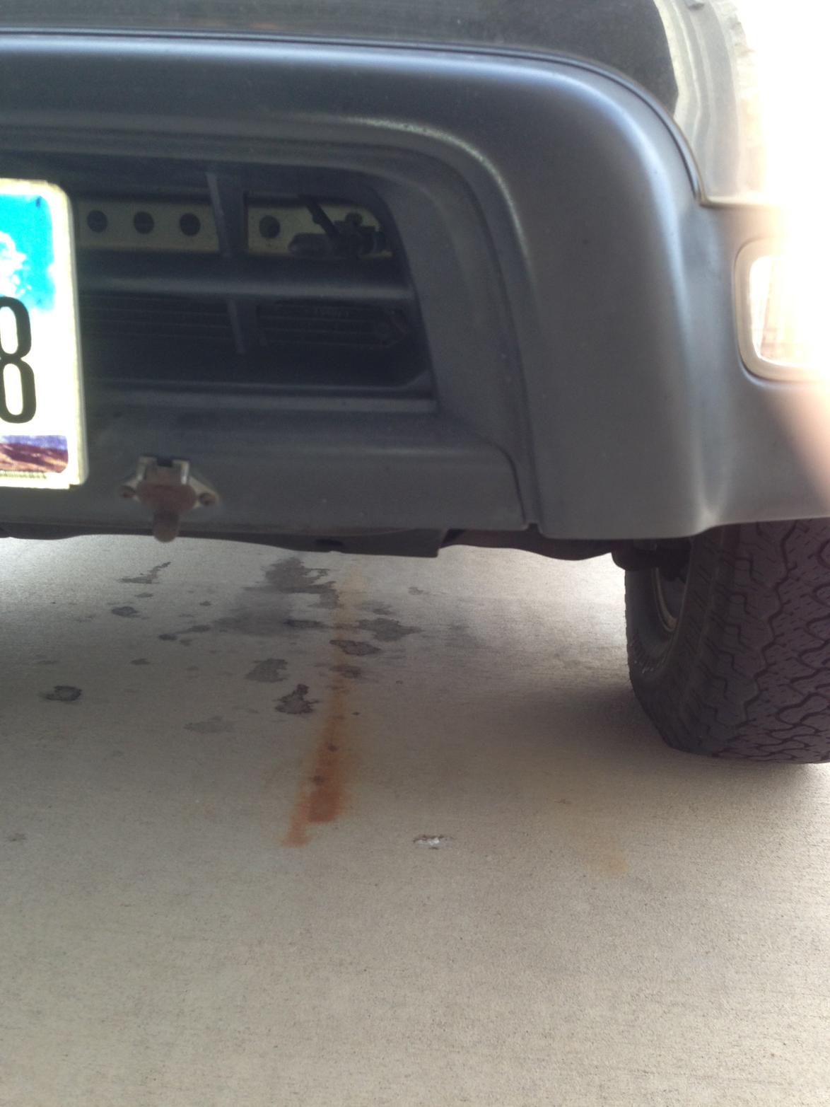

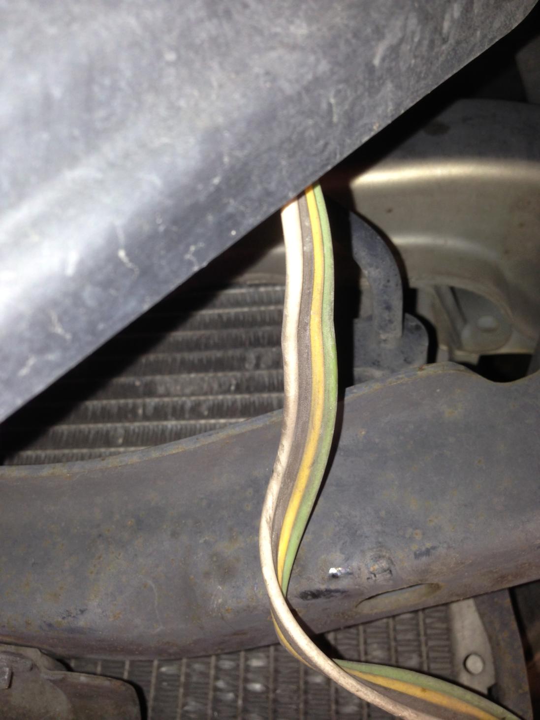

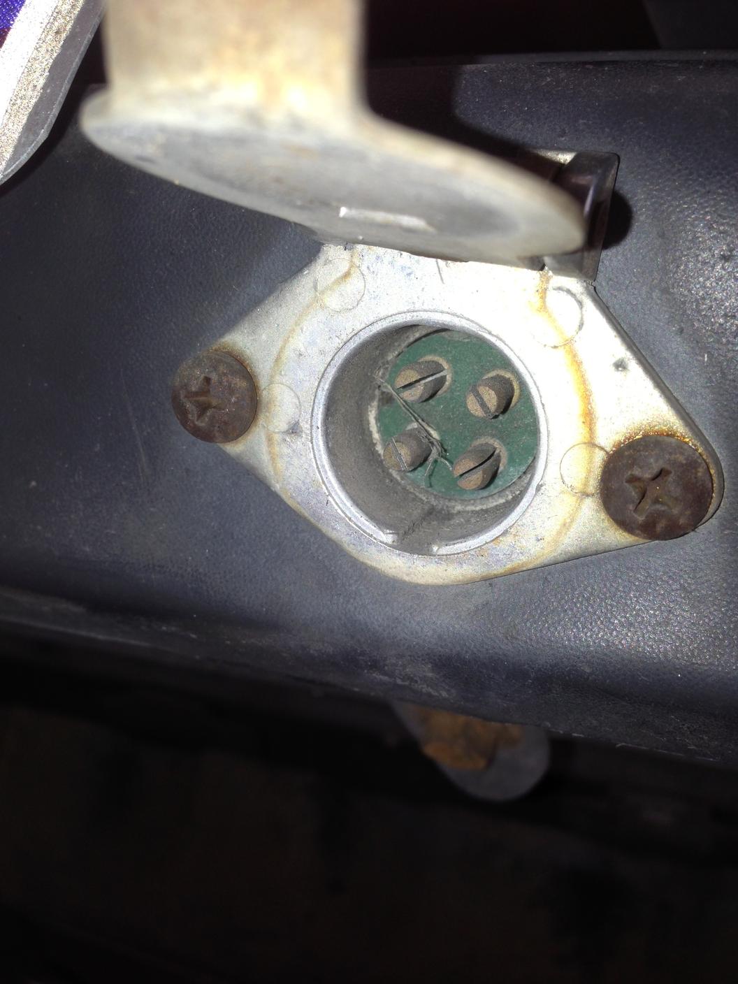

I purchased my 2001 SR5 4X4 4Runner in 2003. It had the item on the attached pictures, so i thought all 4runners had it and did not pay much attention to it.
The first picture is location (front bumber), second picture is the item with the lid open, third picture is to show colors of cables attached.
I asked a couple of friends and they do not know what it is. Could it be a connection to after market fog lights the previous owner had?

Unless they were towing a trailer in reverse, yup. That's a 4 way round connector for trailer lights. In this case your truck was the trailer. :D
^^ agreed. Looks like a previous owner may have hauled it behind a camper or something. That wire looks like typical trailer wire.

we had the same thing on our Rav4 so it could be towed behind our motorhome. An extension cord of sorts hooks the trailer connector of the motorhome to the plug on your truck and then your lights and turn signals work with the motorhome's.... Its pretty common, and defiantly aftermarket.
Any evidence there was ever a winch on there? It could be to plug in a winch remote control.
You need 4 pins to reverse a motor. Fog lights would be done with 2 pins. Have you traced the wires to the other end?

Wiring color indicates it's a trailer setup. As stated above the 4runner was probably towed behind something.
Best way is to trace the wires.
