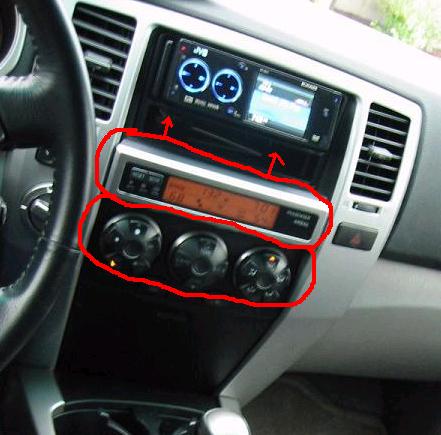

That might sound like a strange question, but in order to better fit a touchscreen monitor in the center of my dash, I'd like to see if I can move those two things UP a few inches. See pic below. It looks like they are separate pieces from the (silver in a SE) plastic center surround, but I don't know if they can be removed and moved. I have room below my head unit if they can go there.
I could tear out the dash and find out, but it's cold here and I'm lazy. Plus maybe either someone has done this before, or their dash is already pulled apart and can check.

Thanks..... that does help.
Looks like a good news/bad news scenario. That piece is easily removable, but it looks to be DEEPER than I originally thought. I might have to dremel out a section of the dash kit that holds in my head unit to get that top section to mount properly.

From what I remember the last time I had everything taken apart, this may be possible, but you may be adding a real PitA to your project by doing this. I had someone break into my car recently and try to steal my head unit. They did not get it, but managed to do some damage while trying to pry it out. I will have to take it apart in the next couple weeks and I will look at what it will take.

if you go on World-racing.com and look at Christian Rado's tow vehicle he has completely relocated the a/c controls.
I MOVED MINE LIKE 3 IN DOWN I HAVEN'T BEE ABLE TO REALLY CLEAN IT UP. bUT I CAN HAVE SOME PICS UP TOMO. i REALLY LIKE SEPERATE CONTROLS FOR THE HEADUNIT. iTS MUCH EASIER TO NAVIGATE THROUGH CONTROLS. I ALSO DIDN'T HAVE THAT MANY CHOICES FOR DOUBLE DINS AND ALWAYS HATED THE POCKET THAT DIDN'T FIT ANYTHING.
nh00gts, that dude's HVAC mod is top notch. Thanks... that helps out alot - now I have more options than I thought.
