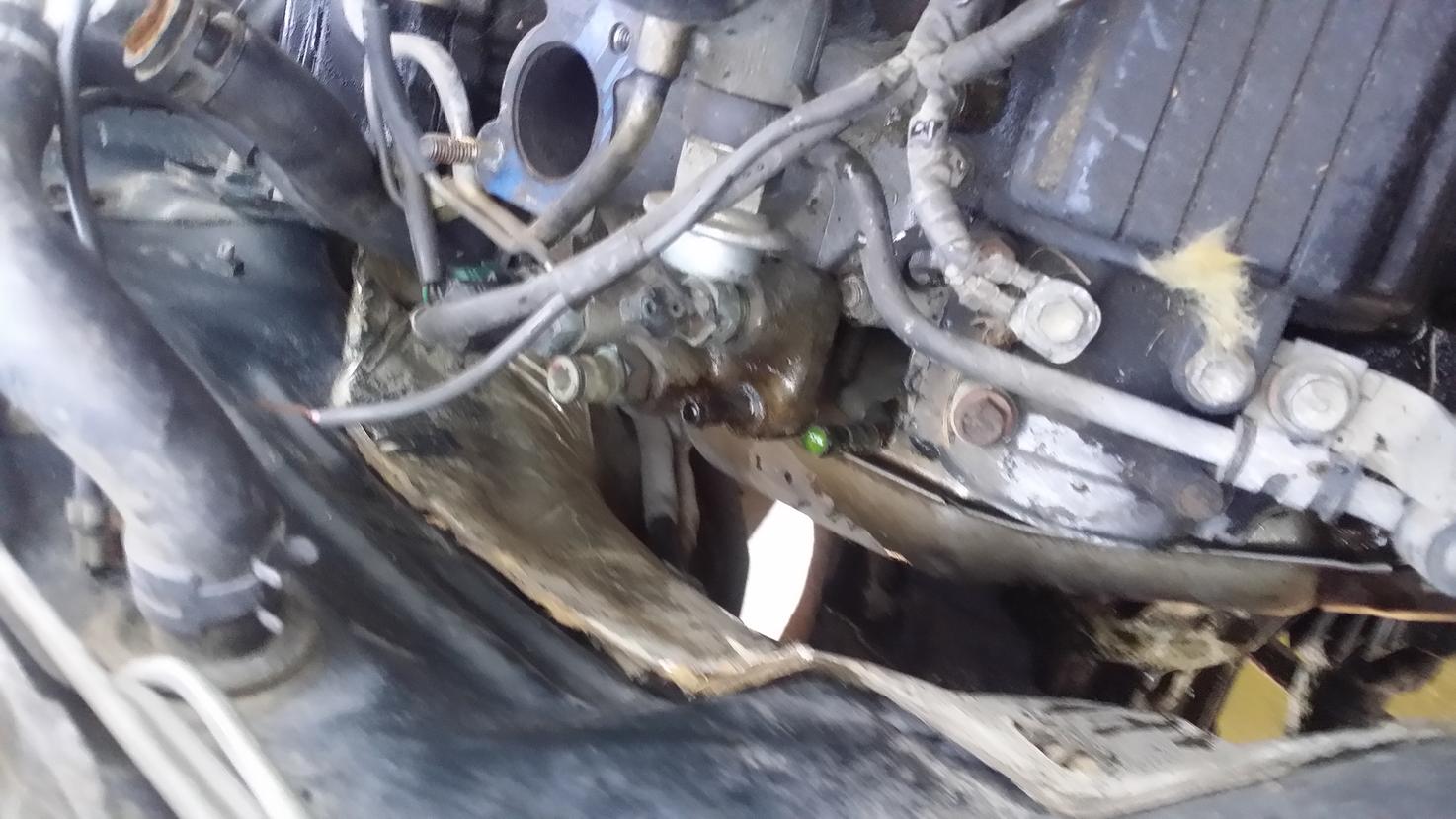

The post I linked to is one I found through a search of the site (I used the search function - hooray!!!). The piece shown in the linked post...you say that's under the intake? If so I'll have to dig deeper. That linked post just said the intake plenum would have to be removed. I removed the plenum from the donor vehicle, and thought I traced the line to the back side of the motor, but I've been wrong before.
My leak appears to be right where the guy is pointing to in the linked pics. Looking again, I see how that tube makes a 90 sweep and goes toward the front of the engine. I haven't been able to find the part new yet, but I'd rather put in new than old, of course. My search continues.

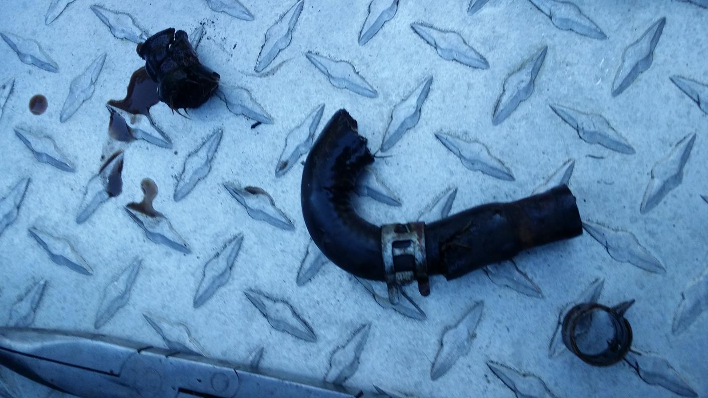

Found my leak! I had feared and prepared for the worst, but lucked out. It was just a hose, the inverted U shaped one at the back. I still had to pull the plenum to have room to work, but at least I didn't have to go any farther.
I may get to take it out this weekend after all...

Not sure if you already have this under control or not, but that hose can be found online. However, if you have a good parts store nearby (not the cheapies) they may have something in stock that matches up. I worked for Napa for three years, and still have some good buddies at the stores close by. I know I matched that hose to one they had in stock that I had to cut some length off of, but I can't find my notes for the part number. A good parts guy can take you back to the molded heater hoses to help find it, or they'll be good enough to find it for you.
Some of the heater hoses are really OEM due to the bends. But that one should be okay to match up.
Thanks for that, sir! I just bent some straight hose over and made the loop. I think it's long enough to keep from kinking, and I don't think there's a huge amount of flow there anyway. It's back together and loaded on the trailer, hoping for a fairly early departure to Turkey Bay tomorrow. Rain tonight, but should clear off my morning. No heat as yet, so hopefully it won't be too cold for the wife.
Glad to be of help. Thinking more about it, I may have done the same thing on my first project. Or maybe it was the molded PVC hose. :) Either way, as long as it doesn't kink, you'll be good!
