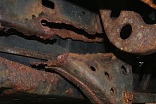

Can this frame be repaired?
azcat90
Does anyone have an opinion whether this can be fixed?
Yes, with fire. Then you get money from insurance. Other than that, it's toast. The rust you see if just the tip of the iceberg once it's gotten that bad.
Had the same thing happen to mine, i took it to a local welding shop and they fixed it for $150. As long as there is still some good steel under the rust it can be welded

It can be fixed go to the junk yard find a 4runner of a similar year without rust buy it and do a body swap. Other then that its burnt toast.
Thanks - that's what I am hoping for... Its a 97 with 277K miles on it so my minimum liability insurance would not cover uh.. mayhem.
I would call around and get some quotes from welders and stuff, a local body shop did mine and like i said as long as there is still some good steel under the rust your in good shape. Good luck
Will do, thanks! I'm hopeful - my frame is not near as rusted as yours was...
Hard to judge just off that one picture. It can be fixed, sure. But you might just be delaying the inevitable. Give the rest of it a really good looking over before you invest any time or money into fixing it. With it being that bad, I'd be willing to bet you have other spots that are rotted through as well.
Uh, I'd be very hesitant to just weld it back together and call it a day. Millerad is correct, if it's rusted through that badly there, then you are certain to have similar levels of rust elsewhere on the frame, and it is just waiting to fall apart.
And $150 is not going to do it... That guy must have been welding for crack money to do that work for that much. No self respecting welder will take that rusty frame and just weld that thing back together like that and let you drive away.
AZ cat, you need to seriously inspect the rest of the frame, from the front wheels all the way to the rear, including looking inside the rails. Better yet, pay a good welder or a good mechanic $50-100 to inspect it closely. It will be worth the money to have an educated opinion on the viability of that frame. And start emotionally preparing yourself to have to straight up send that thing to the junkyard, because you very well may need to let it go if there is indeed that kind of rust on other places too.
And this warning is coming from someone who has I think one of the bigger rust resurrections on this forum. See the link in my sig for that. I would probably junk that thing. It's at nearly 300k miles, it's had a good life.
What advice would be worse than telling someone they need to replace their entire frame when a welder could fix that fairly easily?
Worse advice would be telling him he can weld it back together on the cheap only to have the other side break off 100 miles later on the highway killing his family, or hitting another car. I'm not saying that WILL happen, but it is not far fetched to think that he will have similar levels of rust in other key areas of the frame, and therefore near the breaking point. And that thing breaking off at highway speed could very well cause a severe crash.

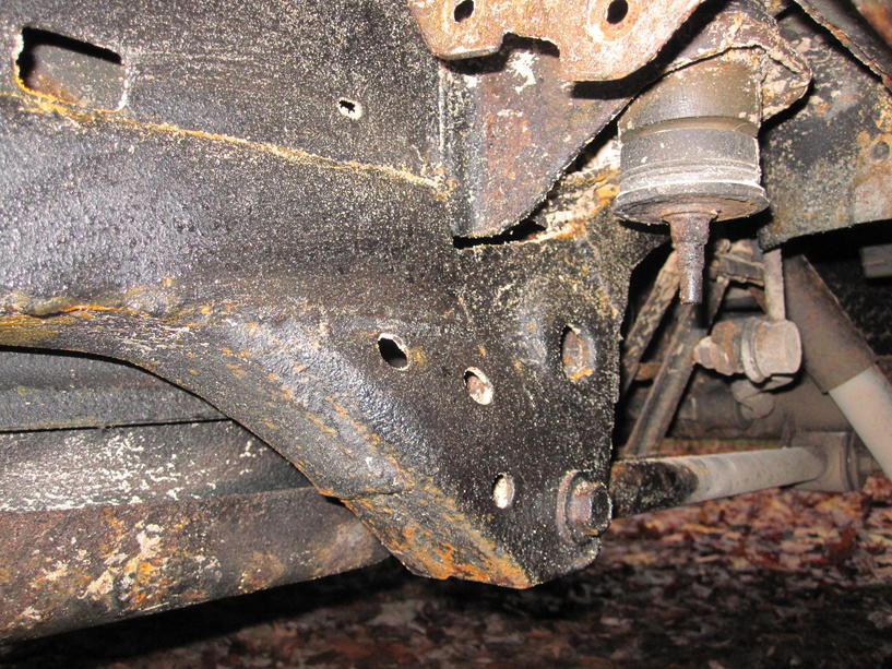

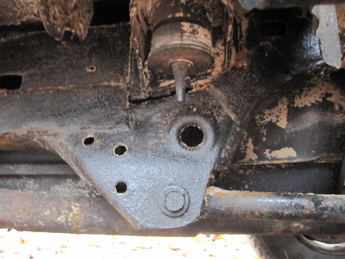

The OP'ers picture looks like the weld failed where as the following bracket failure looks to be extreme rust.
To the OP. If the frame still looks intact, no holes or rust, it might be worth having that section of the frame cleaned and reinforced. If the bracket is also in good shape some material could be taken off, reinforced and welded back to the frame. If the bracket is gone one could be made (i've seen a few) but it's not a cheap fix.
How does the passenger side bracket look?
Usually the passenger side is one that get's rusty and fails first. Something about being next to the exhaust whereas the driver side is more protected by the gas tank.
