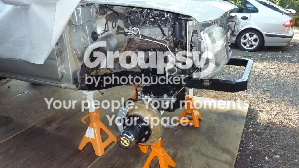

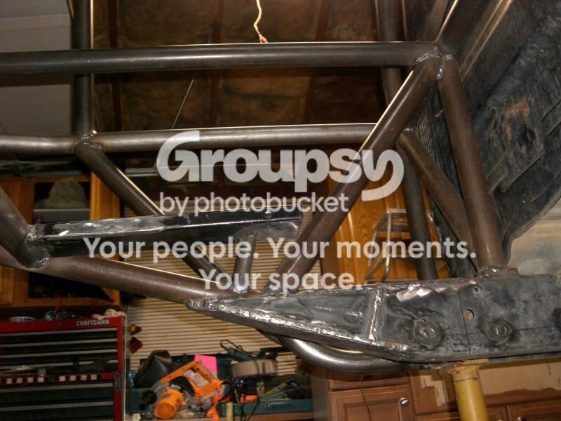

Long story short, just go to a competent welder that will clean up the frame there and reinforce and reattach the link bracket. Worst case if the bracket can't be saved, any good welder can fab up a new one easily and burn it in. It will cost you a little bit of cash but the end result is worth it and cheaper than finding a new truck!
Just some examples of frame work by competent welders
Yes I know I picked extreme examples, but I just wanted to show what can be done and it's not super duper rocket science to attach a link bracket to the frame that rusted at the weld

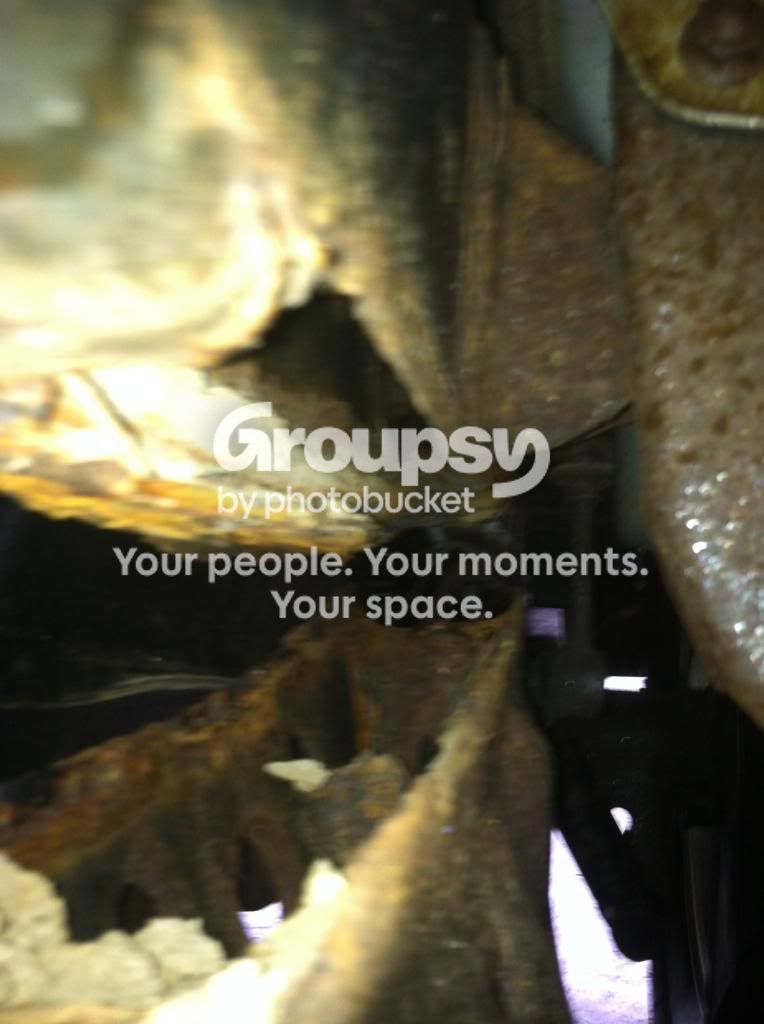

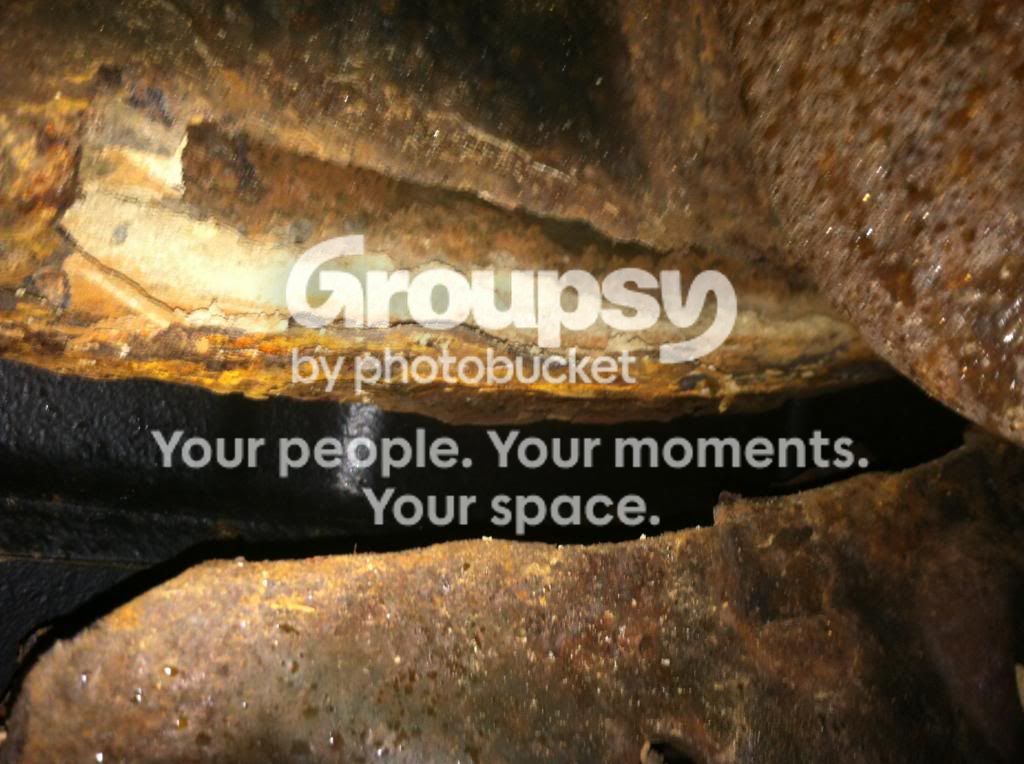

More pics
I finally made it outside and took a look for myself...
It is worse than I thought from previous photo...
Close up:
Looking towards rear:
