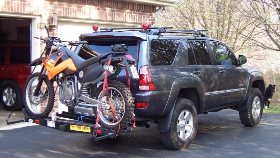

Yes you can. 300lb KTM LC4e with a Versa Hauler. I have OME 3 inch heavy duty springs - no sag with the bike but sits ass high unloaded. Look at the rear fender gap. Nice.
I hauls so easy you forget it's back there. I run tow lights as well. I have run this set up since I got the rig - 5 years this fall.
The blue strap you see going across the bike connects from the tow loop through the bike to the other frame rail. It stop any side to side play.

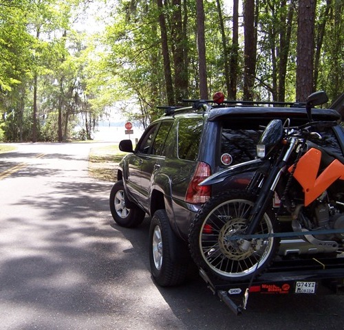

I ride the KTM where ever I want - it's like a 640cc tractor! Plenty of grunt to haul my fat ass around. I take to Ocala a few time a year to ride with the Sand Fleas (advrider.com). The pix was taken at Ocean Pond near Lake City on one of our outings.
I hit the local spots as well like Red Hill behind Embry Riddle or off Williamson behind ATC or across from the car dealers off LPGA. I ride with Daytona Dirt Riders as well.
My personal fave is to haul it up to the mtn. of western VA where my parnets used to live. I'll take my 1st trip to Tellico in 2 weeks for some off road fun. I like hill climbs and more techanical type stuff.
