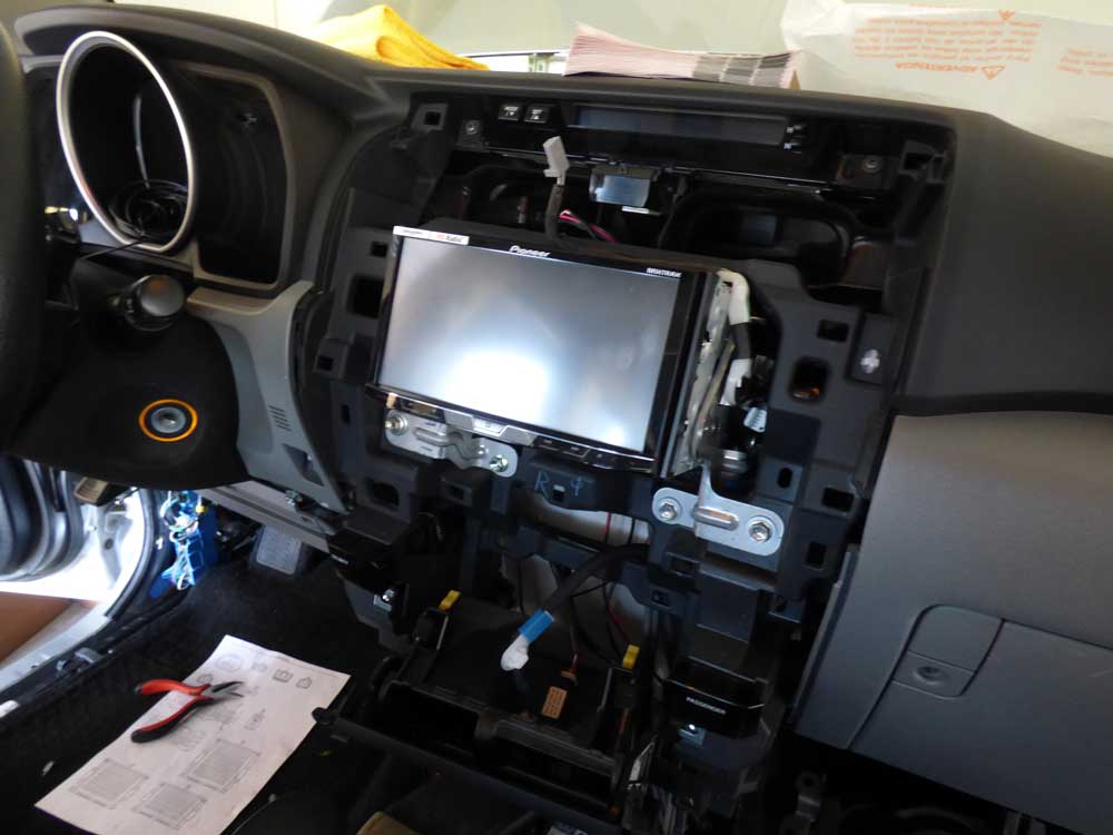

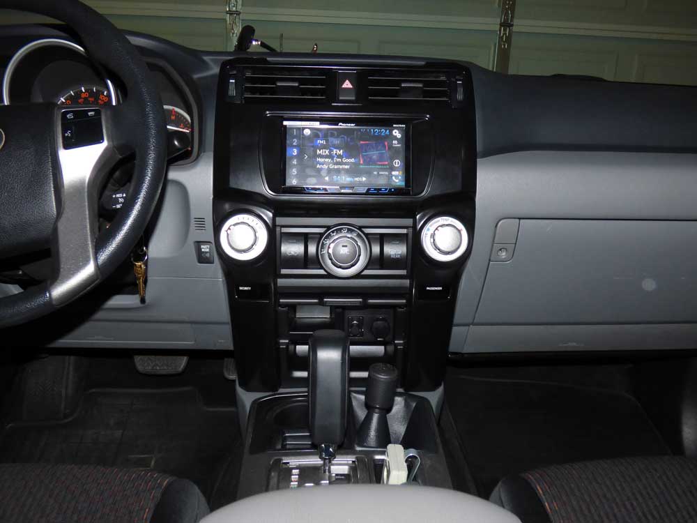

Why yes you can...
Pioneer AVHX5700BHS

Where did you pick up that dash kit? I just did an install in my 2014 T4R and use the Scosche one, which is silver. The paint is very rough, i.e, it's not slick and shiny. You touch it and it loses the shine. You touch it twice and the paint starts to fade. Going to try to wax it to see if that keeps it from getting worse. Love the black look of yours.
It's a Scosche kit. It was smooth though. Maybe the ones for the newer models are textured.
I just used Krylon Fusion for plastic and a Satin clear. I wish I would have used the matte or flat clear (couldn't find it) as the satin is still a little too shiny. I will redo the clear someday. I also painted the lower trim pieces below the stereo. Plan on doing the rest of the silver as it scratches very easily.
