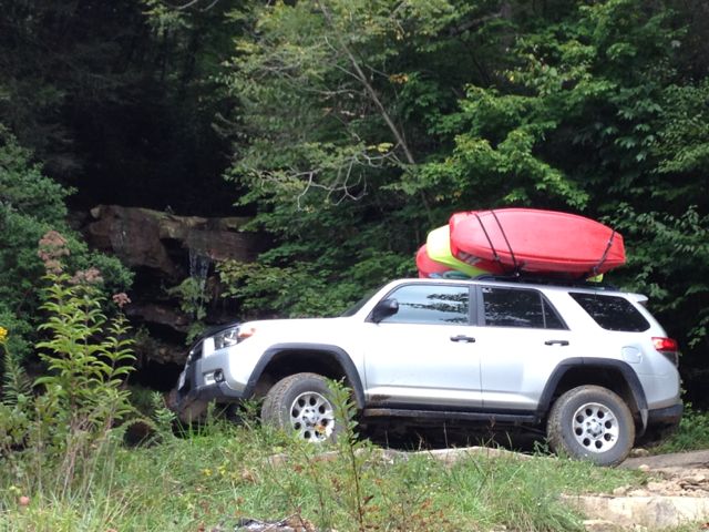

I have loaded 6 whitewater kayaks and driven 2 hours on Yakima 60" cross bars and factory rails. Each boat with gear stuffed inside is about 50lbs. so around 300 lbs. with no problems. Here's a photo with some smaller play boats where I drove down a half mile goat trail over rock shelfs to the put in and parked right next to the Gauley River in WV, no problems!

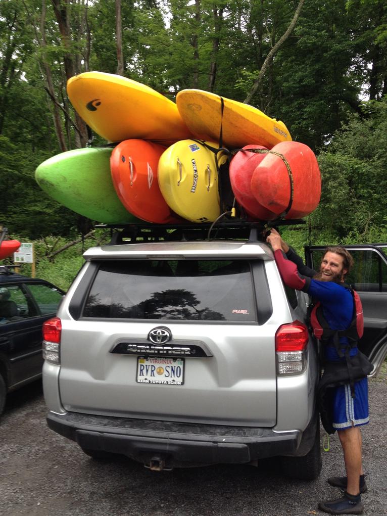

another photo with 7 boats, 350 lb!
forgot I had this one, 350lb +

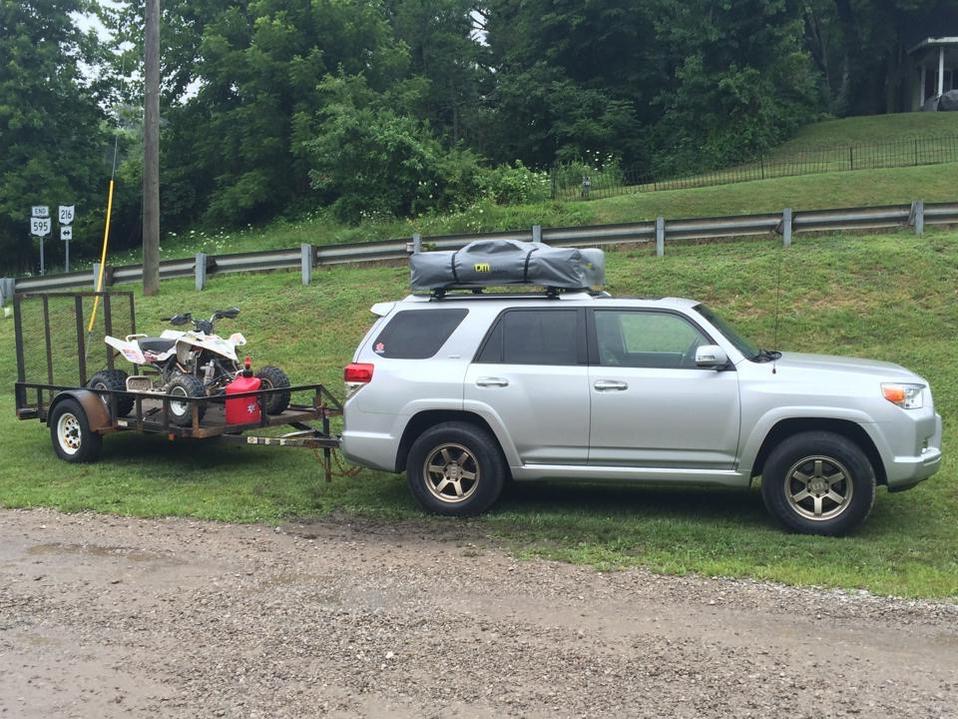

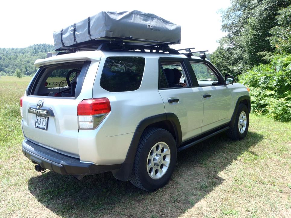

Previous owner of my truck have run 4 years with a RTT. He use Thule bar over the factory rack.
This is a picture of it.

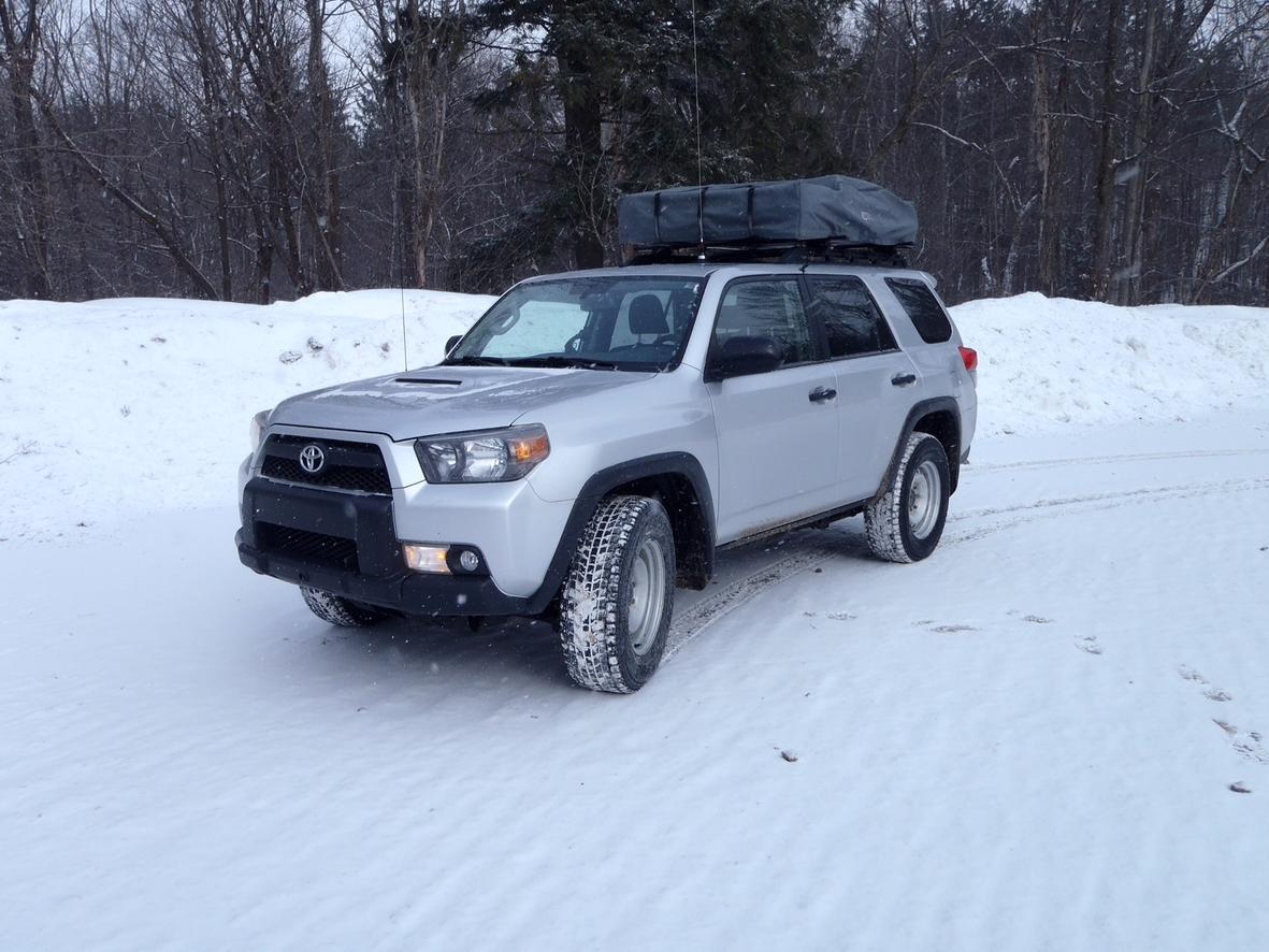

works like a charm, just sits a little high, but nothing to be concerned about.
Ran mine like that for 8 months or so? I just took off the RTT for winter, but will go right back on in April with the same mounts.
