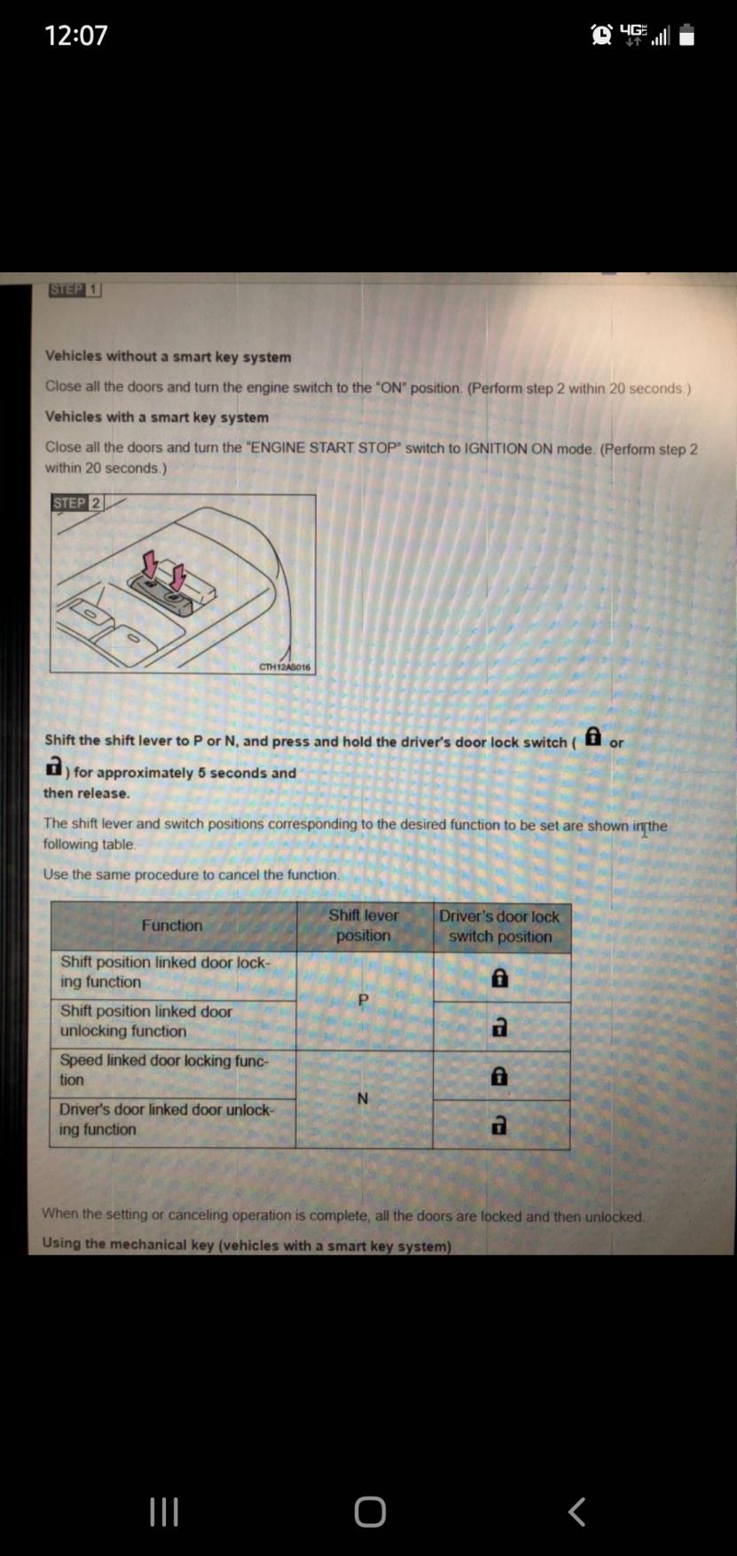

Can you program automatic door locking on a 99 SR5?
repo
I'm curious if I can have the doors automatically lock when shifted in to drive or going above 10mph or whatever like you can on a 5th gen SR5? I have keyless entry but not the security system. I couldn't find anything in the manual and conflicting info when I searched about if only the limiteds have this function or only ones with RS3000.
Yes. You can find the how-to online. If I find my hard copy I will post it. I did this to my 2000 as it was not done when I got it. It is almost the same as programming your new key fob.
I think this is what you were talking about. I apologize for the quality of the pic but if this works for you you saved yourself $130 for the 1HR labor rate at the dealer. Good luck.
