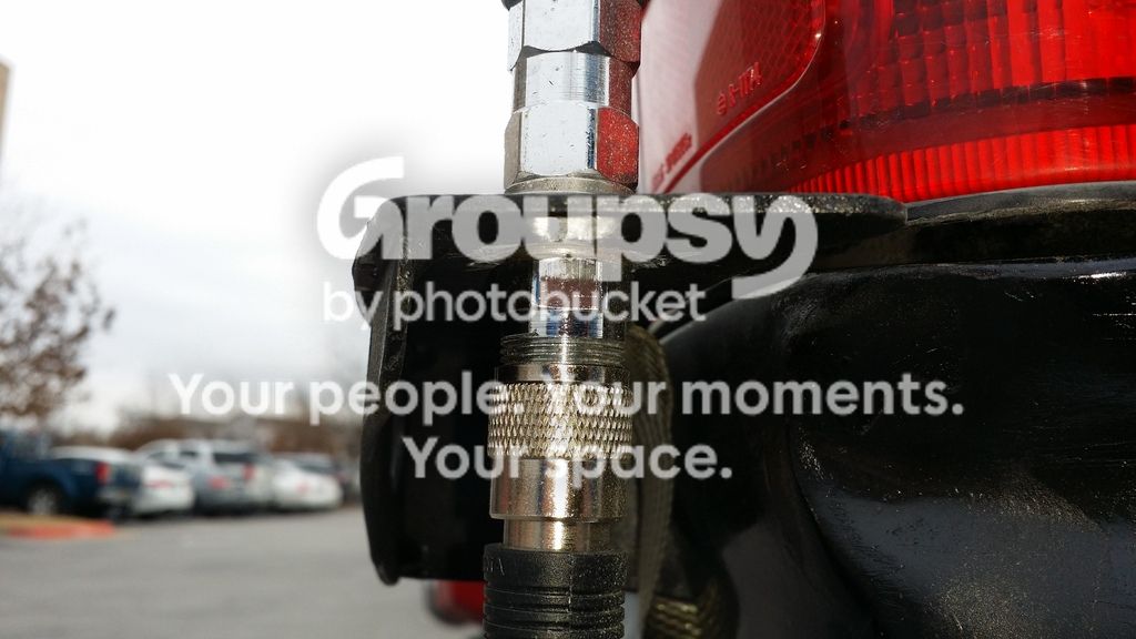

here is my set up.

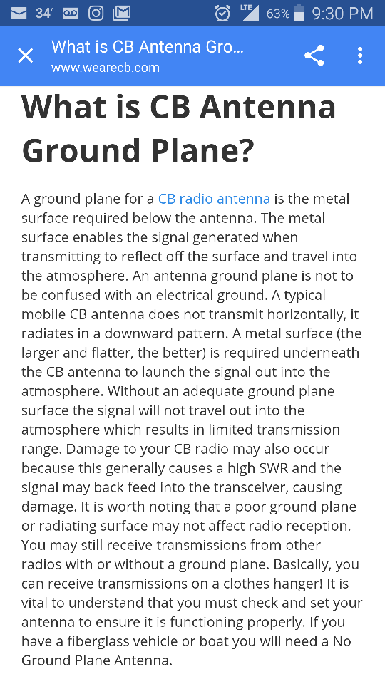

Do you understand the concept of a ground plane? (If not see below) Thats not how radio works. I am sure other people have gotten those side brackets to work but i doubt you are creating an effective ground plane.
If no ground (plane) how will the radio effectively output power? A magnetic mount that you only deploy when trailing would be largly more effective than what you're working with in that pic.

here is my set up.
This may be a dumb question, but did you check to make sure the fire ring coax has the lip facing up towards the mount? If it was reversed (pointing down) it would cause the coax to not be grounded.

I noticed in the instructions that the fire cable has one side that has more of the plastic washer showing. And it said to have that side against the plate. Basically a small gap. So how would that ground it ? Right? I had this thing pretty tight so know that fiber washer built into the fire cable is basically flat.
Should I try running a small wire from the bolt that screws everything in to chassis?
Correct, the plastic washer that's built into the fire ring coax should be faced up against the bracket. The bolt head on the under side should be flush against the side of the fire ring coax with the metal ring, not the plastic spacer. This is what mine looks like (sorry, it's dark when I took this just now).

For testing purposes, don't be afraid to remove the spring to verify SWR. Did you have any extra pieces when you were done? It seems like you are missing a nylon washer on the bottom side of the antenna mount.

Make sure the underside of your drifter mount where it contacts the cable is bare metal. Also make sure where the drifter mount interfaces with the vehicle body is bare metal as well. Check continuity between the mount and the - terminal on the battery.
Also ensure that the center barrel / stud of your antenna as it goes through the drifter mount isn't shorting on the mount itself. It needs to be perfectly centered in the hole and insulated either via airgap or nylon washer from the mount.
Mine would not stay centered, so I hogged the hole out to 1/2" ID and bought a nylon washer with a deeper "barrel" on it. This prevented the center stud for the antenna from contacting and grounding out on the mount. Not sure about how your cable works, but on mine (a more traditional setup with a mounting stud on the underside of the mount instead of the firestik cable you're using) this helped a great deal.
FYI I'm also using a drifter mount and in addition to scraping away the paint/rust proofing I sprayed on there, I just bought a $5 braded ground strap with 1/2" eyelets and slipped it around the outside of the nylon washer's barrel and sandwiched it between the drifter mount and the antenna stud (on the underside of the mount). I connected the other end to the frame. My SWRs are ~1 and I get ~5 miles of Rx/Tx on a 4' Firestik. Before good ground plane my SWRs were 4+ and I had almost no Tx and very short range Rx with lots of interference.
