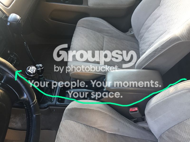

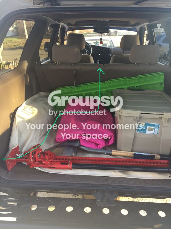

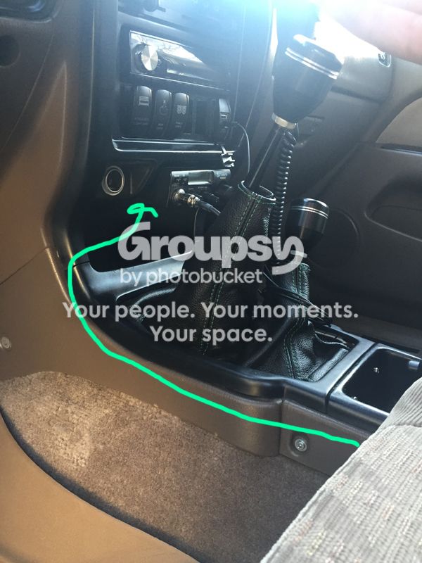

Here is how my wire is ran....
from the back going towards the center console/cb radio
running along the side

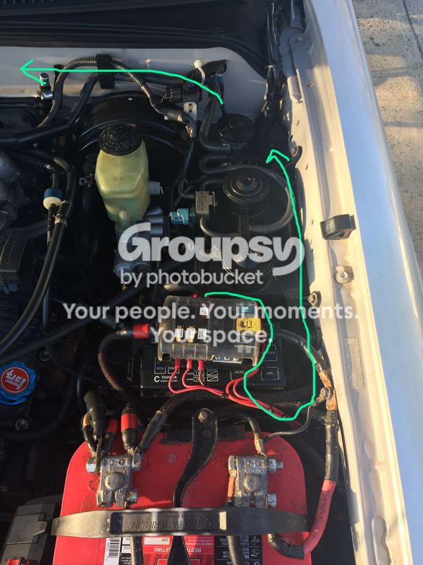

And this is how its getting power.
From bluesea fuse box, going out through the oem grommet. Very clean installed
