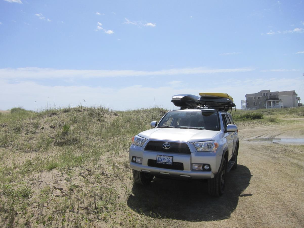

I know its not a canoe, but its as much of a sail....
I'm running Thule aero bars (worth the extra money over square or round bars) with the narrowest Yakima box I could get and Thule SUP racks. The reason for the SUP racks is so I could mount them outboard of the feet. The box is also mounted partially outboard of the feet.
Only problem I had was when offroad getting bumped through big ruts in the dunes, the box which was jammed packed half slid off the bar. Other than that it was fine when empty and during the 2500km highway drive.
