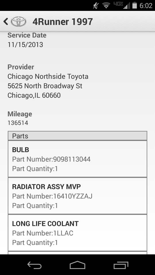

Thanks for all the good advice on my nondescriptive thread. Not an expensive or even all important operation (thread), but very helpful to me. Update; the radiator was changed at 139,000 on 11-15-2013. I bought the truck last July with 158,800 so I guess it's about ready for a flush anyway. I will switch it to red after reading the ingredients of Toyota red vs. Prestone and others. Still a mystery to me as to why Toyota would put green coolant in instead of red? The part # on the work order for the flush was Toyo red...also, I seem to remember my '95 celiac GT had red. Anyone known when they switched to red?
