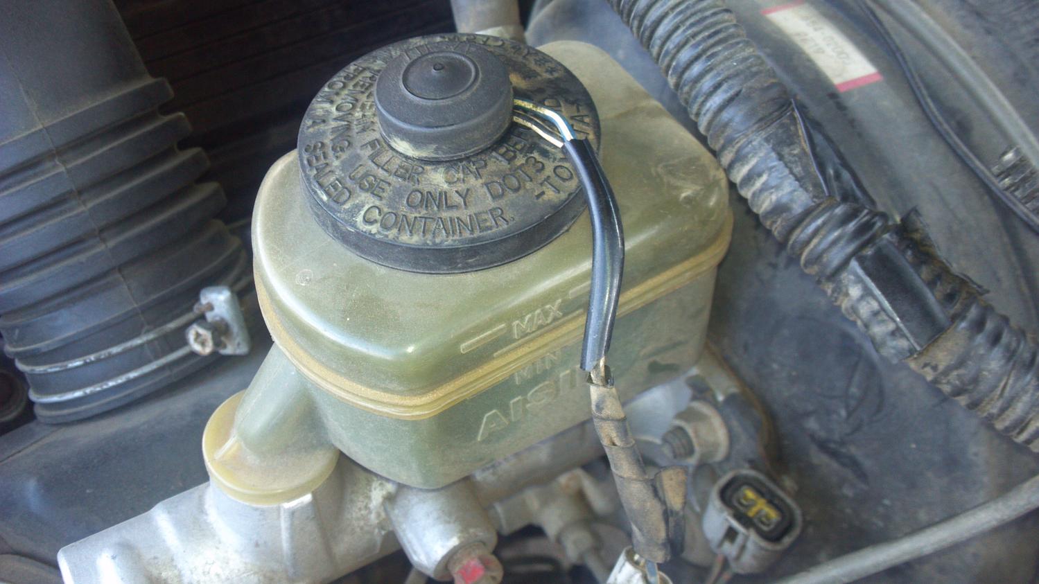

I am looking for a new master cylinder cap with the fluid level sensor. turns out mine is bad and is keeping my brake light on so i cant use my cruise. anyone know where to find one of these? i have searched and found nothing. all the parts places i have checked (including rockauto) dont have them. i really dont want to buy a new master just for a cap.

you mean the switch on the parking brake? its fine. the brake light is dim. can really only see it at night, and gets bright when i pull the brake. i got it to turn off for about 5 min after moving the wires around where they go into the top of the cap.
when this problem first came up, i was driving at night and the light would dim in and out randomly and it would kick off the cruise
Got a picture of the harness connector? Diameter of the reservior opening? I'm parting a 22RE truck, the caps might be interchangeable.

i will get a photo off it later today.it should be interchangeable. its a 92 3.slow 4x4 if that matters.
didnt these second gens get larger bore masters comared to the first gens? i think i remember reading about it somewhere...:nerd:
i dont have a tape measure or anything to measure the cap with. hope this photo helps. also, i unplugged it and the light went out.
