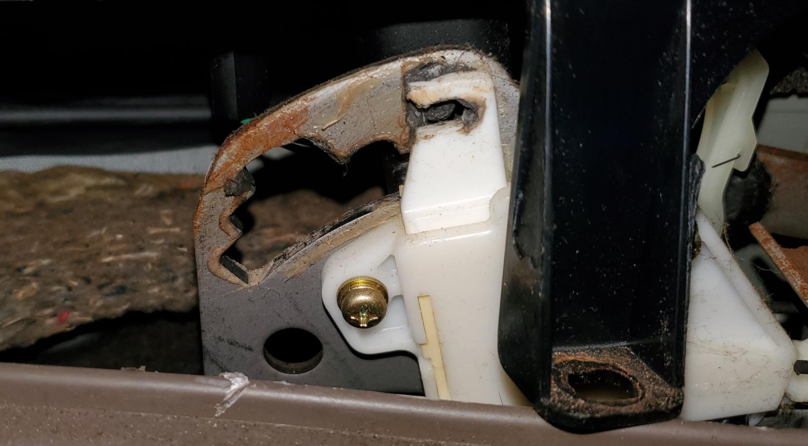

Does anyone know what the part number is for this white switch? I've looked at several diagrams online but the drawings are so poor, I'm not sure.
The switch is not moving to the fully downward position, causing the pin to jump behind the switch when moving it into park, thus causing my key to stick in the ignition.
Thanks in advance.

That was an assembly/alignment issue on my '99.... same, exact, problem with keys being trapped in ignition and pin being on the wrong side of the switch. Just took paying attention to assembly to get it sorted. Pretty sure I didn't post anything about it because I felt dumb at doing it to myself, and it's been a couple years so my feeble brain doesn't recall the details. I feel like it was something lower down, maybe on the Other side??? take a closer look though, I doubt you need the switch replaced.

Thanks Brian. I'll take another look and see if it's an easier fix than replacing that part.
