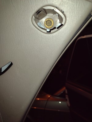

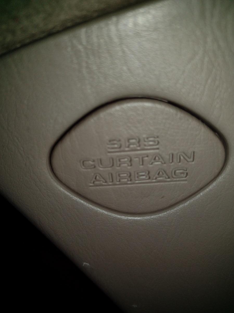

This piece is missing from my Driver Side interior trim. I know some of you guys are wizards at finding obscure part numbers. It goes just behind the back door. I can't find it on any of the parts diagrams I have. Any help will be, as always, appreciated.

It appears to be a "quarter panel trim cap, w/overhead air bags - LH"- 62522-35020-B0
(B0 is for stone, E0 is for fawn interior. I can't quite tell from your picture due to potential lighting differences).
It's hard to find a picture of it vs the ridiculously vague parts diagram image, but it looks like it is partly secured under that bolt and has a leash that hangs onto the cap which you're missing.
Quarter Trim Cover Left Hand #62522-35020-B0 | Autoparts.toyota.com
Thanks. I saw that but would never have made the connection. You do good work. I will get my dealer to order one in & see if it is in fact what I need.
