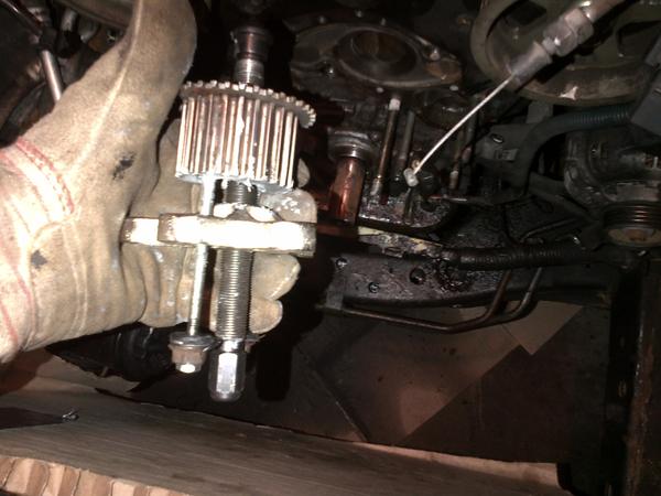

Crank Timing pully stuck
I spent most of today trying to remove broken crank shaft timing pulley. I bathed it in PB Blaster and attached Craftsman steering wheel/harmonic balancer puller using M6 1.0 bolts I bought. I cranked it as far as I could until I thought the heads might pop off the M6 bolts. It is 7:48 PM here in the East - I'm leaving it overnight. I'm done for today.

You really can't use any sort of prying force against those teeth on the crank sprocket. Those things are super brittle, as you discovered, and can break a tooth by being dropped. I had to replace mine for that very reason, but it wasn't rusted to the crank either, and slid off by hand...
