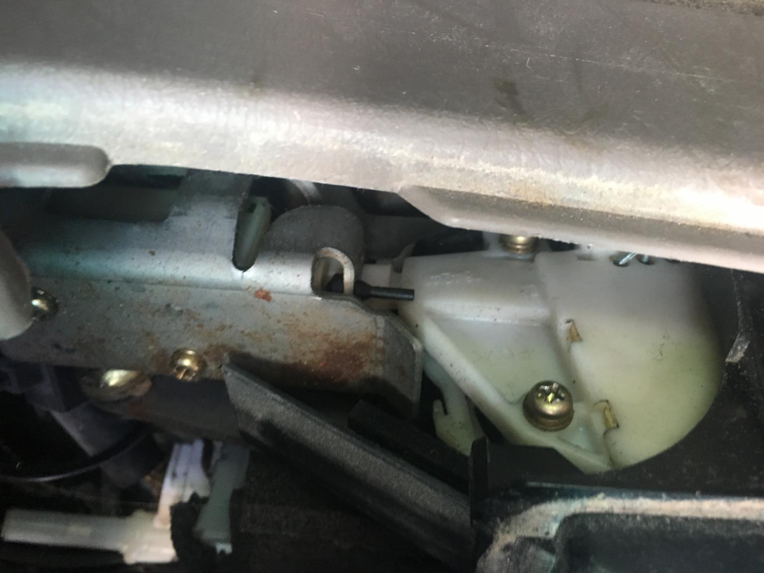

I have the same issue in mine. It's the switch on the shifter itself. It may have a broken or worn piece inside, or it may just need to good greasing. Mine was worn, but greasing it definitely helped. The OEM grease had become tacky and was causing it to stick and wear even harder on it from what I could tell. Access it by removing the shifter bezel. From there, use a phillips head screwdriver to remove the gear indicator. The issue lies in the white assembly on the right side of the shifter. It can be removed by a few phillips head screws as well. I was able to spot the issue once I looked at, and figured out the functionality of it.
Here is a pic of the assembly I'm referring to. Doesn't take but a couple of minutes to remove it.
Of course ... as soon as I take it apart it starts working no problem...
I fiddled with everything and nothing sticks or acts abnormal. :/

Now you see what [MENTION=20809]jsukey[/MENTION] has posted earlier and what you see in youtube video
Just had this issue. If you push the shifter to the right as you slowly put into park and release the button, it should grab if you keep holding it to the right. I ended up replacing my blown out shifter bushings and then using a pipe and a sledge to move the bracket this sensor arm sits on closer to the shifter. Works like a charm now.
If you follow the passenger side of the shifter arm down into the inside, under where the trim is at, youll see a little metal shaft sticking out of the side of the shifter arm. If you actuate the button on the shifter, it should move that little metal shaft up and down. As you put it in park, this little arm grabs a white plastic piece and lifts it up, letting it know it's in P.

I know exactly what you're saying, but everything lines up for me and works as designed. I'm stumped that I can't replicate the issue after taking everything apart.
BTW, I also recently changed out 4 of those shifter bushings. I think I need to to try your hammering fix if it happens again. I think we all would appreciate if you could point out in a picture exact spot to hammer on for re-alignment.
I noticed that my problem has gone away after I lubed that mechanism. I also try to take my time when shifting it back to park from drive. I normally just slap it up in park. I think that's where the wear and tear on those parts really comes into play.
