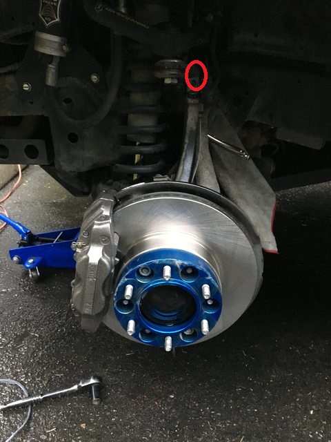

Have you smacked it at the location circled in my picture while having a friend (or your other hand, if you're tricky) apply a LOT of upward pressure on the UCA with a pry bar? I've never had one pop out easily, but I have never been defeated using this method.
Also- if you're replacing the UBJ you can try applying downward pressure on the UCA with a pry bar and smacking UP on the ball joint bolt. I've never had that work, but have seen others do it.

yes I've tried there and the little nub right below it too. I tried hitting upwards on the upper control arm also with pressure.
